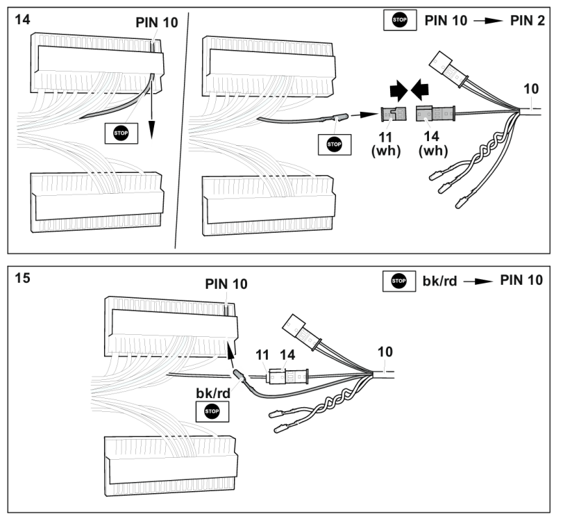

I have installed a dedicated towbar and wiring kit from Westfalia, 317 114 300 113. Link to PDF can be found here: https://www.westfalia-automotive.com/fileadmin/pdf/e_anlagen/317/e317114391101.pdf

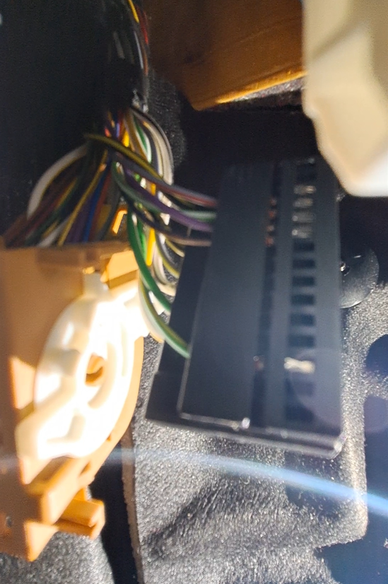

On page 24, it says to unplug pin 10, but there is not a cable to that "port".
Instead, there is a green/yellow cable connected to the port beside it, picture attached.
I thought it might be an error from westfalias side, so I connected the green/yellow wire instead. (I think this is my issue. )

My question is, which cable should I connect to instead? Or do I have other faults? Westfalias instruction does not specify which colors the cable connected to port 10 has, so I am stumped as I do not have a wiring diagram for the car.
