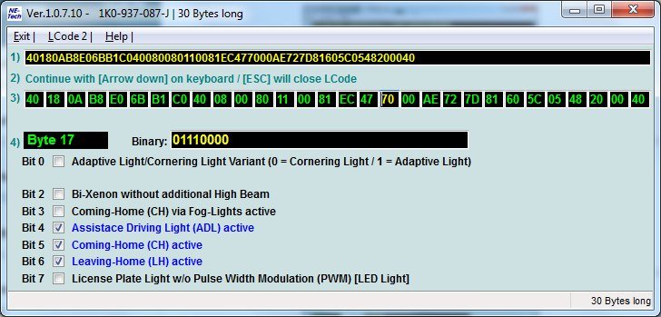

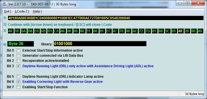

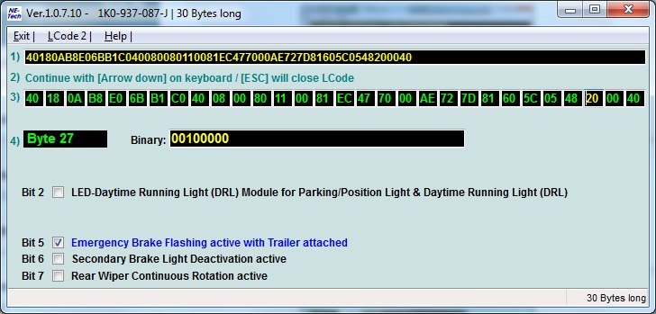

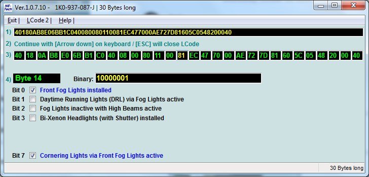

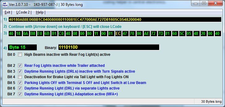

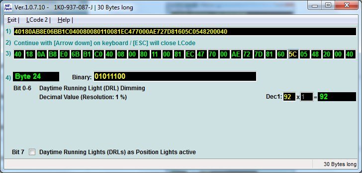

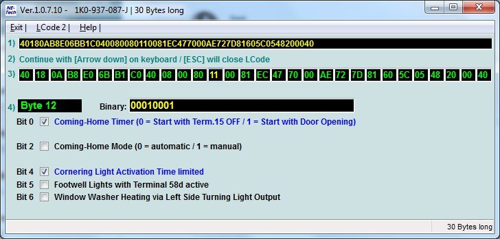

Here is the coding for my car, I have auto headlights and I also have the following settings:
leaving home lights
coming home lights activated by door opening
DRL with dedicated lamps on fog lights
DRL deactivated when indicator active ("wink" feature)
DRL active only when headlight switch in "auto" position
If you don't have auto headlights and you want the DRL to always be on when headlight switch is in "off" position you should only need to tick:
byte 15 bit 6
byte 15 bit 7
Here are screenshots from VCDS from my car (note the extra settings I have enabled, these might not be to your taste)
