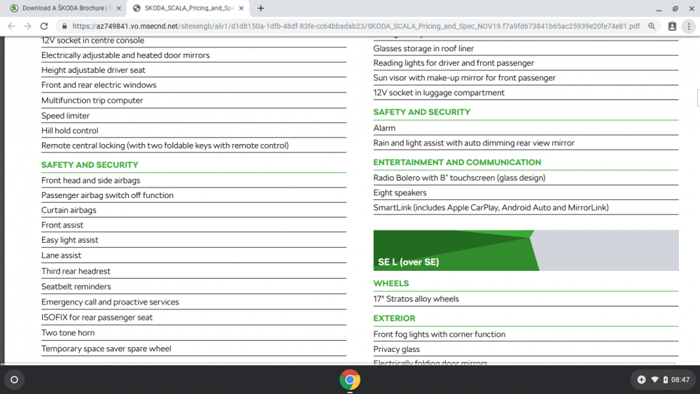

A Spare shows in Standard Equipment in a 'S' in the UK.
So should be there on the SE & SE-L.
http://skoda.co.uk
Edited by Roottootemoot
It looks like all models have a space saver spare. Possibly 125/70R18 ?

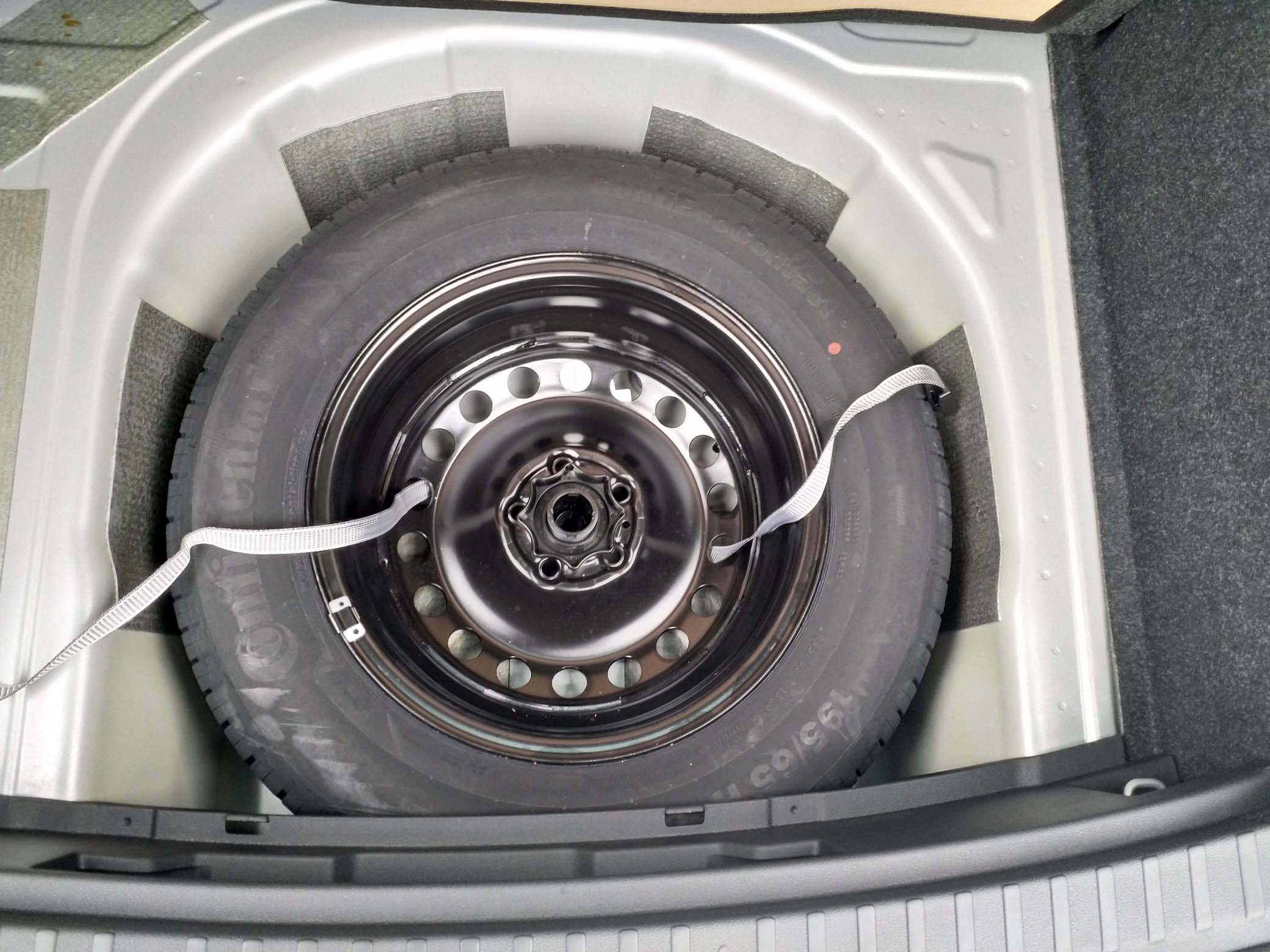

My SE came with a full size spare, not checked the exact spec. Will have a look when it's daylight and not raining. (That doesn't happen very often nowadays)
Edited by ortmazar

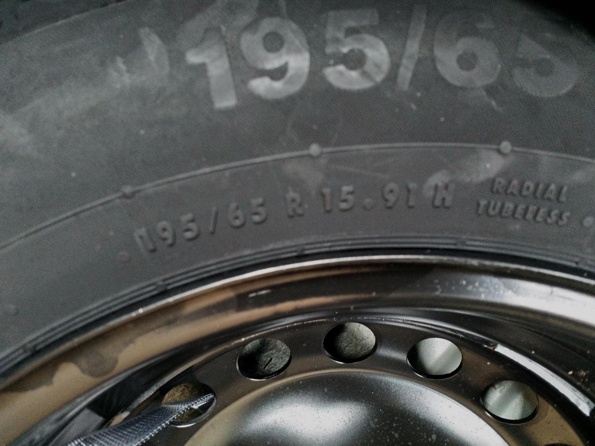

Mine has 195/65 R15  Continental spare.
Has the 195/65R15 spare wheel got the yellow stickers that limits top speed to 50mph?

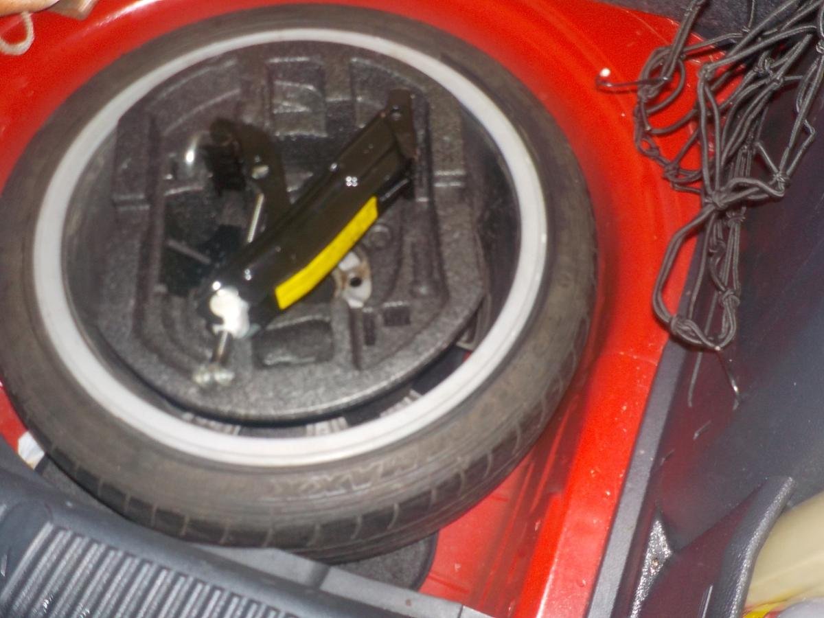

My spare tyre has the 50 mph yellow sticker but it has a 91H speed rating (130mph)  the other tyres are Michelin 205/55 R16 91Vcar-spare.thumb.jpg.c5c7b561ada2580595ab33e306a54826.jpgcar-spare2.thumb.jpg.0f19762ee3230a7c9a7124d820495f5f.jpg
Edited by ortmazar
It is because the spare is a different size you need to drive with more caution. eg not above 50 mph/ 80kph.
