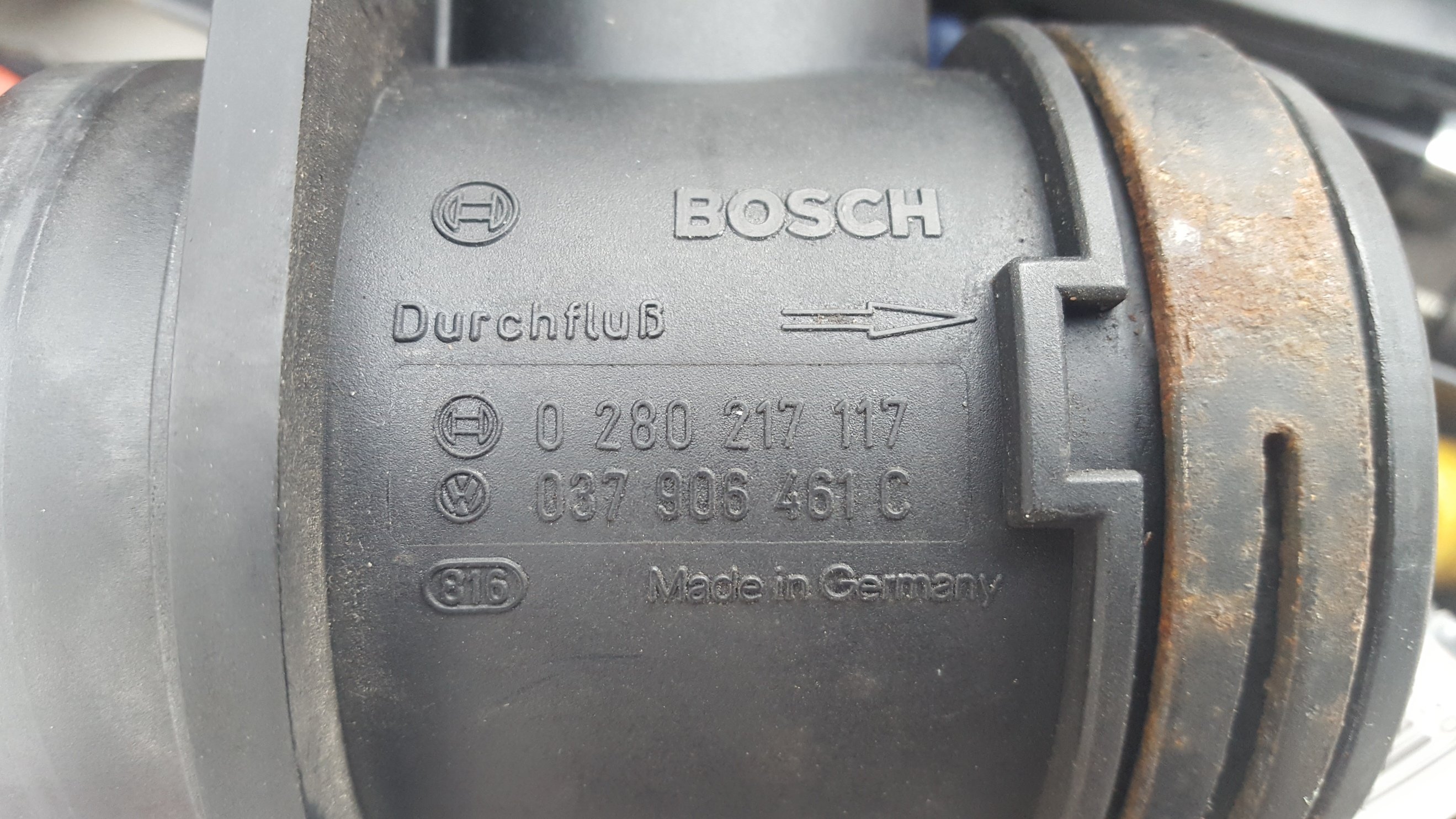

My engine code is AGU which has original part number 037906461c for the MAF.  I took a pic of the original part number last year.
I didn't keep the part, when the aftermarket one seemed to work ok I binned the original 🙄.
The original had a sort of plastic flap in it, my cheapo Chinese one has a what look like a fuse wire.... It does seem to work but perhaps it is sending effed up info to the ECU (not enough to stop it running but enough to cause poor fueling ratios).
The original Bosh part is available on eurocarparts for £230 which is insane price for one wee sensor, is there an aftermarket alternative that will work properly?

The pre-owned OEM MAF from the A4 went straight in with no issues and the car feels more like 'back to its old self': no hesitation or engine stutters and noticably more power at the top end of the rev range. I can't really check the mpg properly now because the flipping thermostat went bad last week too, but I am hoping for an improvement.
I will have to wait for next pay day to do the thermostat then I will recalculate mpg.
