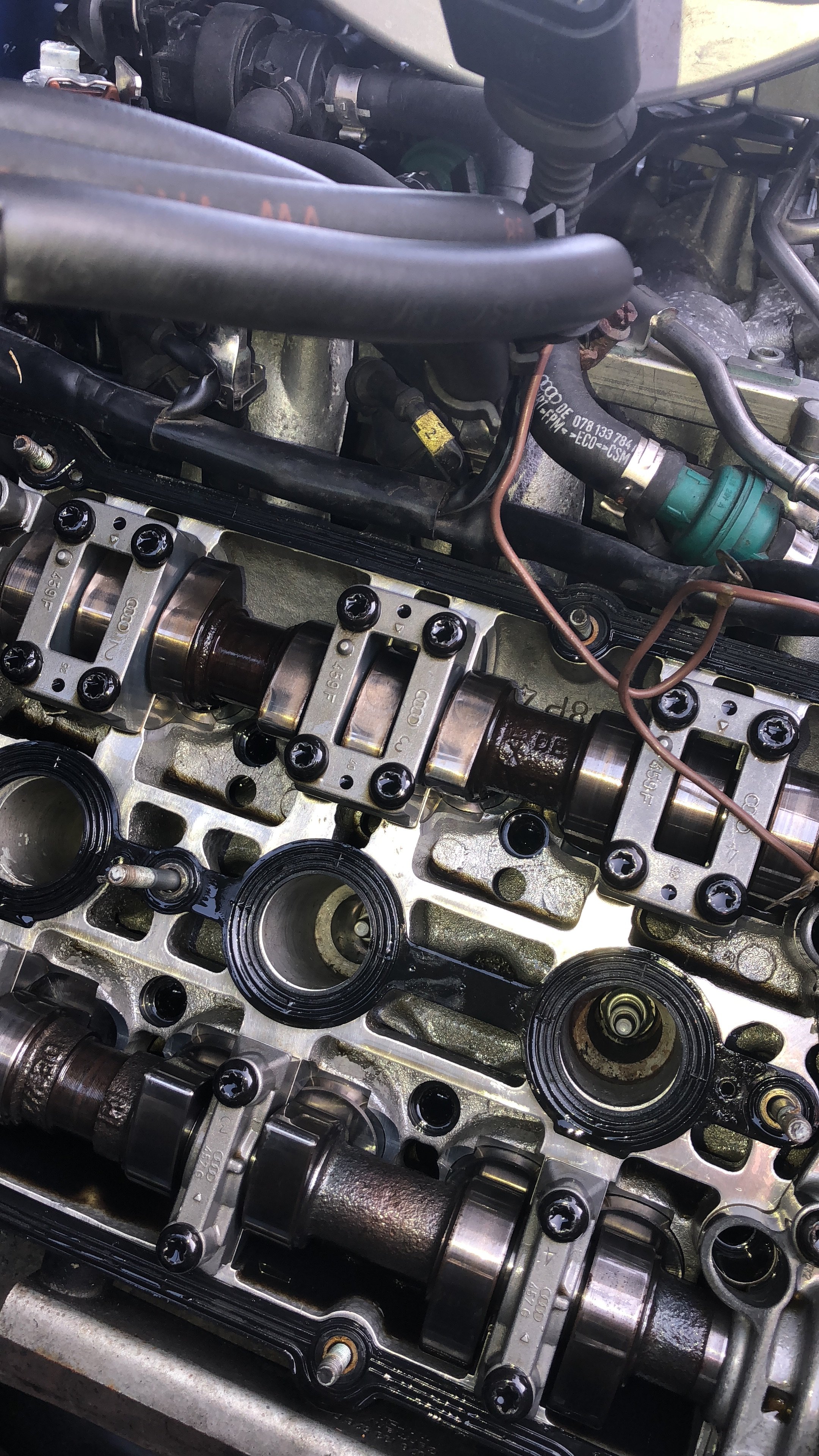

I find shell oil quietens down the engines well and has good cleaning agents keeping the insides nice and sparkly :)
this is said S4 after 2 years of low mileage but heavy usage, so although I have done many miles in it, nearly all of them have been fun ones :)

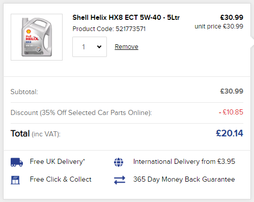

Shell hx8 is currently £20 a 5L bottle from euros with their discount.
Shell HX8 (5W40) is only VW502.00, not VW504.00, so fine for the fixed service interval, but not for variable...
Think I'd pay the extra £4 for the 5W30 VW507.00.
