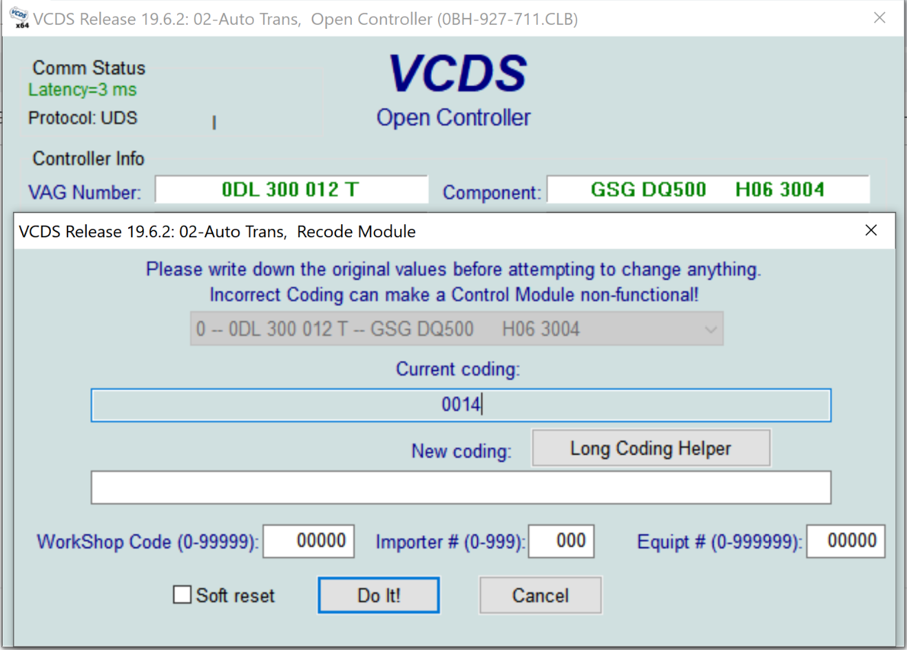

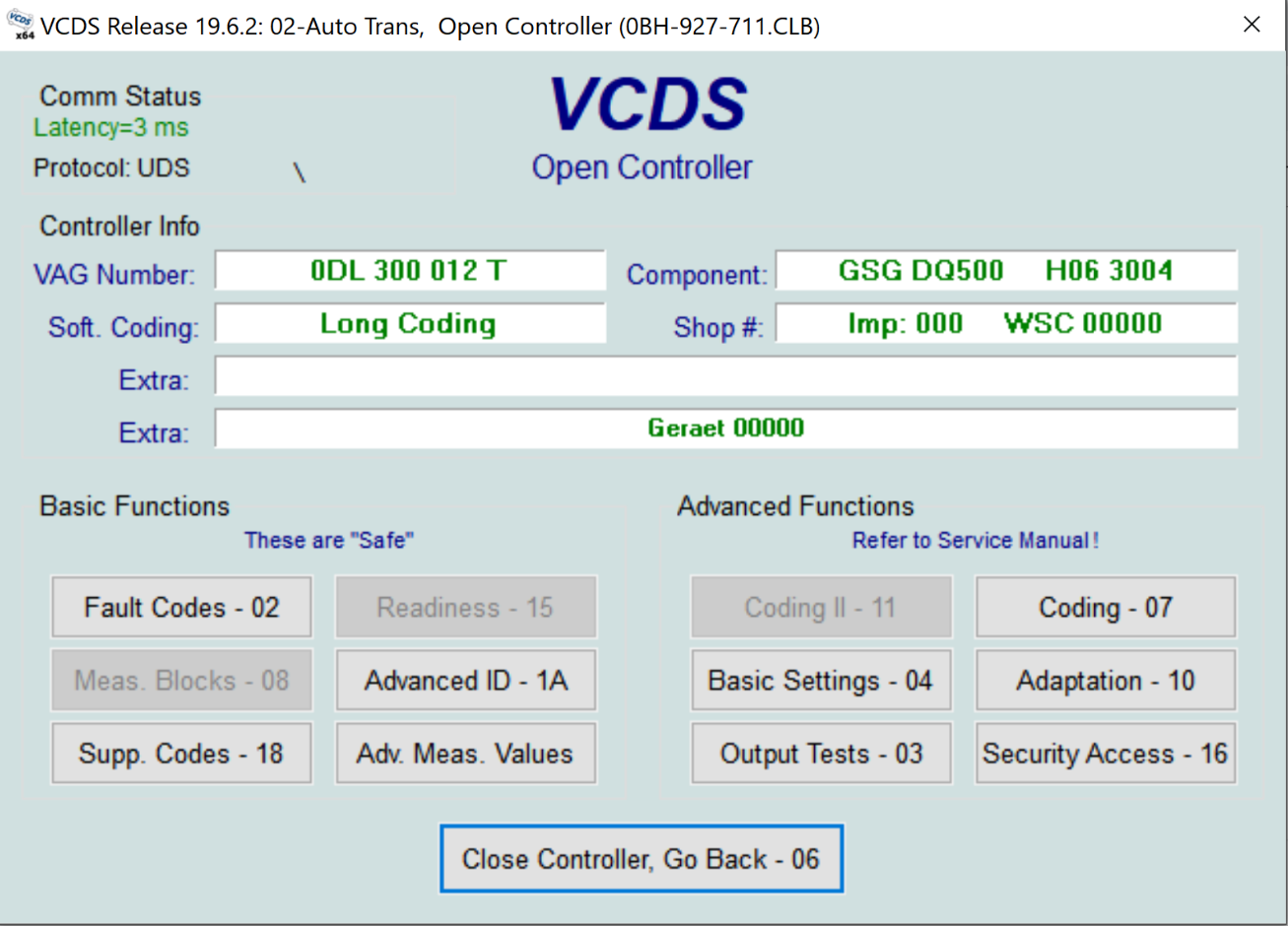

1. Open VCDS and go into module 2 (gearbox).
Take a photo of that screen.
2. Click "Coding - 07"
Take a photo of that screen to.
These are the two images I need to compare to my gearbox.

On my old 190ps TDI with DQ500
@Dogpatch
Address 02: Auto Trans (J743)       Labels:. 0BH-927-711.clb
   Part No SW: 0DL 300 012 T    HW: 0GC 927 711 G
   Component: GSG DQ500     H06 3004
   Revision: 00H06V07
   Coding: 0014
   Shop #: WSC 00000 000 00000
   ASAM Dataset: EV_TCMDQ500021 001001
   ROD: EV_TCMDQ500021_001_VW37.rod
   VCID: 3A2D307D7CD23557C73-806E
