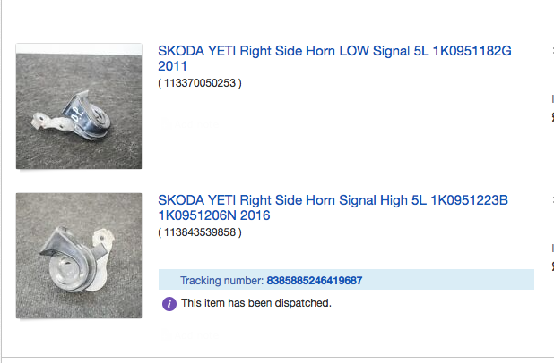

Further to the dual tone horns, I have just bought these.......
