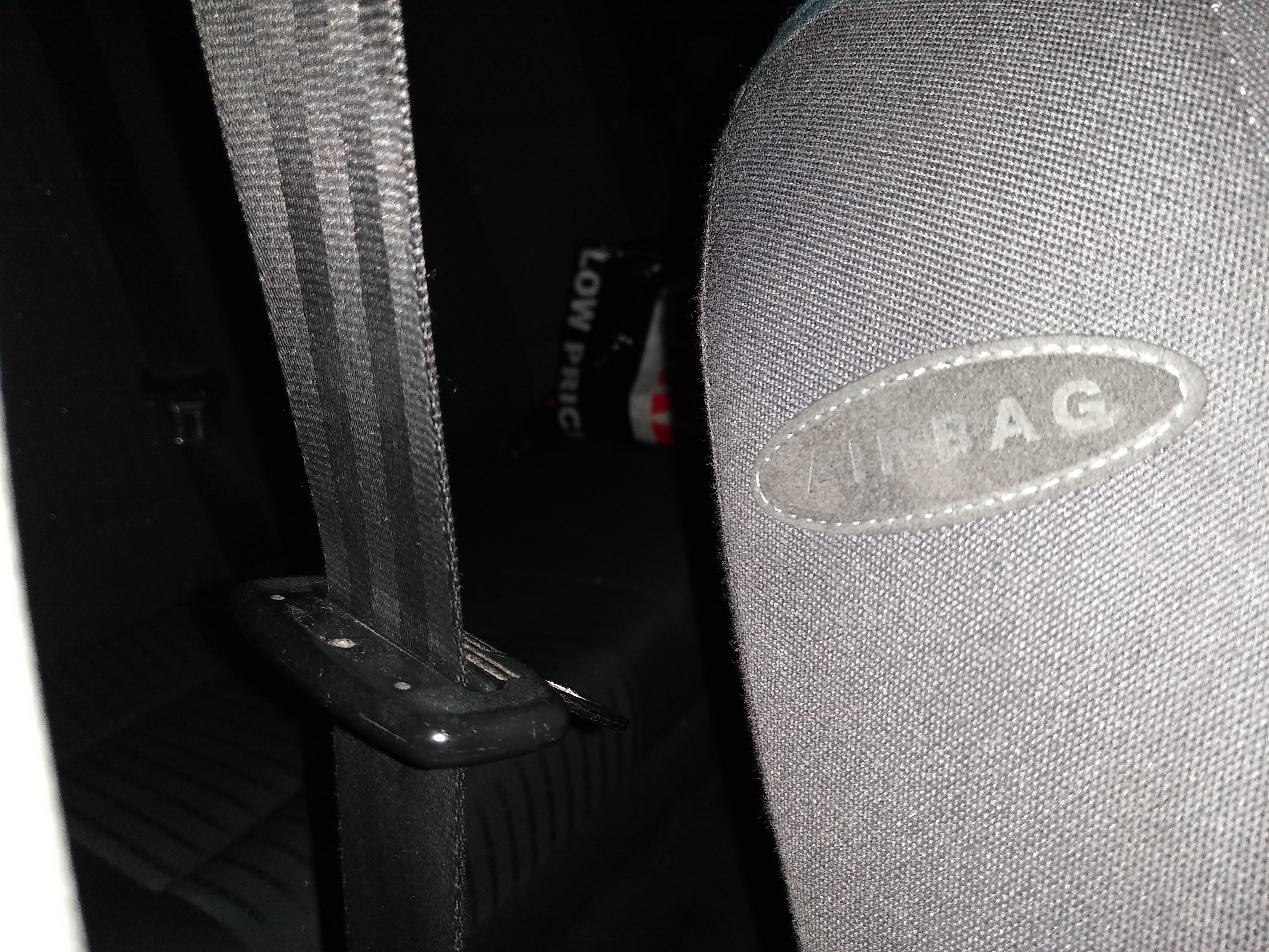

if you look at the front seats on the side of the backrests opposite the seat belts it will have badges that say "Airbag"
If you dont have these it wont matter as you can still replace them with seats with airbags, just not plug them in!!
just checked and i definitely don't have any stickers or labels like that on my seats or headrests. there are airbags in the car alright but i don't think there's any in the seats
I realised today that I had airbags in my seats.
