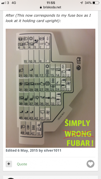

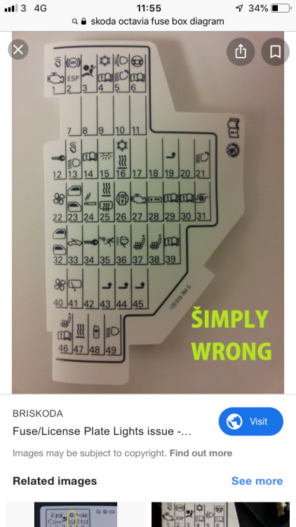

I spent a bit of time last night unplugging and the putting back every relay I could find one by one. No luck, then I spent ages looking through the net and I found a post a guy had made on here about the fuse box diagram being wrong, so I went back to the fuse board and checked all the light fuse based on that post, found a blown fuse, 🤦‍♂️🙈 now all the lights are working correctly.
So that drama is over but now my electric window and door mirrors aren’t working🙈🤦‍♂️. Don’t know if I’ve not put a relay back correctly. I’ll have to go and take the dashboard to bits again and check. The only other thing I did was change the glass on the drivers side mirror, would putting the terminals for the heated mirrors on the wrong way round stop the mirrors and windows from working? I’ve checked all the fuses this time, they seem ok. OMG I hope this is a quicker/easier fix to find than the lights
Post I found on here
Ah yes the good old reverse fuse layout.

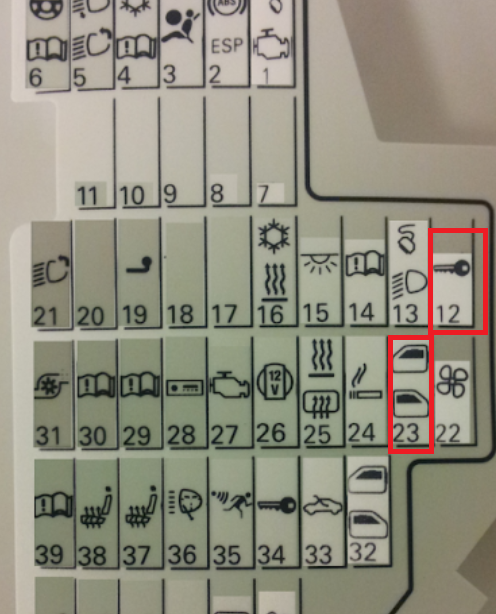

Check that there is an intact 10 amp fuse in position 12 and a 30 amp one in position 23
Measure the fuse with a multimeter for continuity as well or replace with new anyway...

I’ll only have to worry about the fronts, but I assume you were testing/messing around with fuses 23 and 32 from the last picture posted?
Thanks for the reply
Yes, fuse 23 and 32 was the ones I removed. Have you tried looking at the wiring that passes from car to door for breaks or chaffed insulation.
