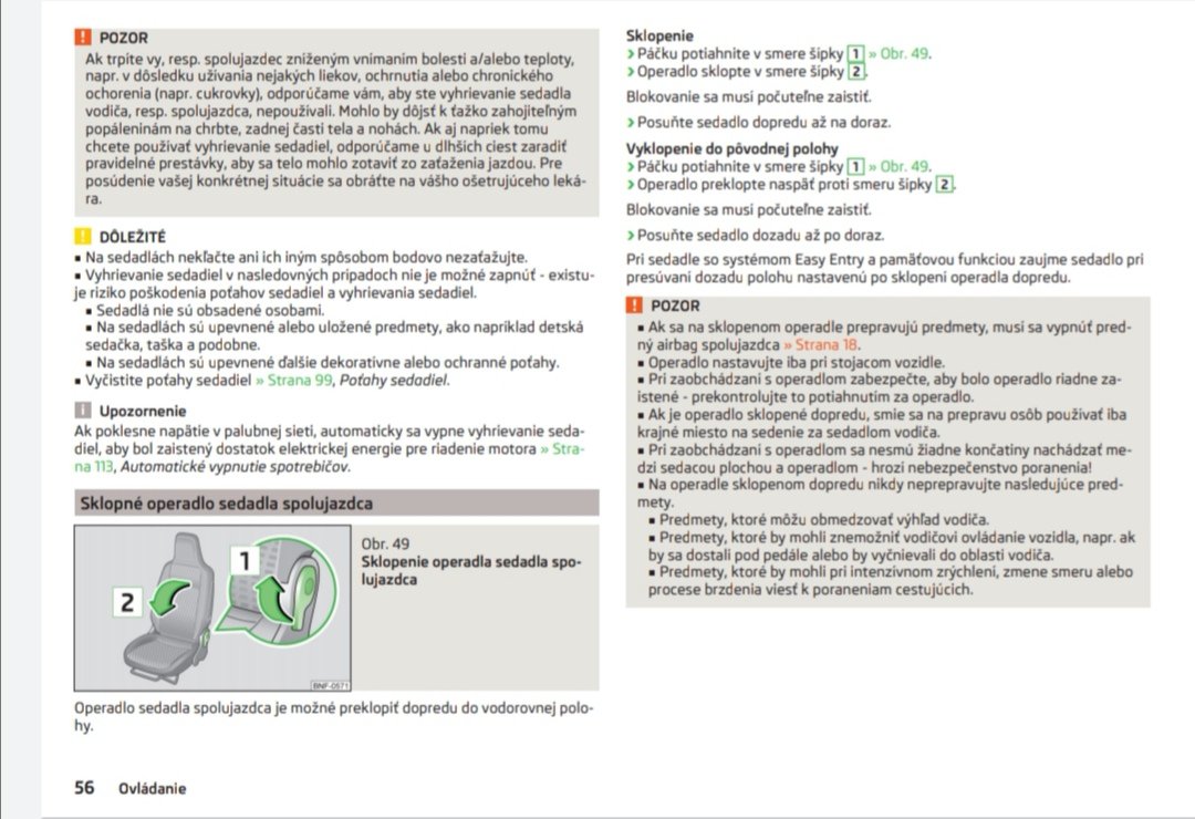

I also found this information in a Slovak manual which describes folding the seat forward.
I've loosely translated to:
Folding passenger seat backrest
 Fig.  49
 Folding down the seatback
 lujazdca
 Passenger seat backrest can be folded forward into a horizontal half
 hy.
 Tilting
 ›Pull the lever in the direction of the arrow 1» Fig.  49th
 ›Fold the backrest in the direction of the arrow 2.
 The blocking must audibly engage.
 ›Push the seat forward as far as it will go.
 Swing back to original position
 ›Tilt the backrest against the direction of the arrow 2.
 ›Move the seat back as far as it will go.
 With a seat with Easy Entry system and memory function, the seat occupies the seat with
 moving backward the position set when the backrest is folded forward.
 WARNING
 ■ If objects are transported on the folded backrest, the pre-
 passenger airbag »page 18.
 ■ Only adjust the backrest when the vehicle is stationary.
 ■ When handling the backrest, ensure that the backrest is properly closed
 clean - check this by pulling on the backrest.
 ■ If the backrest is folded forward, it may only be used for transporting persons
 extreme seating position behind the driver's seat.
 ■ When operating the backrest, there must be no limbs located between the legs.
 d with seat and backrest - risk of injury!
 ■ Never carry the following pre-
 methyl.
 ■ Objects that may restrict the driver's view.
 ■ Objects that could prevent the driver from operating the vehicle, eg.  if
 would come under the pedals or protrude into the driver's area.
 ■ Objects that could change direction or with intensive acceleration
 braking process can lead to injury to passengers.
I haven't been able to find any more information thus far, but pretty confident it would've been an optional extra and not retrofittable in the UK (as it would be in place of the drivers seat in the UK)
Thanks for that David. Being I purchased the car in fantastic condition, I don't think the original owner would have removed that notice on the back of the seat. What has been very useful investigating this though, is knowing that there are cars with these features to look out for in purchasing future cars.
