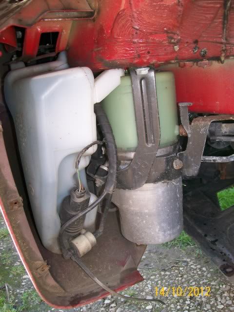

On ours there's a tyrap around one of the two hose feeds just where it comes out of the pump, not sure whether it's going to the front or rear washer.  Looks like a quick and dirty fix for a leak, that has stood the test of time over the last 7 years!
Looking for the photo, but it's taking time...see below.

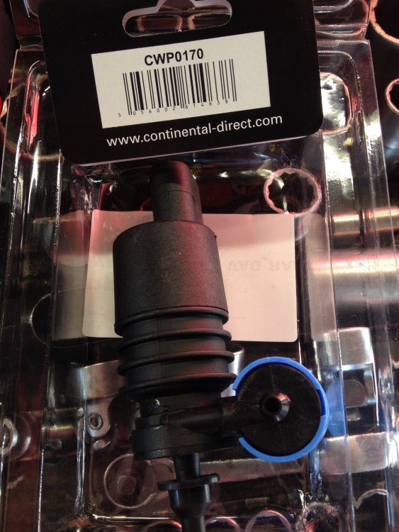

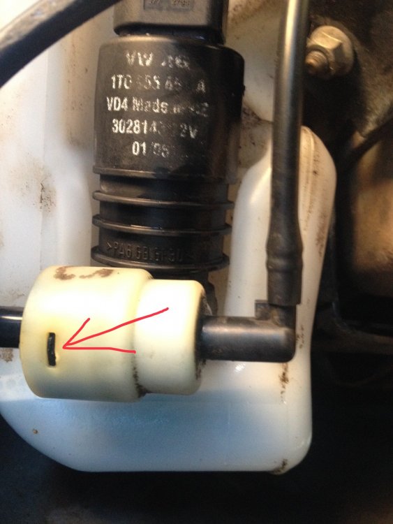

OK,an update,it was leaking from the slot on the pump that is marked with the red arrow.Rang the local Sutton Autospares and they quoted me £13 inc vat. 3 in stock at my local branch about 3mls away.Fitted and works great, you even get a new seal for the washer reservoir.Result,and I bet its cheaper than OEM.
