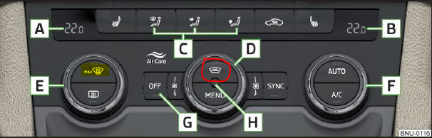

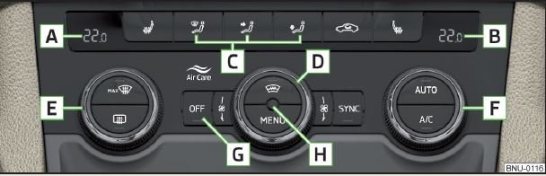

This sounds so condescending and it's not meant to be, but when you say the lights are on - you're defo using the correct buttons? Is the engine running when you use them?
The top button on D is the front screen, the lower button on E the rear.
Just thinking aloud...   I believe both windows have timers, i.e. they auto switch off after a set period ( 10mins? ). I wonder if it's somthing to do with the timer? Perhaps it's switching off too soon.

Yes Scot, both lights on and engine running. Not going to take it back to dealership and wait hours. I suspect they'll just say the same thing. It is really the worst hrw I've ever encountered. The front windscreen does not have an element, it just puts the blowers on full blast.
The heating in rear window started to work this week. In any case, I'll address the issue to dealer on Jan or Feb when I'll have to do the service.
Ah, so you don't actually have the heated front screen?
If you don't have the icon circled in red then you don't have the heated windscreen...
The button highlight in yellow, as you mentioned, only directs air to the windscreen and increase the speed of the fan. If the engine is cold then all it will do is blow cold air onto the windscreen.
Some other Skoda models use small ceramic elements in the air vents at the base of the windscreen to warm the air before it reaches the screen.
