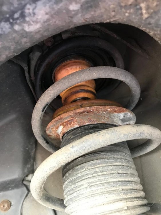

issue 1 - top suspension mount has lower section missing. Apparently obvious which part is missing when you compare both sides. Firstly is it possible to see the mount easily to compare? Secondly how long would it take to install a whole new one? (Garage has suggested I try the local Skoda dealer to see if we can get the part of it required rather than a whole one.)
issue 2 - coil spring mounted upside down. Not impressed with this given it was the same garage that installed some rubbish brakes on my car last year.

1. Just replace the whole top mount, it all has to come off anyway.
2. Turn the spring right way up while replacing top mount.

It'll be the bearing that's fallen out due to the spring being upside down, item 2 here:
https://skoda.7zap.com/en/cz/fabia/fab/2004-225/4/411-411011/
The absence of that will have damaged the top mount itself (item 4), I should think, as the bearing is the seat for the top of the spring (normally!).
No wonder it was noisy.

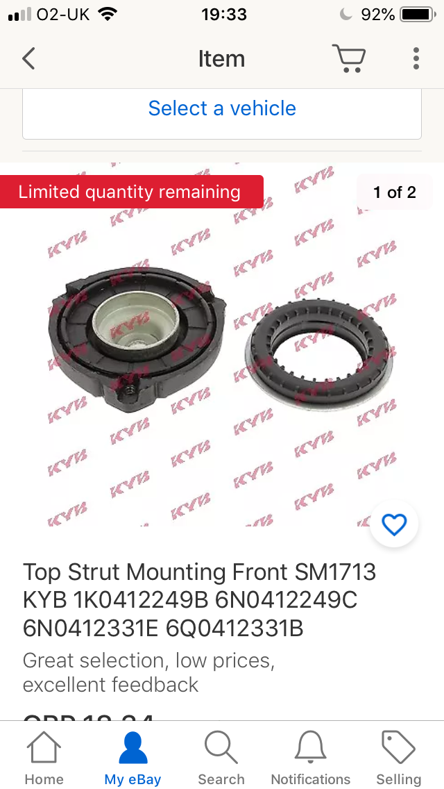

for top mount, will an el cheapo from eBay be ok (like the one in the attached photo), or just get one from the main dealer.
Yep, it'll be fine.  I wouldn't bother doing any of the other things, they may not be necessary to cure the noise.
If you're selling it just get the top mount done, this will get rid of the rattling.

Didn't think it was possible to install a front spring upside-down as I thought they were the same at each end. I might be wrong though as it's a while since I did mine.
Even if it’s not upside down the missing strut parts won’t help!
Maybe it's snapped at the top and the bearing fell down.

I'm slightly sure the pigtail that's meant to be at the top is smaller diameter than the one that's meant to be at the bottom. Don't have a spare to measure just now.
Yes, could be. Memory is foggy since I did mine.
I know this can happen if they snap...
I should hope not given it was new 13 months ago!
 The actual angles of the coils are different at each end as lower end sits on a ramp built into strut pad. How do I know - been there, done that, spotted before re-installing strut.
