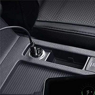

Why bother when you can buy low profile / flush fitting adaptors for a few quid off Amazon?
432693129_aukey-cargador-tecnologa-aipower-adaptador_puquscom_51vuCzWnaLL_400.jpg.3682a32496d3381d0e694bee5e380798.jpg

I do have a adapter, or several I should say. But I believe there are something wrong with the outlet as the adapters keeps poping out.
Therefor I purchased two usb outlets to switch with.

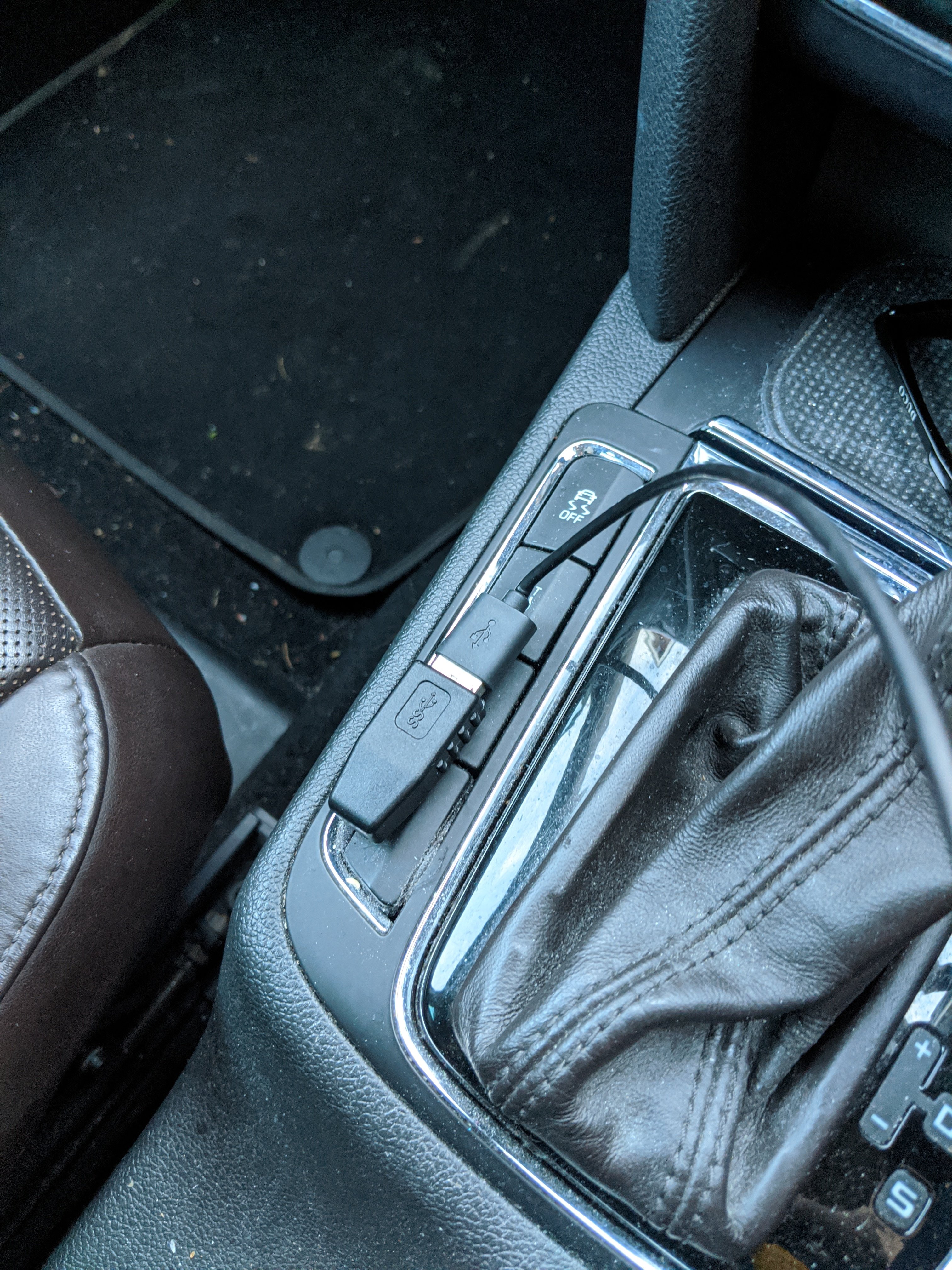

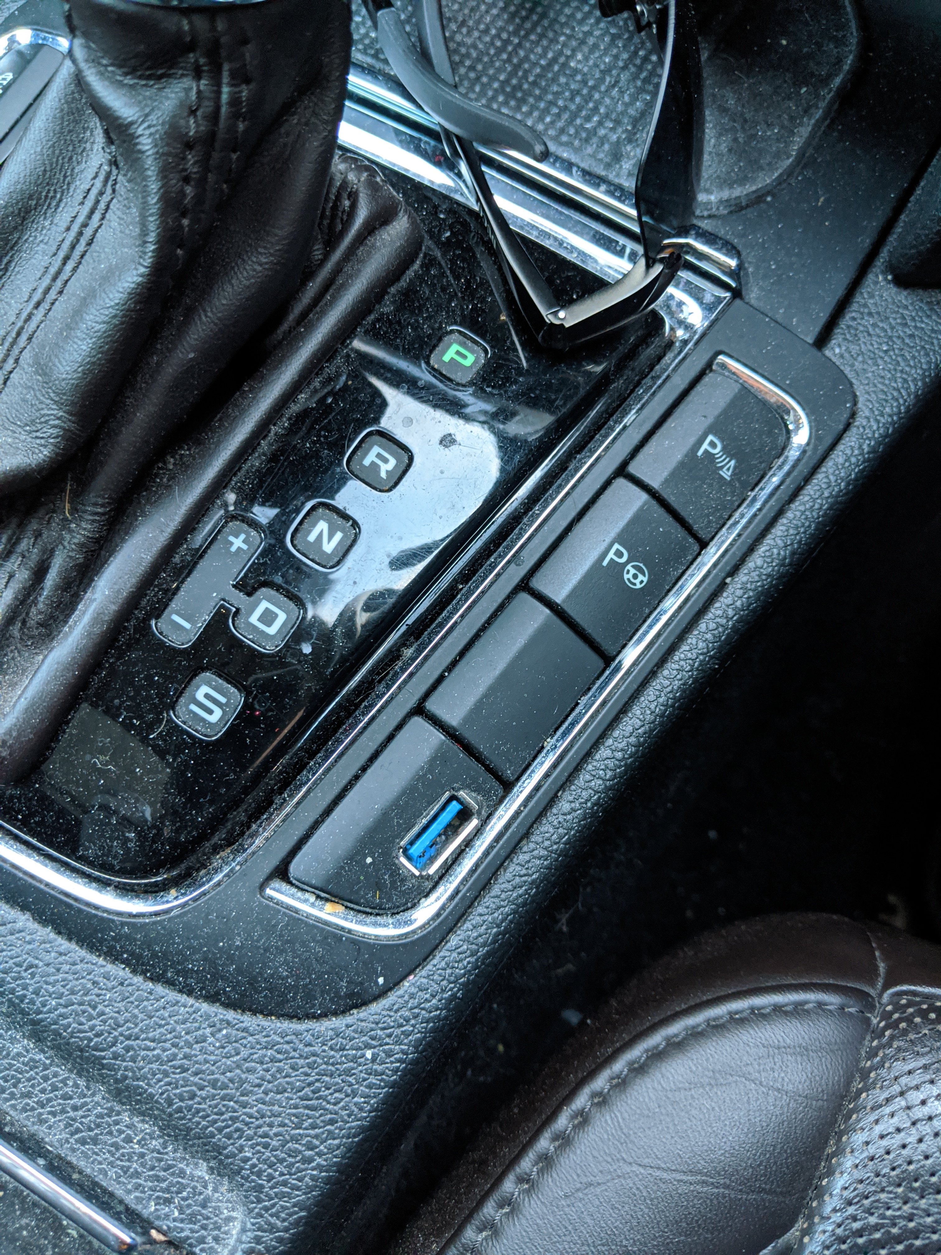

I fitted some to the blanks either side of the gear stick. One each side and connected to another hidden lighter socket and usb charger.
Got some pics?
30 minutes ago, Swedzilla said:
Got some pics?
Excuse the dust! I'll get some more later
I like it! Thanks for showing

It's really easy to do. You can cut the plastic with a sharp craft knife. I used a pair of side cutters to remove the internal ribs.
I used sugaroo to hold the usb connector in the housing. I did that 3 years ago and used everyday

Nope. The carpet bits of the side of the console pop off. You can then pop the blanks out from underneath. I cable tied the cigarette lighter adapter and and usb charger to a plastic support behind the carpet section.
I made it all up out of the car and then popped out in
