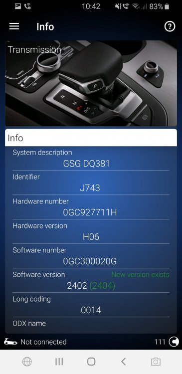

If you can get someone with OBD11 to do a scan get them to check the transmission software.
I did a scan of my car and it seems that there's new software available for DSG transmission, so it might well be available for your car as well, which may help you to get a much smoother gearshift.

This is what I get on OBD11.
