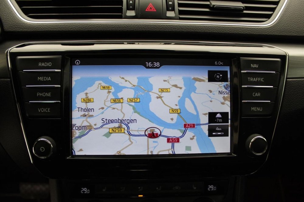

So the picture above is my Head Unit, any chance of finding out if I have an ‘MIB1 or MIB2’? I’d like to move to the new 9.2” no-pushy-buttons version.
Maybe, and just maybe I can save the extremely expensive kit, and just go for the screen, but I hope you guys will be able to help me out here.

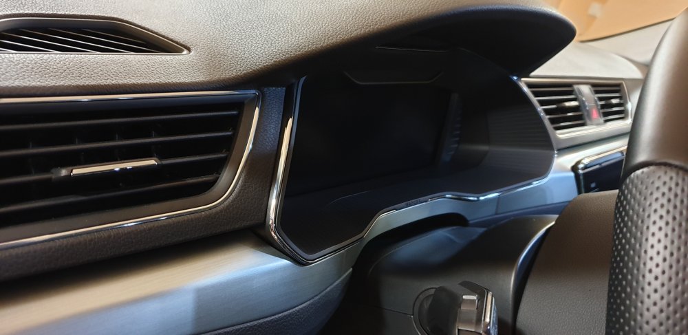

Secondly I’m also leaning towards installing a Virtual cockpit (like the AID in my VW) as I’ve really grown custom to it, and like the options.
Hoping any of you can help me sort things out, and maybe even save me some cash before I go all in on the MMIB2.5 and the 9,2”screen!

Ask this user - pab567 - about 1000 GBP and You all done. I've asked him for swap last time.
Thanks, just posted to him, let’s wait and see if he’s able to help out!
Radio unit is a MIB2 Columbus. Pab567 is deffo the person to talk to about upgrading that to MIB2.5 spec. I am running a MIB2.5 Columbus from him and it’s great. I also retrofitted VC into my Octavia and it’s not without it’s challenges, not for the faint hearted and needs lots of ODIS-E coding but the challenge is finding a Superb dash. 3V0920790A. Good luck.

So my next question is.... ODIS-E coding.... Sounds like a challenge? Something I can do myself with the Ross-Tech cable or is this VAG stuff only?
(Sadly the Superb Dash is incredibly rare and.... Expensive....)

Wrt the screen, would that be the 3V0919606D?
ODIS-E requires connection to VAG servers, VC coding requires keys, mileage, immo, ABS and steering angle sensor coding with ODIS and the rest with VCDS, VCDS can’t do everything. The Superb dash is very hard to come by sadly. 9.2 inch screen is 3V0919606D :)

I’m having issues finding proper stock of the Virtual cockpit for the Superb. It seems to me the unit from the O3 might have exactly the same display , with an alternative/different surrounding cover (which I might source directly from Skoda?) and replace it?
5E0920790 Seems to be the O3 virtual cockpit part number, which is broadly available for normal prices.

There’s more to it than that unfortunately, you will need the 3V0920790A unit.
