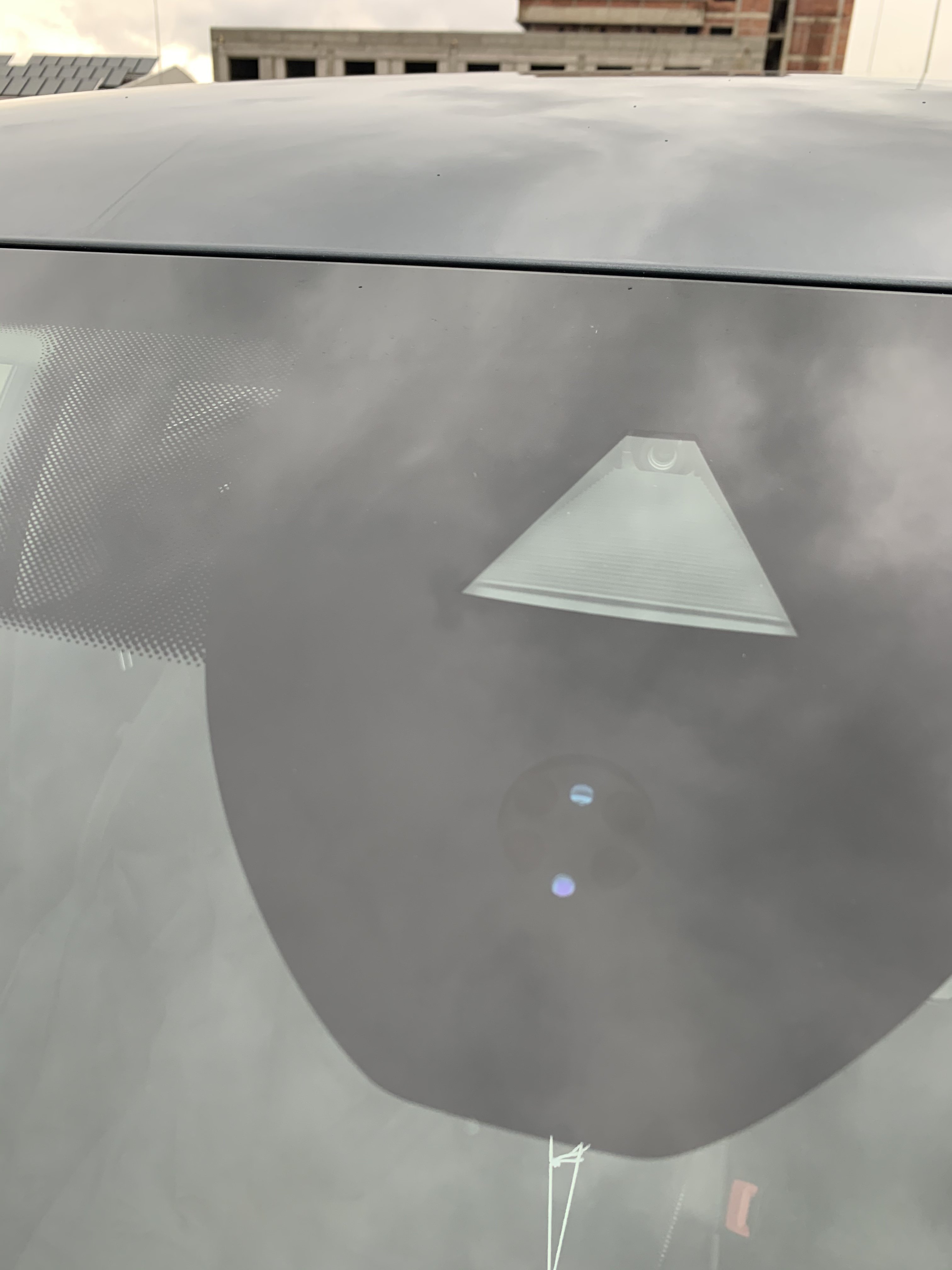

Hello Davor,
i dont know if i have A5 Cam but i have some pictures i will upload if you could figer out, how do you suggest that we can arrange the coding.
Yes , that is that camera ...  contact me in private message and we ll figure out ... Thank you

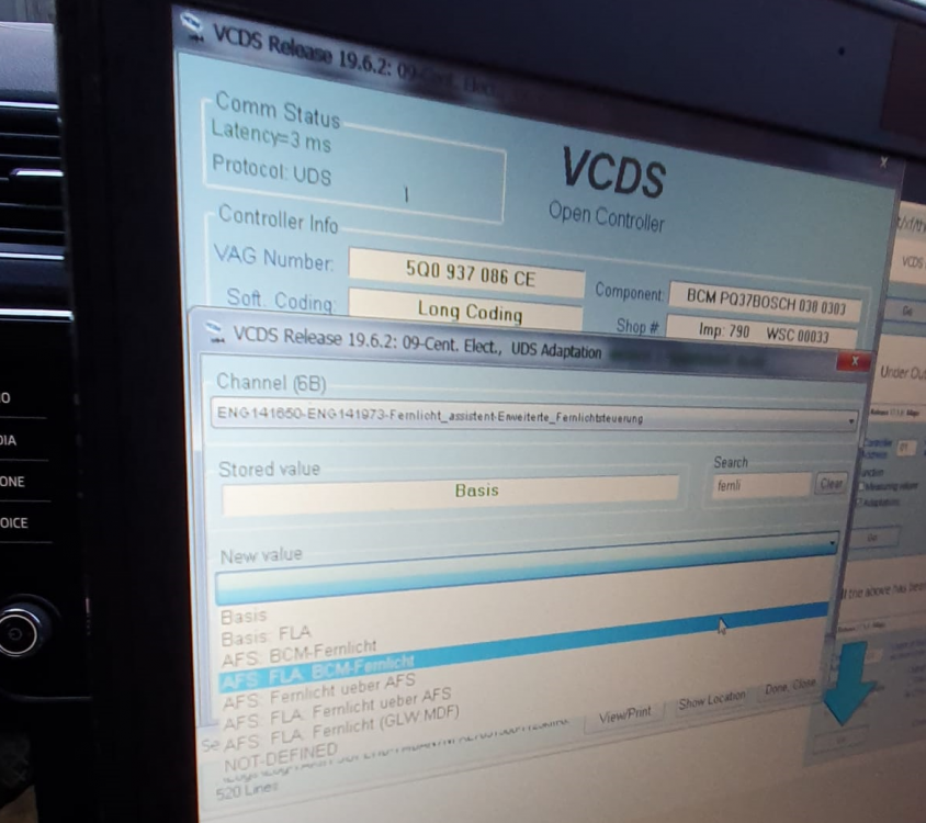

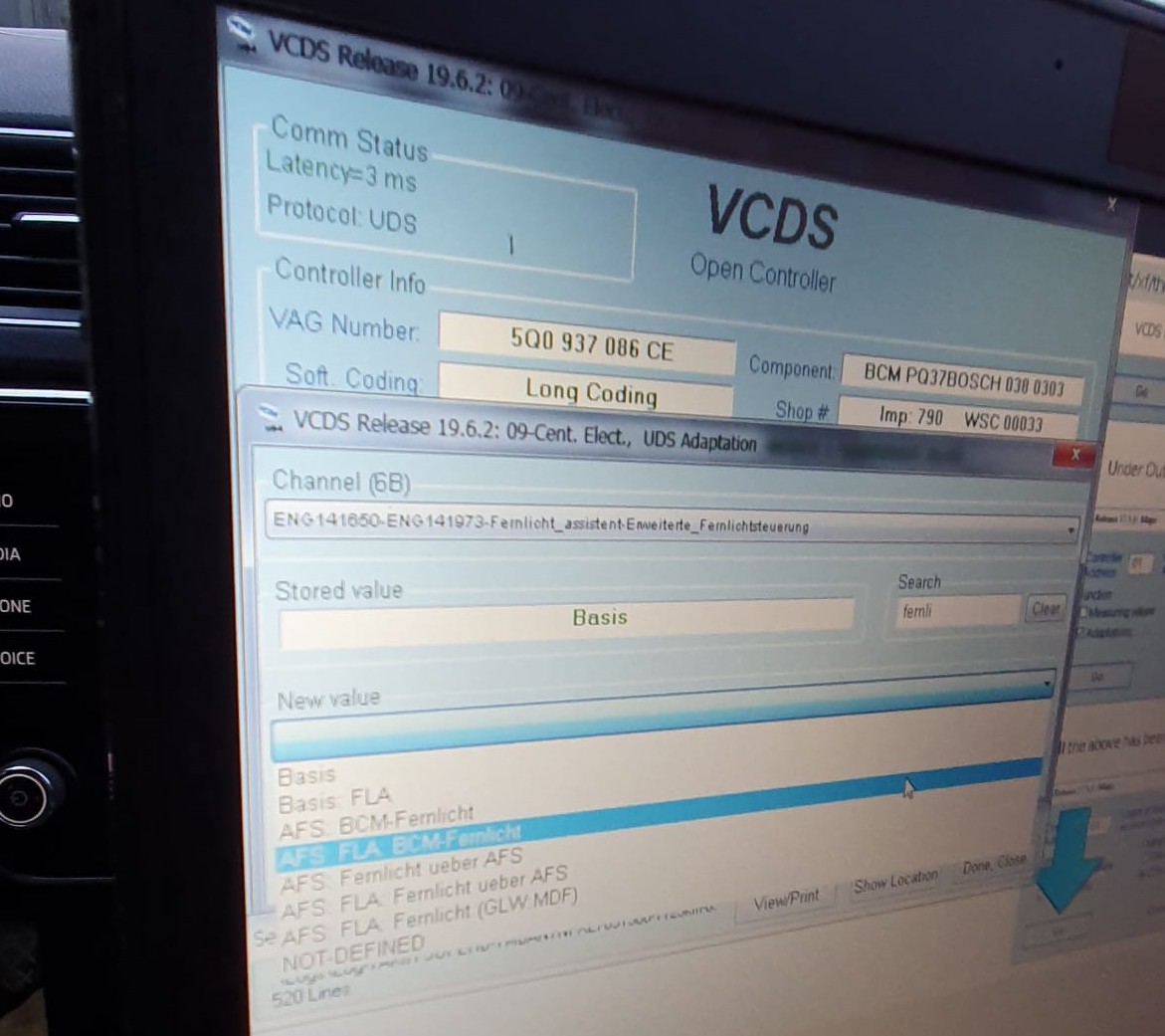

Hello everyone,👋
I have a Skoda Superb 2020 with the new facelift,
I'm trying to Activate high beam assistant,
But the instructions don't fit the 2020 version:
Here are the instructions:
Enable high beam assistant (with installed STG A5
Control unit: 09 , Access authorization: 31347
Adaptation:
Fernlicht_assistent-Menuesteuerung Fernlichtassistent Werkseinstellung
set to: present
set to: present
Fernlicht_assistent-Erweiterte_Fernlichtsteuerung
If the initial value here is:
"AFS, Fernlicht ueber AFS"
set to:
"AFS, FLA, Fernlicht ueber AFS"
or
"AFS, BCM-Fernlicht"
set to:
"AFS, FLA, BCM-Fernlicht"
Control unit: A5
Long coding
"AFS_coding_Light_Assist" should read "High_Beaml_Assist"
Activate byte 21 - bit 5-7
(Change to: (20) Fernlichtassistent/High Beam Assist)
These instructions do not fit with the new facelift version.
the First thing is in this channel should have been:
or
Instead the value that appears is:
"Basis"
the second Change is in the long coding this should have been:
Control unit: A5
Long coding
But I found it on:
byte 15 - bit 5-7
Thanks in advance.
Put Basis FLA  and   put in byte 15 on bit  5-7  20 High beam asist, try like that and inform me ...
I tried it didn't work
I'm currently going to try the following options:
"AFS, FLA, Fernlicht (GLW,MDF)"
In addition to that I also tried to dissable start/stop function (12.1v) It worked two days and then returned to being active,
Does anyone have a solution?

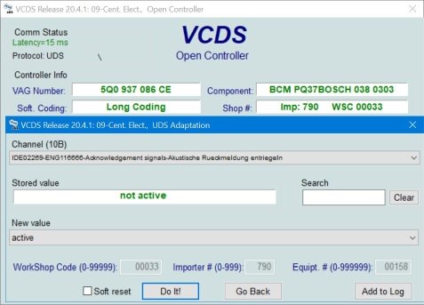

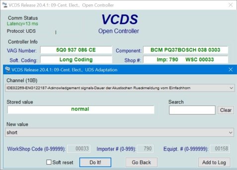

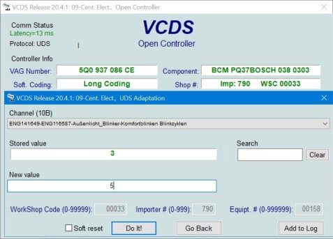

After buying a Skoda SuperB Facelift MY 2020 quite new, I found myself looking for VCDS coding.
This research brought me to this valuable forum.
I'd like to contribute this community as much as I can. I already made a list of adaptation that I want to do and can write here the ones I succeeded.
But before coming to that, I have a problem which I believe somebody can help.
I have a VCDS clone 19.6.1 and I'm not able to enter adaptations for 09-cent. elect.
I checked out the scan and there's a line:
No ASAM data for: "EV_BodyContrModul1UDSBosc" (SK48)
What could be the problem?
Thanks in advance.
Looks like you answered your own question 🙄
Message received.
Today I tried with my friend's genuine VCDS 20.4.1 and now I'm able to enter adaptations for 09-Cent. Elect.
Now I have 2 problems.
1. BCM (Address 09: Cent. Elect.) has a coding full of zeros. How can it be possible?
