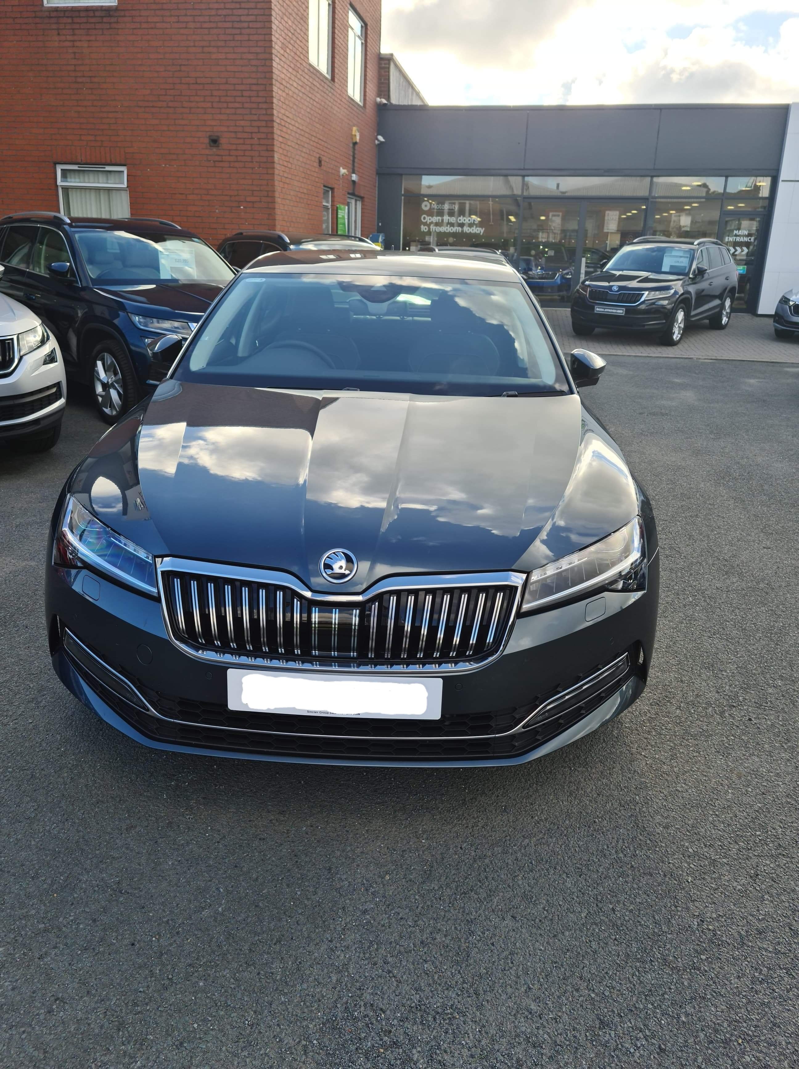

Thanks, not the best picture from my side, but I'm 99% certain I have the highline camera.
My rear view mirror definitely doesn't look like the lowline one above.
