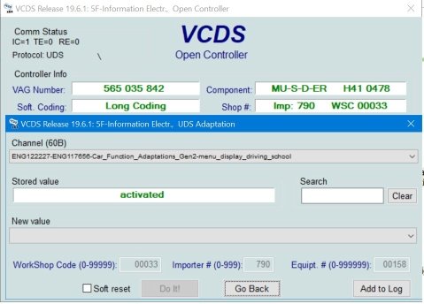

Driving School :: working

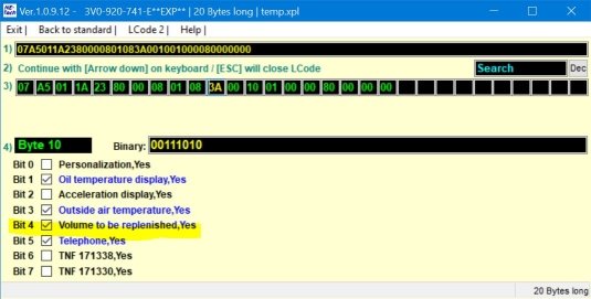

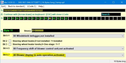

Blower display in auto operation :: working
Volume to be replenished in instrument cluster :: working

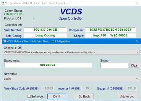

Acknowledgement warning (via horn) during lock / unlock :: working
Below is for unlocking acknowledgement:
Below is for locking acknowledgement:
