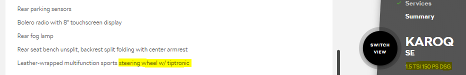

Specs say the should on all models, however mine supplied back in October didn't have them installed. Mine is the 1.5 petrol 2wd Sportline variant. Model in dealers was exactly the same despite it clearly being supposed to. Dealers are still in discussion with Skoda Head Office

OK, so that has confirmed that 4x4 Karoqs have a wet clutch (presumably 6 speed?) ... but I haven't had it confirmed that I would have to get a 2 litre diesel to get the same wet DSG.
There is the 2.0 TSI (190 ps Petrol) DSG 4x4 as well.
Then there is the 1.5 TSI DSG 4x4 which does not have a DQ200.
When there are 1.4 TSI Hybrid Karoq eventually they will not use a DQ200 DSG.
The DQ381 is 7-speed wet clutch, but I doubt you get it with any 2x4 Karoq version.
