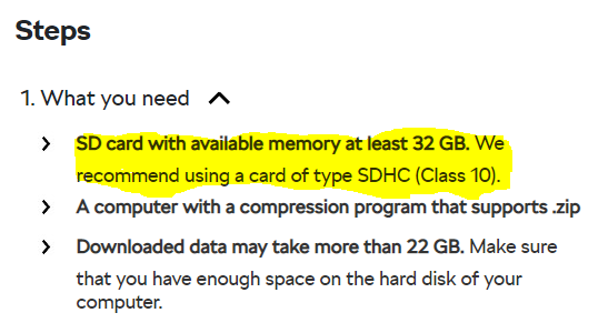

No one has answered my earlier question, when you enter your VIN into the Skoda portal, what does the guide tell you with regards to compatible SD cards?

Do we actually know, categorically, that the Amundsen requires the Skoda supplied SD card?
Yes, the Amundsen requires a genuine Skoda SD card.
I confirm that Amudsen requires the genuine SD card. I tried high quality 32Gb SD card and it did not work. However, it is very easy to download the files from the portal and replace them on the genuine 16 Gb card. As Kenny suggested, it is also possible to get them from VW portal, they are even more recent and work very well. Nowadays, it is still possible to load all the European countries on the 16 Gb card but I suspect that in the future, you will to choose the group of countries you want since the database is ever growing.
