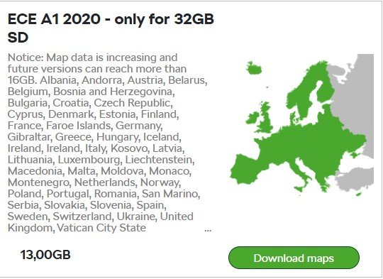

Would my car have the 32GB card?  If so do I download ECE A1 2020?

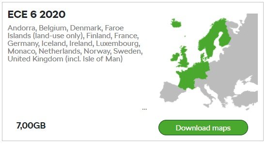

(the intention is to download the ECE 6 2020 update  7,00GB  as I will not be driving on the Euro. continent)

I followed steps 1 to 4 above  - upon undertaking to transfer the unzipped, decompressed, folders to the formatted fat32 Skoda Sd Card  I had a dialog box stating that these two folders were to large to be installed on the 32gig sd card.
  apparently the 2020 update is Larger =  (see attached file 1)
So I then downloaded the smaller  7gig  Map  =  (see attached file 2)  and followed the same procedure as above,  this transferred to the re formatted Skoda sd card with no problems.

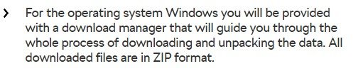

On the Download Portal it refers to a "Windows Manager" Installer (see attached file 3)  that is downloaded with the updates, - I found no evidence of this being downloaded. or can i find any way of downloading this Manager from any alternative source.
Has anyone found this skoda Map Update "Windows Download Manager"??

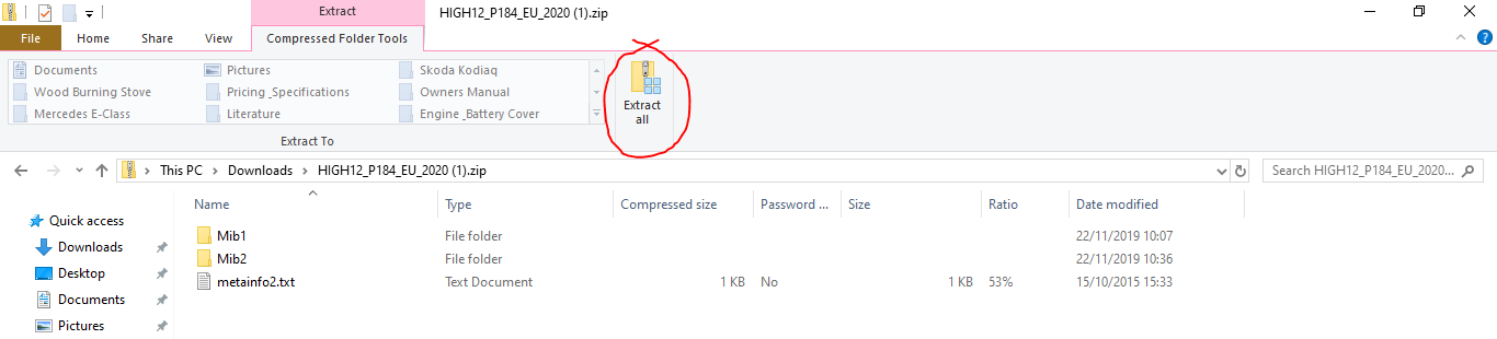

When you open the downloaded file, do you not see this?
I did yes - but the "Extract all" was greyed out and not "clickable" (sorry I'm not very computer savvy) Perhaps my WinZip works a little differently its a nearly new Version 24 I think.

It's OK, not many of us are these day, I certainly cannot keep up with the advances in computer technology, but we'll get there!
Whilst the files were downloading, did you get this little box in the bottom left of the screen showing the download progress?
When mine finally downloaded I clicked on the box and it revealed the screengrab I posted earlier showing the 'Extract all' button.
Could it be that the files didn't download properly / fully.
