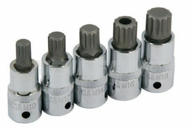

If I was a betting man I'd say the bolts will be similar to those used on brake caliper carriers.
Mine look like this and  are from a company called Bergen...

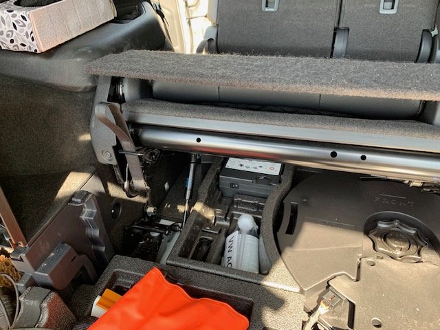

Do you have some pictures how far the gas struts lift the seats in maximum position? I have got mine to this position - owners manual pictures show it as they should swiwel to a higher position almost 80-90 degrees upwards
That's as high as the gas struts will lift the seats, the idea is it gains you just enough space / height to release and remove the spare wheel, or in your case the Canton subwoofer.

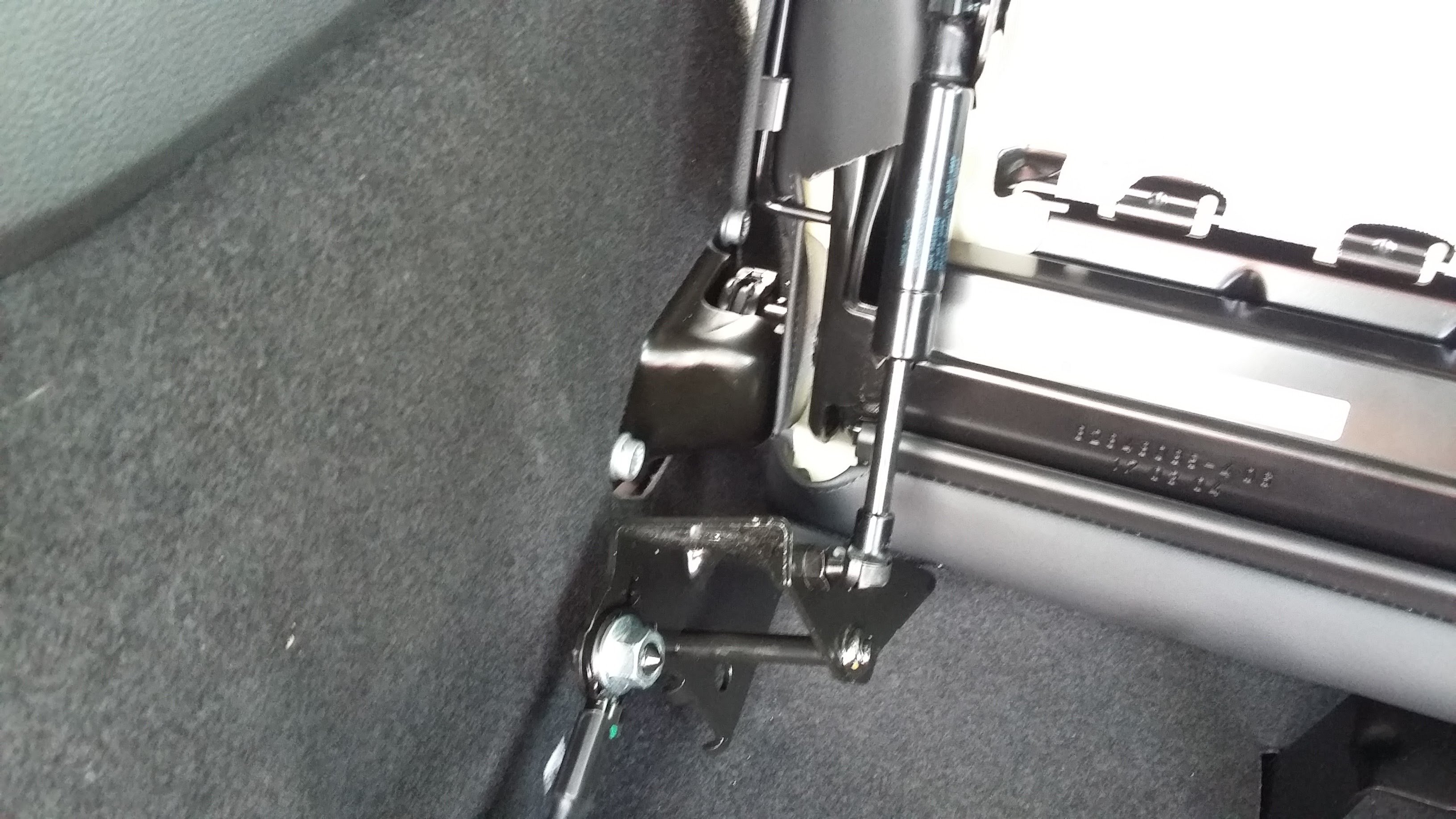

This appears to be as high as they go, which mirrors the height in your picture...
Bear in mind that in this illustration from the manual all the paraphernalia from the boot has already been removed, in your picture everything is still in situ, i.e. the foam inserts etc.
If you want to lift the seats higher you have to disconnect the struts from their supporting bracket by pulling them into the boot area towards each other i.e. pulling them off their ball joints.
I can't see this process mentioned in the manual though, do you have the text / images from your manual, or better still the print date / version?
I'm tagging @wokwon as I know he has spent quite some time removing and reinstalling the interior trim on his Kodiaq, which hopefully includes the third row seats.
Edited by silver1011
Yeah that's about how high they go.  My spare tyre is under there, the seat raise is just to allow one to extract the tyre.  Not so much to fold them up (that would have been simply clever).

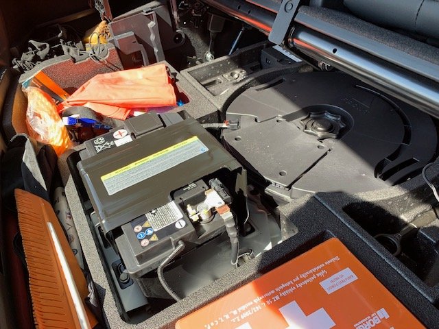

I had no idea the battery was there.
On 29/05/2020 at 16:58, Scot5 said:
Sorry guys, only just picked this up.  Many thanks for the info silver - appreciated. And wokwon for the hard labour!  :D
The battery is there for the RS version

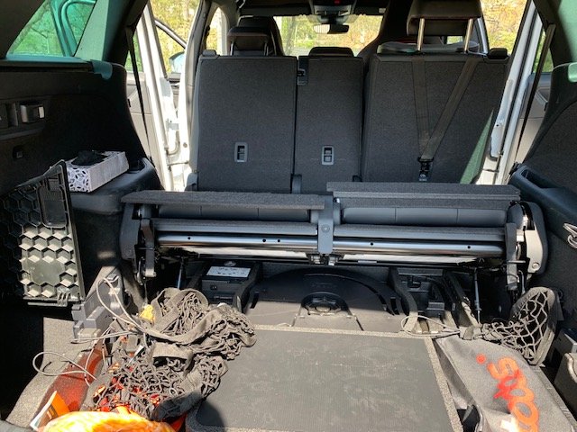

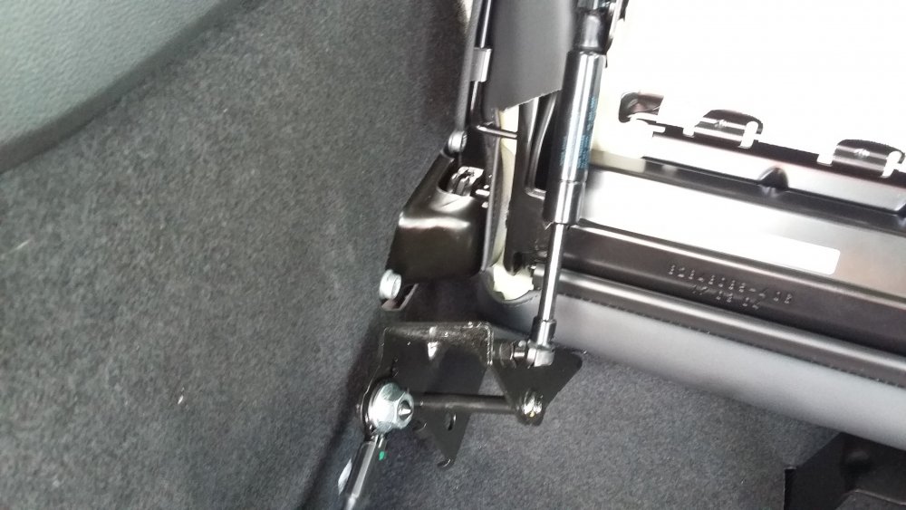

My Kodiaq is from 2019 and does not have seat occupancy sensors on the third row so it was just unclipping the dampers (that could'nt hold the seat in the cold anyway) and removing the two forward facing spline bolts
I thought about removing the sparae wheel and subwoofer as well - but Murphy law witt then probably cause a puncture
Billede
