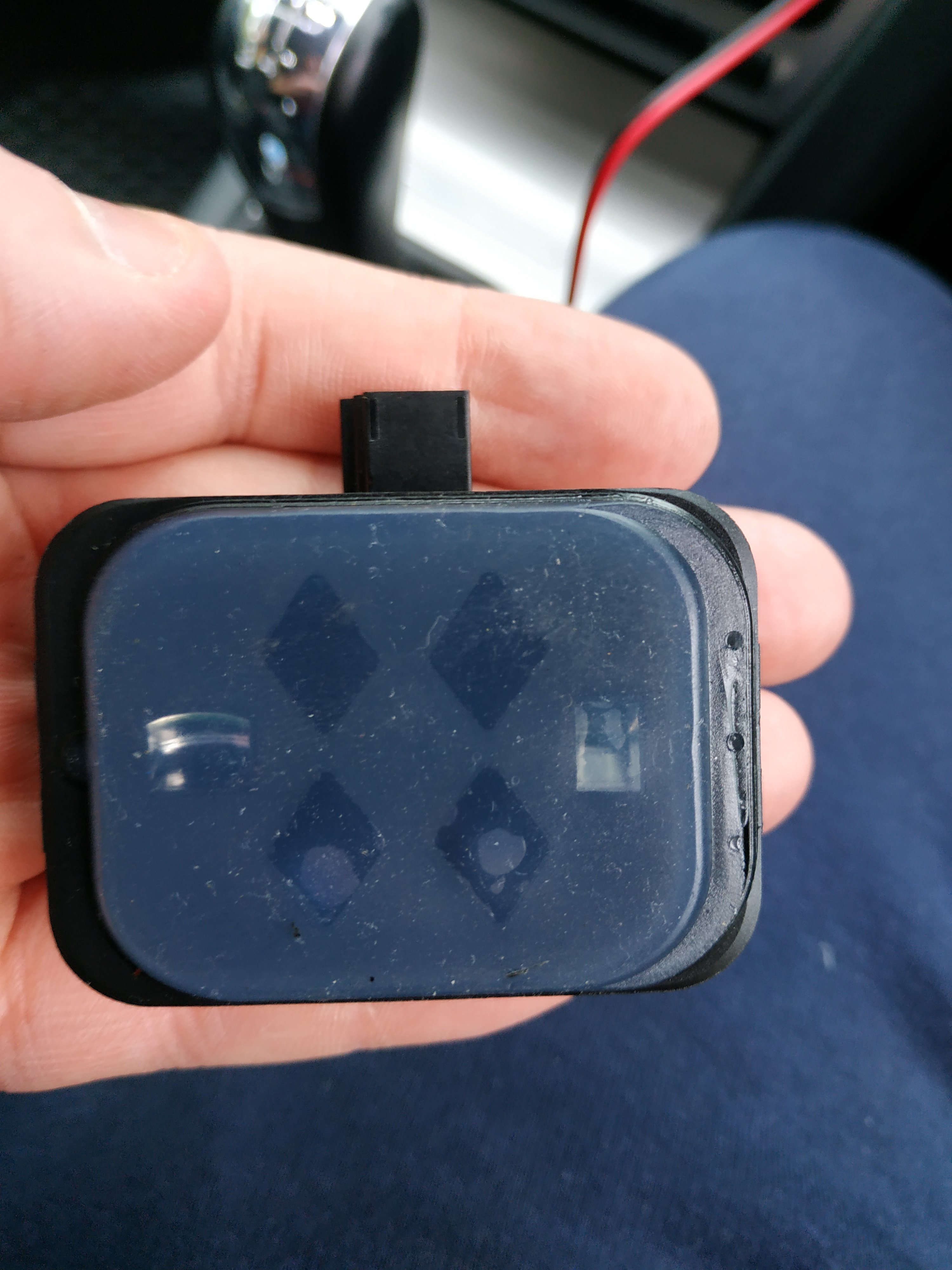

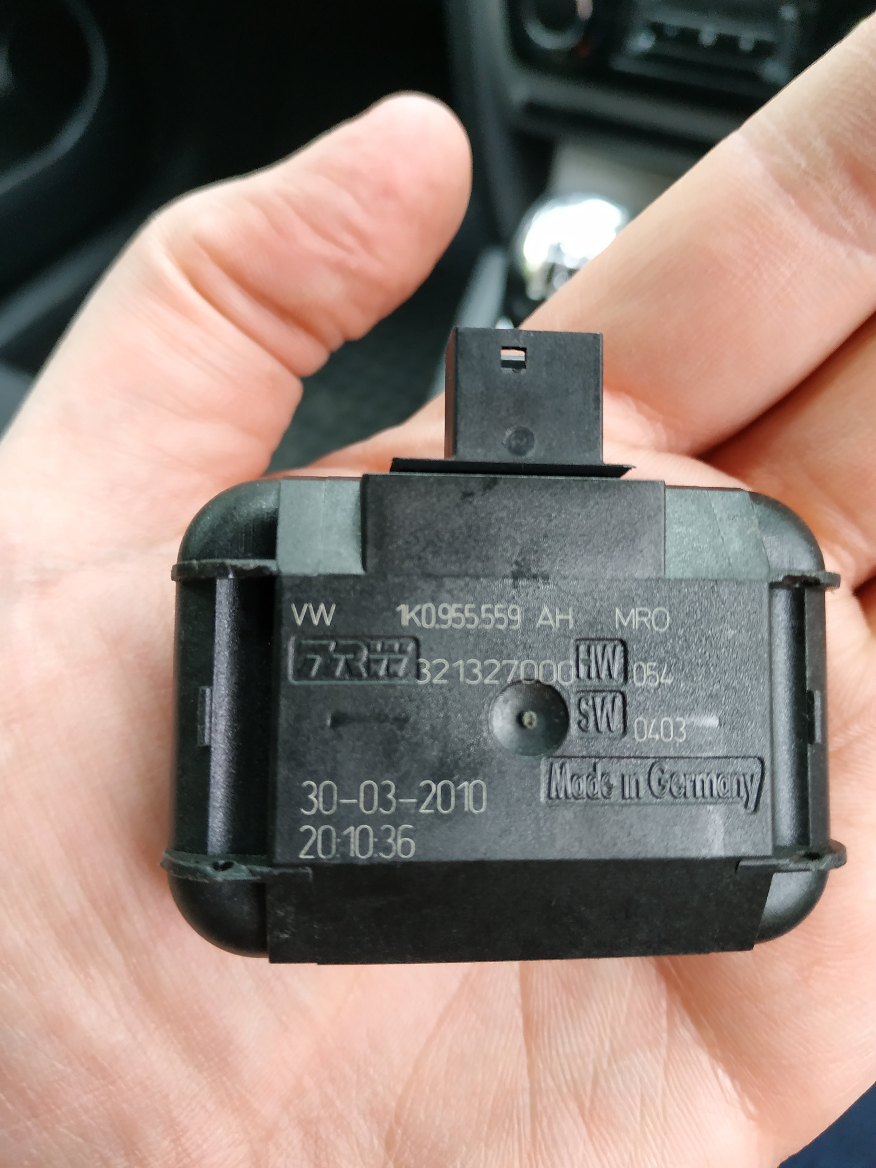

Ok - So I have taken the mirror and sensor out and sprayed the contacts with electrical contact cleaner but still have the same issue.
I guess its a new rain sensor needed is it best to go genuine skoda or would OEM be ok?
