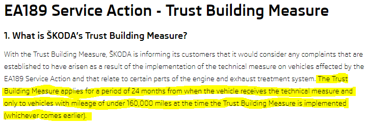

Although the trust building measure applies for two years, it can only be implemented on cars with fewer than 160k miles. That's one of the main reasons I avoided the fix (technical measure) as my car would (and now has) exceed the mileage limit long before the two years...
If that is the case then it is very poorly worded.
As I read it then the car won't qualify for the Trust Building Measure (TBM) if it has more than 160,000 miles on it at the time of the software update. As long as the car has less than 160,000 miles on it at the point it has the EA189 software update then you're covered for 24 months by the TBM, regardless of mileage.
I remember the thread where we discussed this previously...
Skoda UK claimed that as the car had exceeded 160,000 miles since new that the TBM didn't apply.
Re-reading their T&C's (highlighted in yellow above) this isn't how I interpret their written words.
If they'd placed a full stop after "160,000 miles" it would make much more sense. This is how Skoda worded it:
The Trust Building Measure applies for a period of 24 months from when the vehicle receives the technical measure and only to vehicles with mileage of under 160,000 miles at the time the Trust Building Measure is implemented (whichever comes earlier).
If only they'd written it like this instead...
The Trust Building Measure applies for a period of 24 months from when the vehicle receives the technical measure and only to vehicles with a total mileage of under 160,000 miles.
Their use of the words is implemented suggests the time the TBM starts, not it's duration.
Poor, very poor.

If they are prepared to implement The Fix on under 160,000 mile vehicles, they would then require to put in the T&C's that once the vehicle has gone over 160,000 miles they could not give a monkeys.
'Get on your bike, bog off, do not bother us we could not care less about your crappy TDI.'
If they made it clear about after 160,000 miles then people with a car with maybe 130,000 miles or more would go stuff that, why would i get the fix?
As it is i have no idea why anyone does anyway to just let VW Group tick off another one done. & think 'Mugs'.
That is not what their Mouth Piece Paul Willis CEO VW UK had UK MP's on a Transport Committee thinking VW Group would do for owners.
A meaningless piece of text.
Remove the "whichever comes first" rephrase the rest adding punctuation and it could be clear.
The intent to wriggle out must have been present for them to have included "whichever comes first".
Maybe deliberately written in such a manner.
