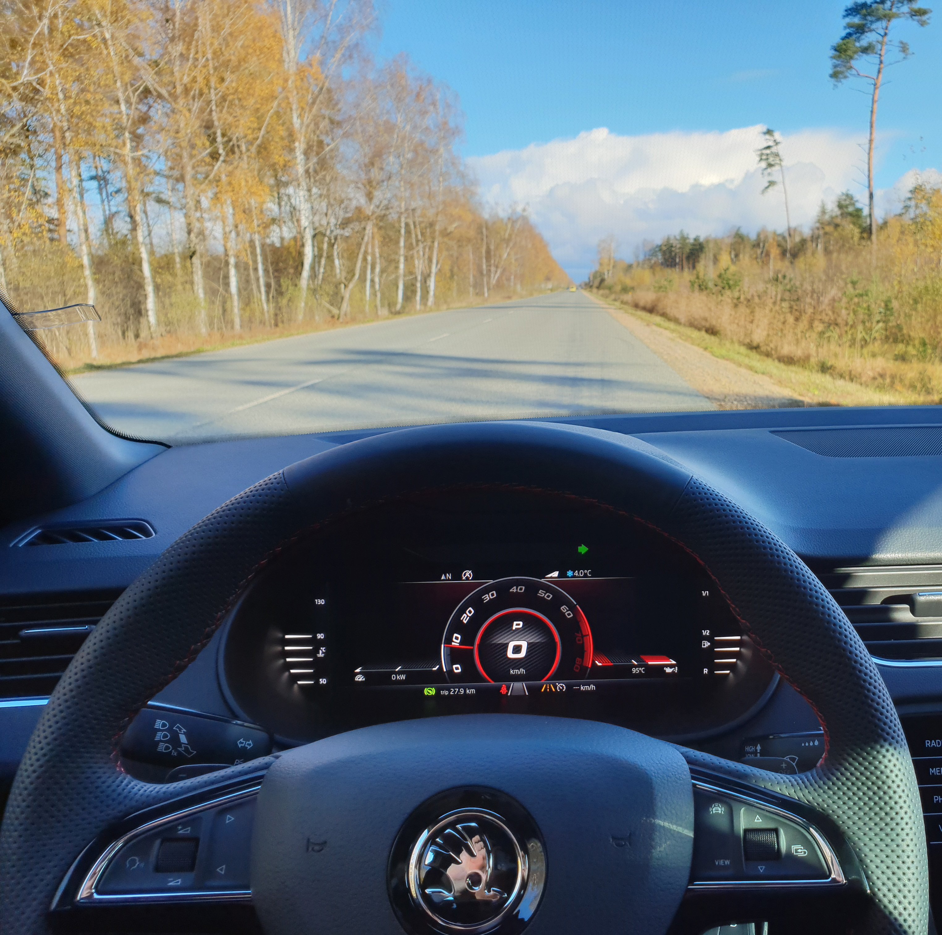

RS mode in virtual cockpit will show you engine power in kw, revs and engine temp, but that's it. Info in infotainment  of course is lackluster.
Doesn't answer @CallmeGaz point that you shouldn't be looking at the v-cockpit in performance driving.
My car doesn't have the virtual cockpit. But thanks for the reply.
