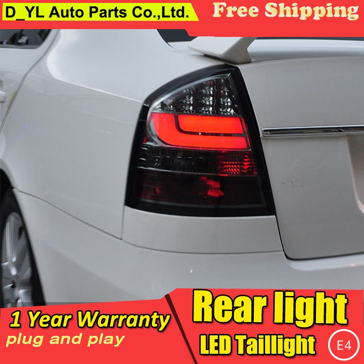

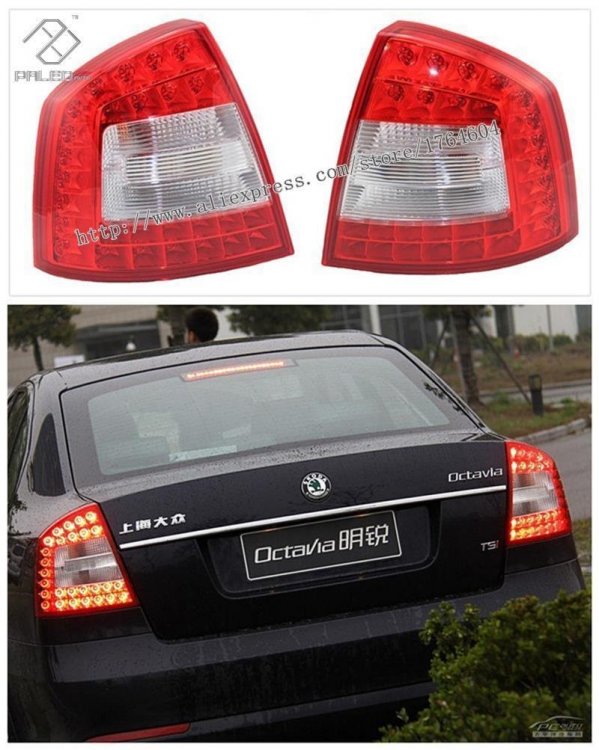

What would be better is fitting the genuine OEM LED light cluster used in the Chinese market and changing / coding the BCM to suit.
More expensive yes, but miles better looking, and safer too...
There are literally hundreds of listings on Alibaba / Ali Express...
for-skoda-octavia-a5-rs-2009-2010-2011-2012-2013-new-pair-of-led-car-rear-lights-tail-lights-with-gift.thumb.jpg.b689c889bdb57db5c35a8a3e4e12b2c2.jpg
You can even get non-genuine / aftermarket clusters now with the built-in load resistors you mentioned, plug and play...
Car-Styling-Tail-Lamp-for-Skoda-Octavia-LED-Tail-Light-2007-2012-New-Altis-LED-Rear.jpg.6dc6b9bf3bed43b923291f8bae51b85b.jpg
Take a read through of this thread...
Edited by silver1011
They are identical OEM replacements, so the complete opposite to the Halfords boy racer look.
I'd suggest that low quality LED bulbs fitted in standard light clusters that aren't designed to refract the directional light output from LED's and that therefore offer very poor differentiation between the brake and tail light features will look a whole lot worse...

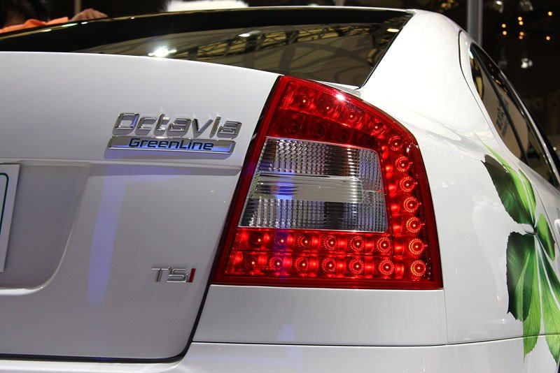

I like the OEM LED rear lights which is why I fitted some ;)
They are certainly an improvement on the original halogen units and look completely standard. To be honest, they do look better in person than in pictures though...
