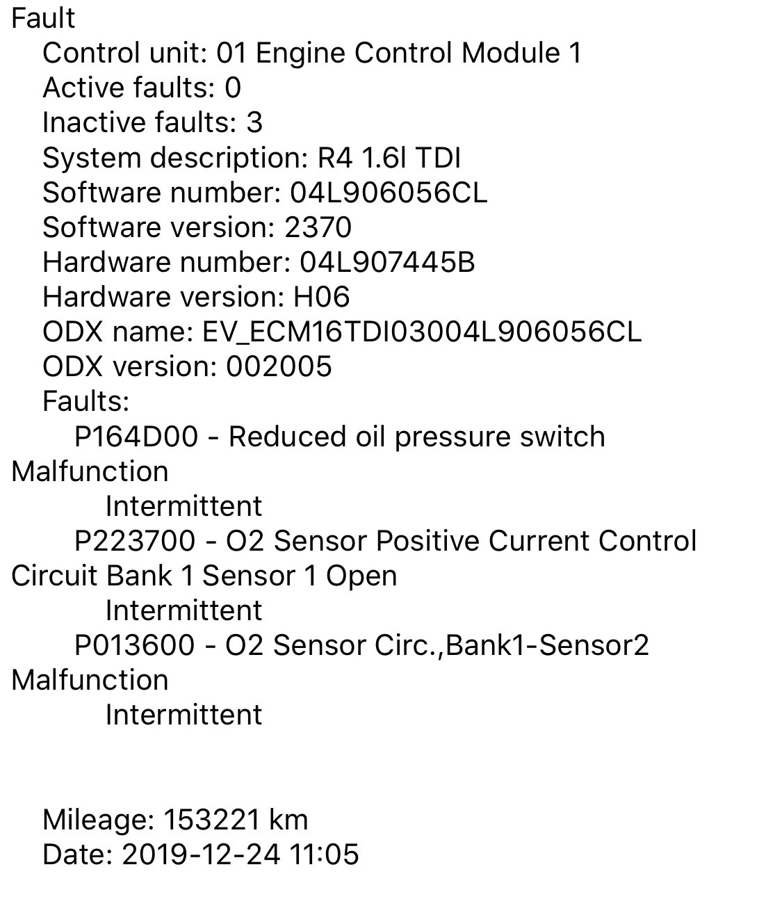

No fault codes with the turbo, the only codes related to the low oil pressure. The car has had the odd moment of hesitation/stutter while accelerating in low gears over the last few weeks which I’d dismissed as possible dirty fuel. In the days immediately before the smoke appeared I’d thought the car felt down on power but not in a way that was completely obvious and no errors were shown. I’d occasionally thought I needed to drop a gear at times when I wouldn’t usually or that the car was taking slightly longer to accelerate than it usually would.

Which is a known killer of turbos, particularly of the bearings.
Get a second opinion and quote. Possibly damage is more widespread than the turbo?
But I'm guessing your local garage already factored in the salvage value of your old unit into the quote.
These were the only faults to show after the oil pressure low message appeared.
New turbo has been fitted but still getting a low oil pressure warning. Unfortunately at this time of year it’s taking longer to fix due to festive holidays. Hopefully fixed fully tomorrow. The garage will try a new sensor to see if that’s the issue or I’ll maybe ask them to check the sump oil pick-up to see if that’s blocked. They had suggested running a second engine flush.
