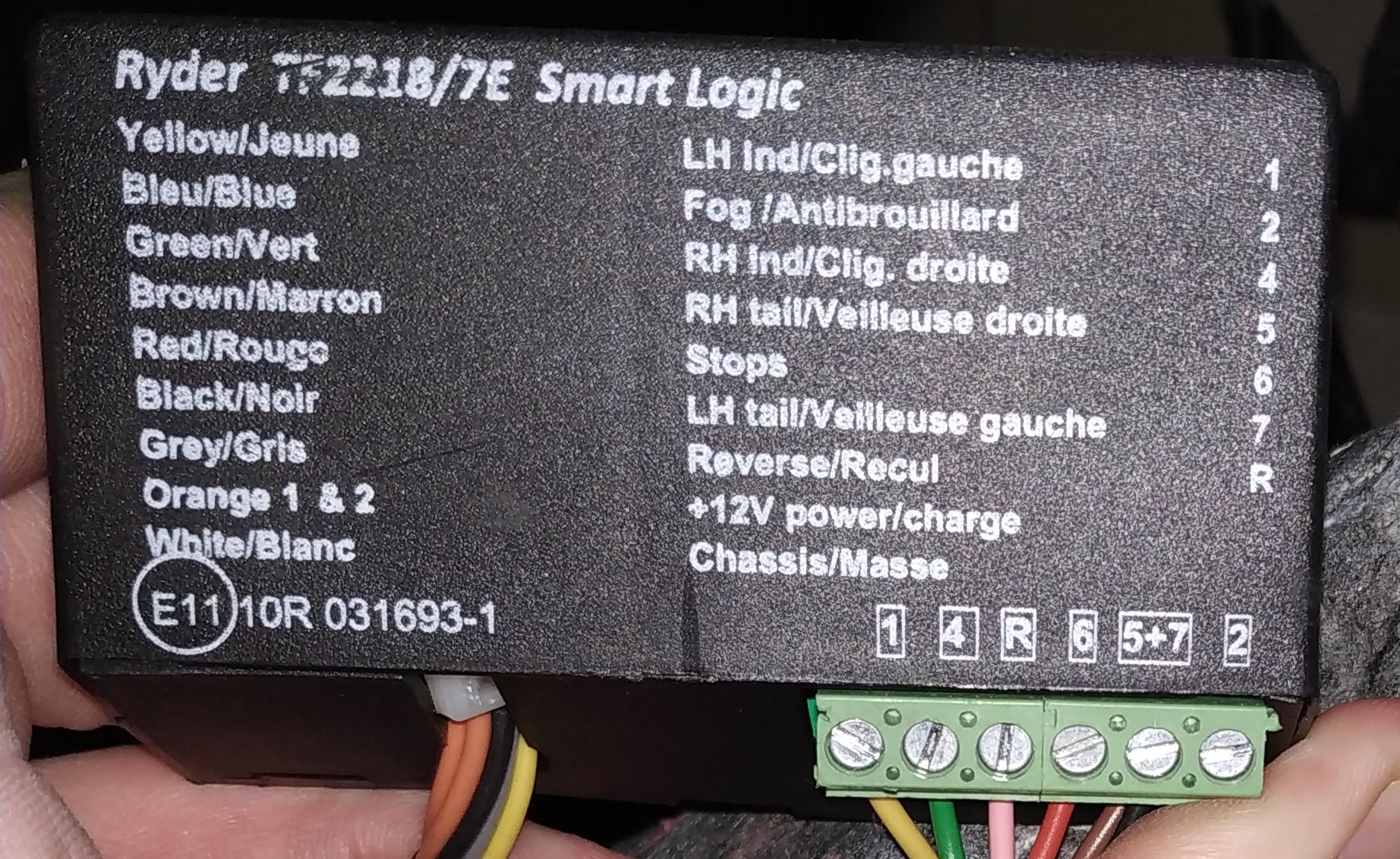

So I have been messing about with replacing some of my rear bulbs with LED's and all of a sudden there was a buzzing.
I have traced this back to the Tow Bar Relay switch so it looks like this needs changing out. Has anyone ever done this before and is there a better unit for LED bulbs?

@SuperbTWM Yes bulbs swapped back out but still has a buzz. I think this was the straw that broke the camels back! I will replace but wondering if anyone else has found a replacement of a better standard. Like you say this does feel very cheap in the hand!!

As mentioned, whilst these types of bypass kit have worked for many years without issue (a previous Octavia of mine had one), modern cars are now much more complicated.
The days of splicing into the cars existing wiring loom are all but over. All reputable tow bar manufacturers and fitters are using dedicated vehicle specific wiring kits these days.
Even the vehicle manufacturers are aware of the issues that can be caused by poorly retrofitted tow bars, including Skoda, so are actively discourraging it.
My advice would be to replace the bypass box with the one listed above from Ring (a well regarded automotive electrical specialist), or disable it completely and do without the tow bar.
This is based on the fact that removing the LED bulbs has not stopped the buzzing, and that you mentioned you don't use the towbar.
