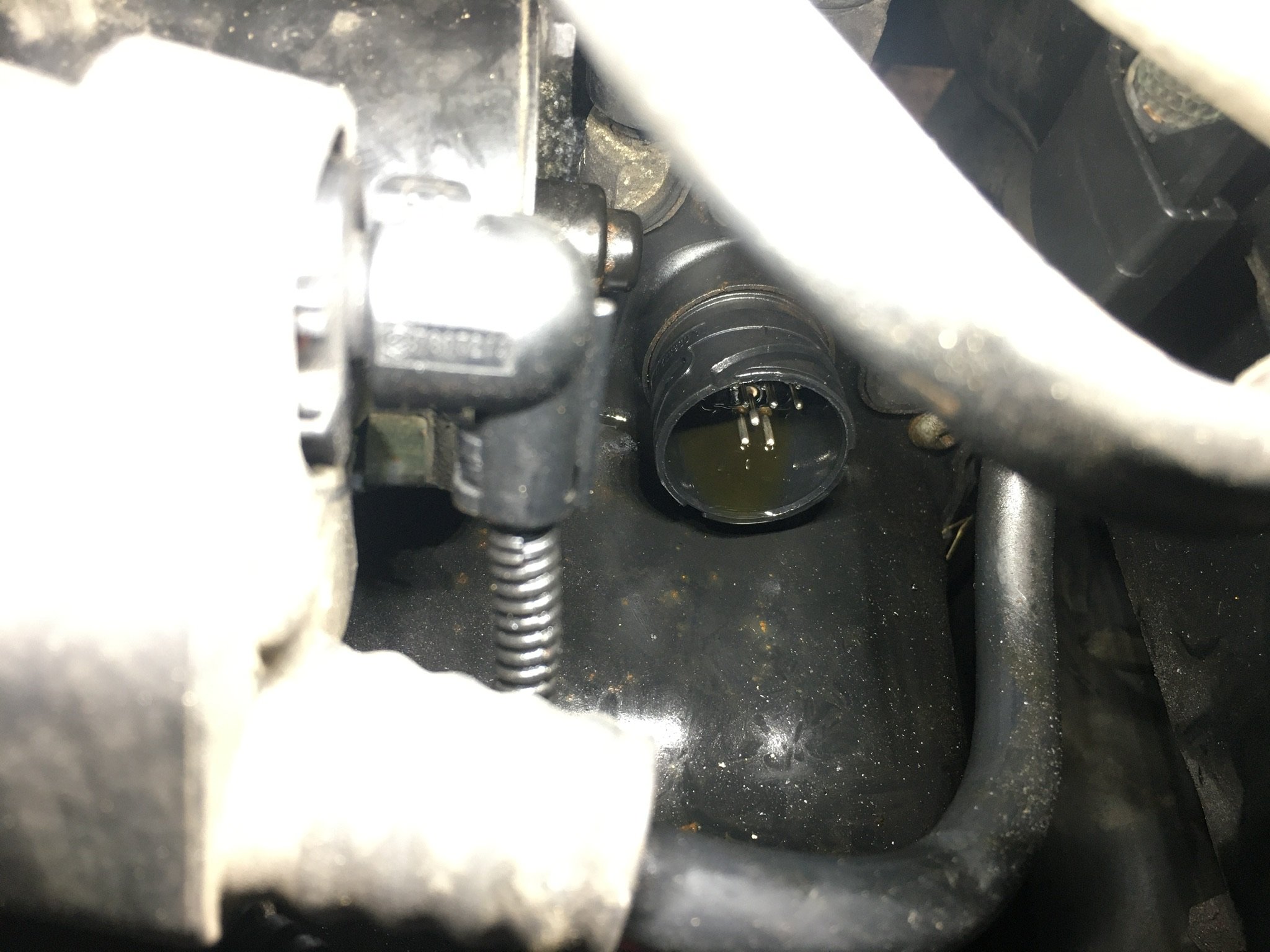

Update, and some more advice needed.....
Found the plug, it actually sits on the front of the gearbox, and the TCU is inside the gearbox.  When I disconnected it, found lots of oily water in the plug.  Dried it out thoroughly, but still no joy. No communication between ECU and gearbox.  Left a fan heater on it overnight to make sure it was totally dried out, and found the plug was full of what looks like oil!  Where the heck could this be coming from??  A bust seal in the gearbox maybe??  Anyone any ideas?  Thanks.
