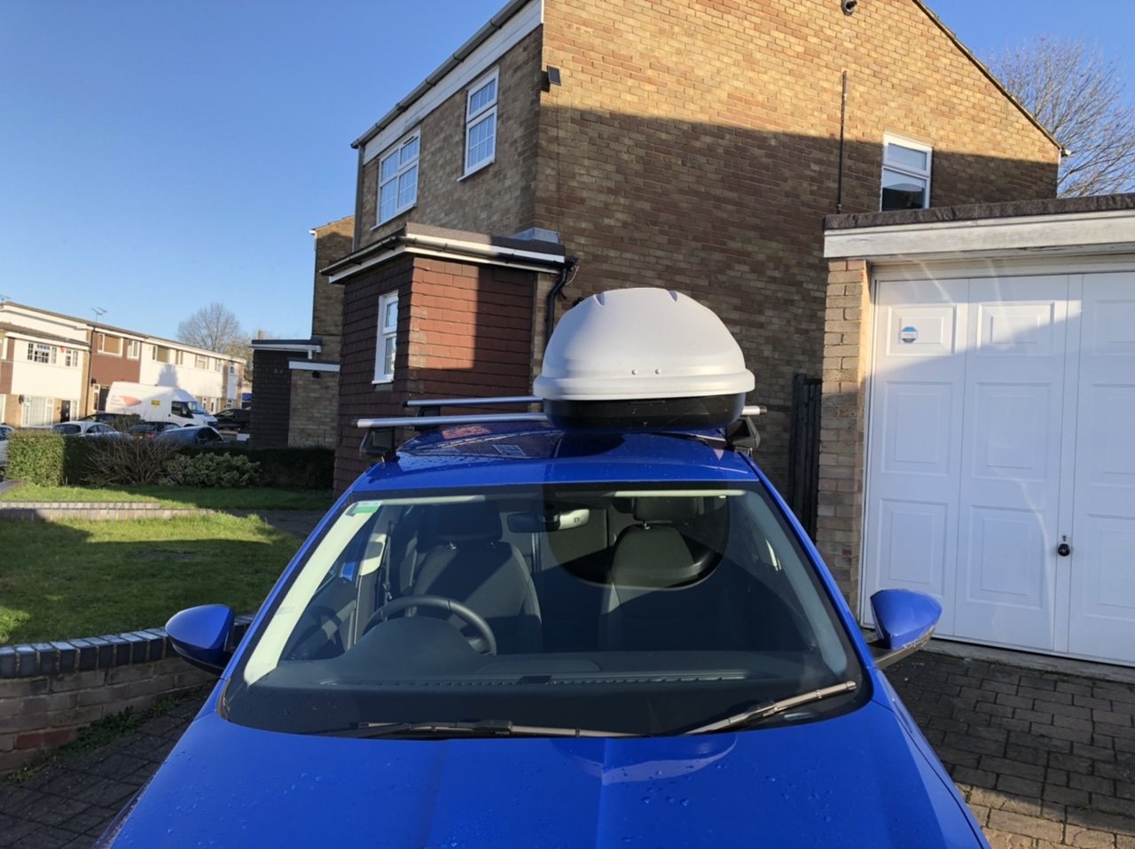

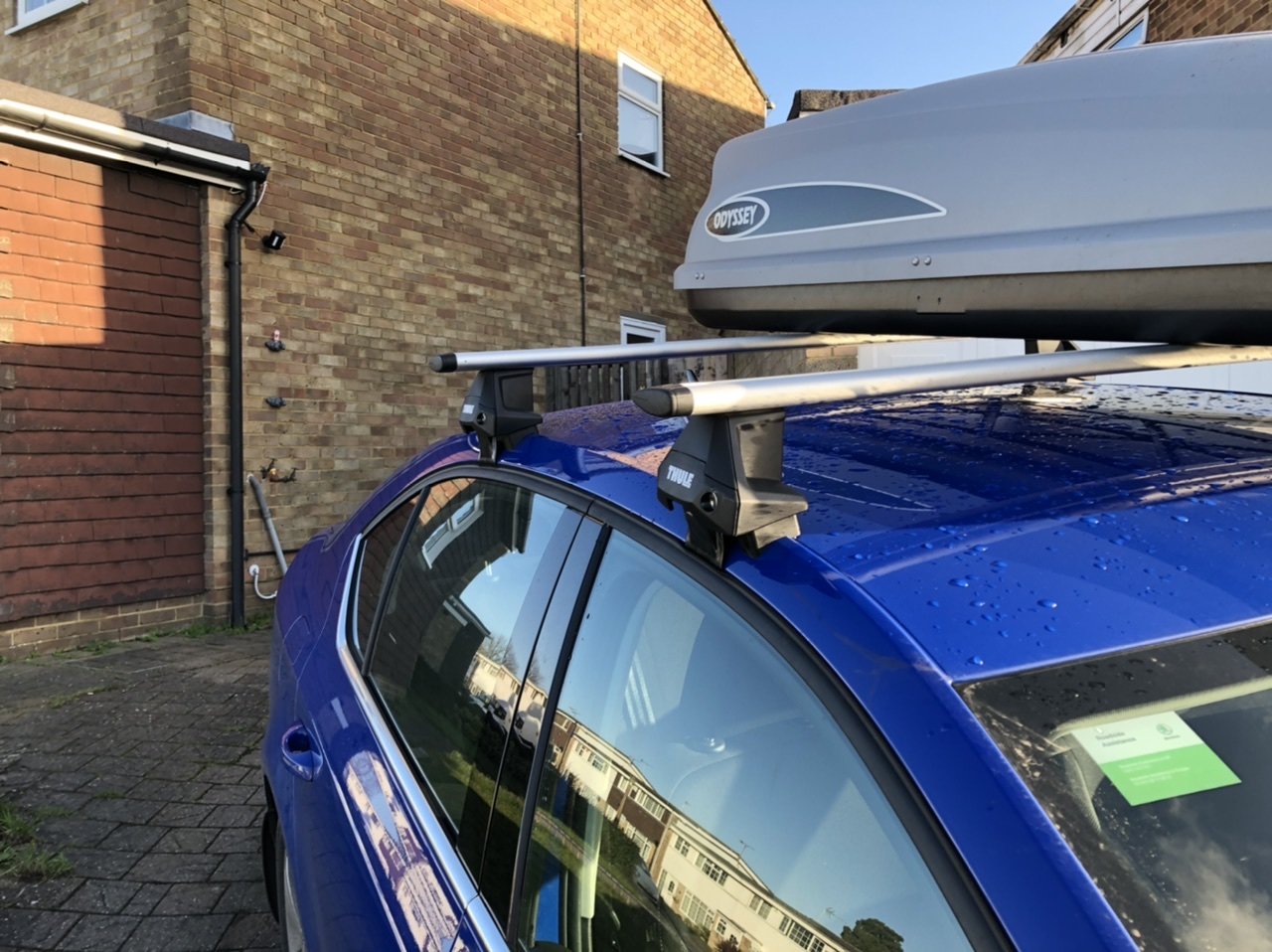

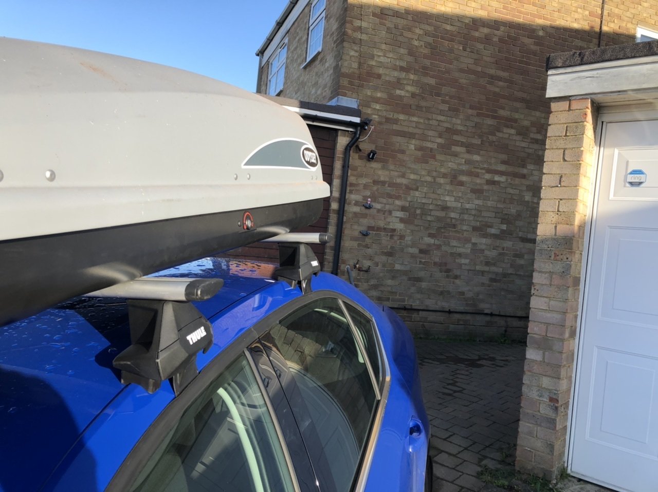

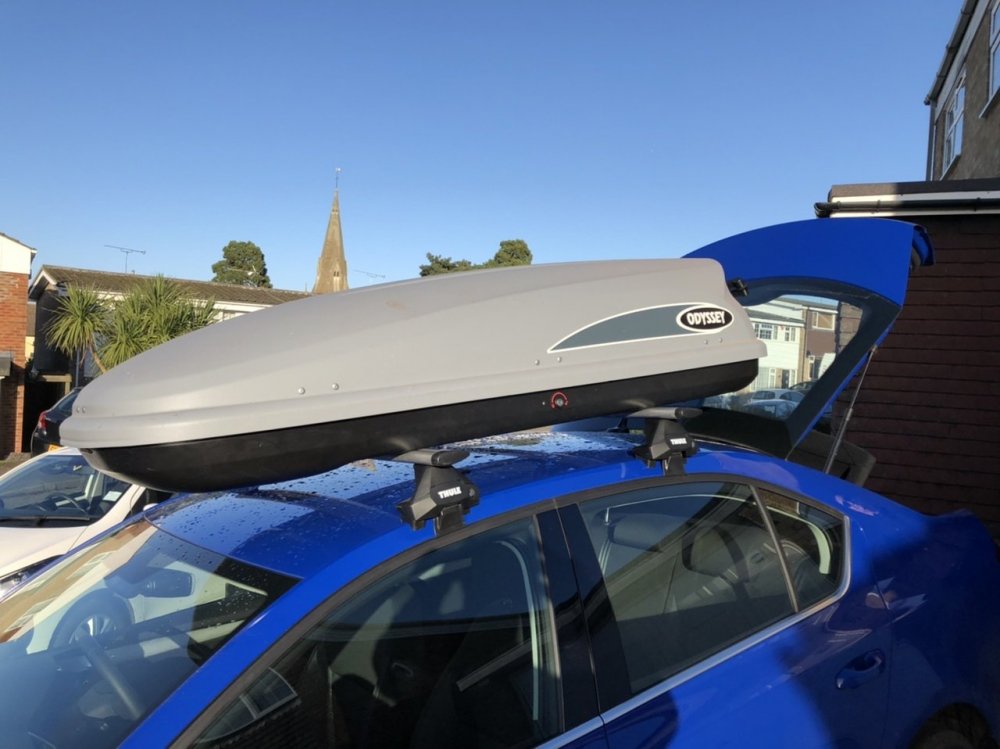

My car with 127 aero bars.
Looks great mate.
I'm having to wait for the 7105 feet to come in to a supplier I'm buying the kit from. £131 for bars and feet is pretty decent I'd say!
I see what you mean about the rear sticking out. Oh well, hopefully the next car uses the same 127cm bars !
