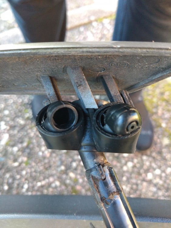

The next opportunity to do so I pulled them out to look at them. (Picture below)
Both of my headlamp washer units appear to have lost one of their two nozzles, .
At least it looks like they are missing as they don't look the same as replacement items I have seen on websites.
Which I suppose explains the unusual spray action.
Do I have to replace the whole washer unit to get the nozzles/jets?

The jets aren't available separately, you need to buy the complete retractable nozzle.
Take one of the available jets and fit it to the other side to make a complete nozzle, then just buy one new nozzle.
Luckily they aren't expensive.
