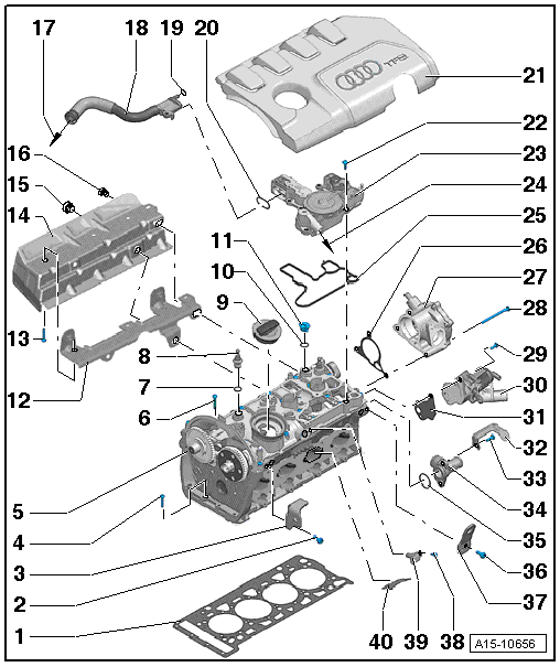

I have the CCZA engine in my Octvaia Mk2 and that kit wouldnt fit my car.
Found this on a audi workshop manual. Its supposebly is the CCZA engine. Which in the picture has the africa plate mounted on the cam cover.
Also if you scroll down on the link to the catch can it shows that it fits the early skoda engine but not the later. I would suggest that the website is wrong.
To the OP just take your time and check you're getting the right parts for your engine.
