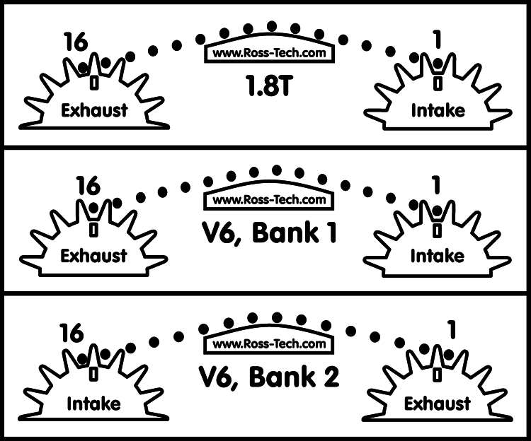

Audi Volkswagen - 2.0L Chain Drive - P0016 Cam/Crank correlation check
The photos in this album are from a faulty spool valve (control valve) in a 2012 Jetta with CBFA 2.0T.
General notes:
On engines with chain driven intake camshaft(s), but belt driven exhaust camshaft(s), verify the number of chain roller links between the intake and exhaust camshafts is correct. Click on thumbnail to enlarge:
