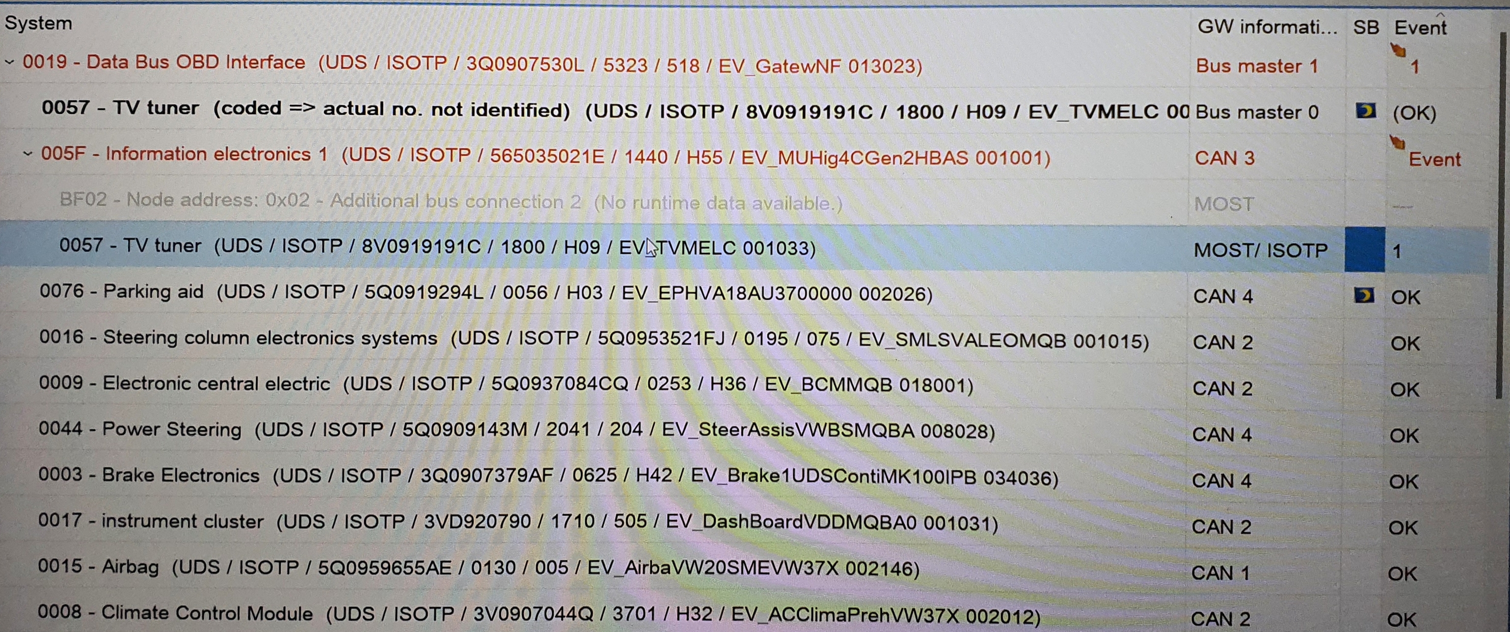

Tv tuner is power and MOST only.  In 5F  there is an adaptation in Car_Function_List_BAP_Gen2  > TV_tuner_0x2C_msg_bus , Comfort data bus is selected i don´t know if it is the correct one and have lots to choose.

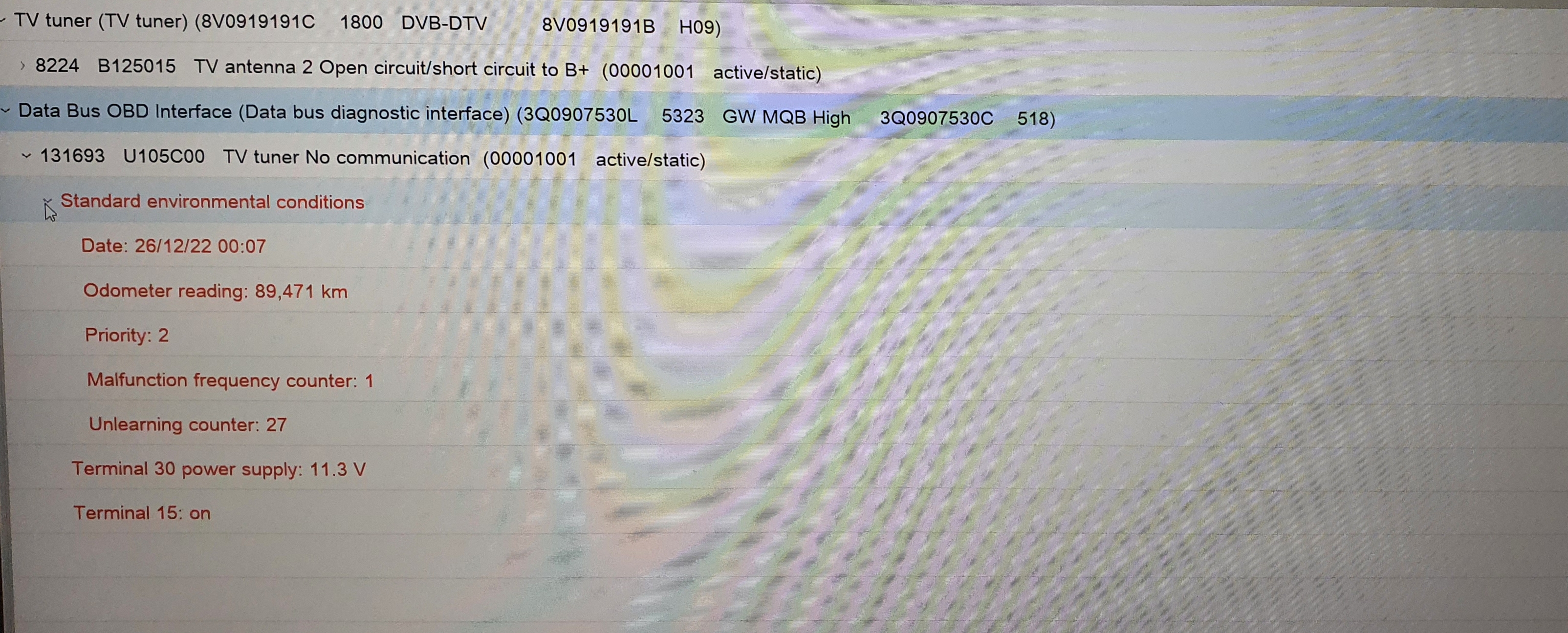

There’s a single LIN wire to the 5F, has this been added?
you’re right about no canbus

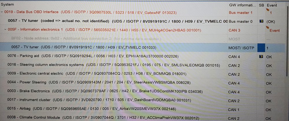

So much back and forward all this time and every thing was working  , you don't have to enable 57 tv tuner in gateway because it talks to the mib2 unit 5F (5F is a Most bus master ) and obdeleven did not help in here because it does not scan most bus modules . A year after and i have it working finally.

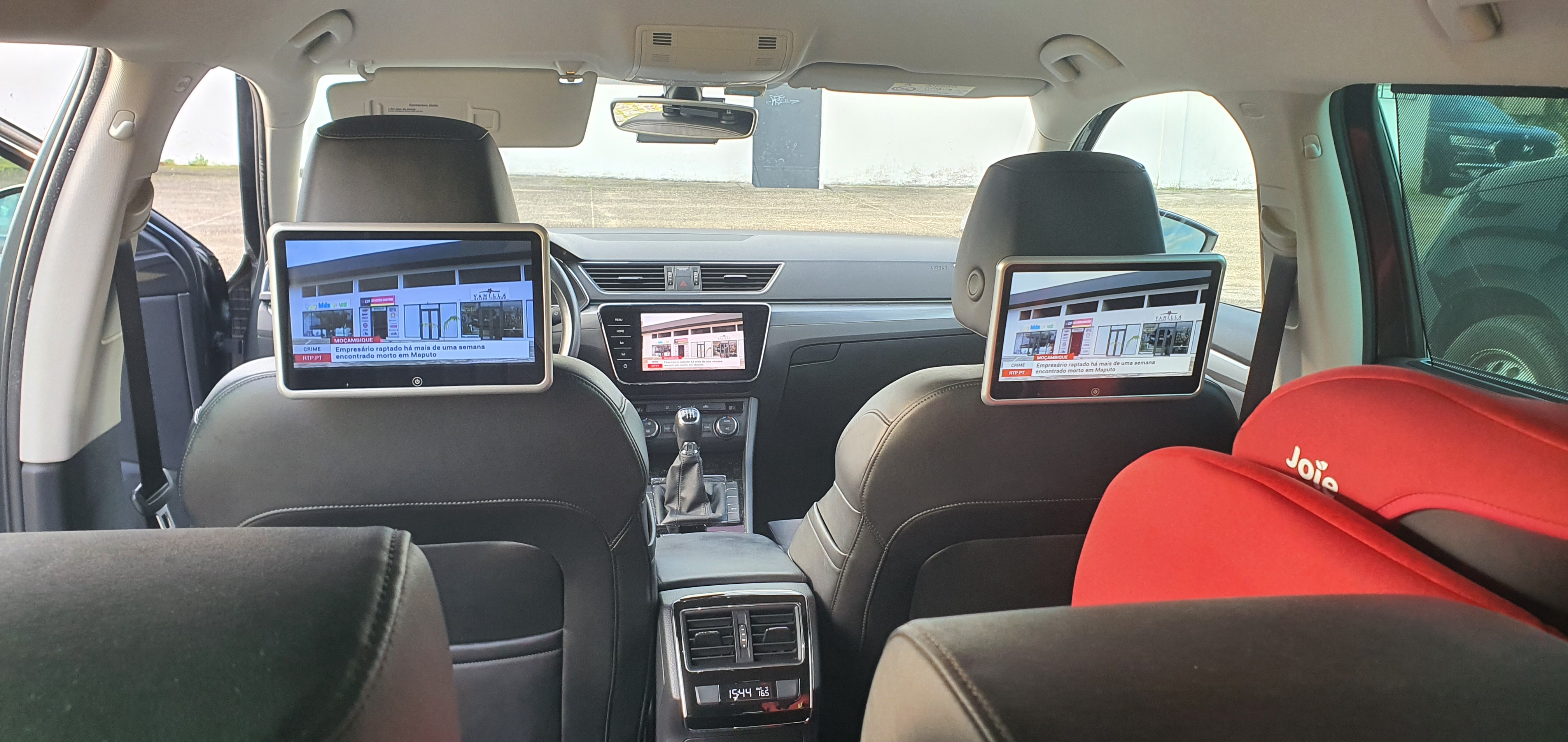

Hello , i as able to see tv in the back monitors but if i want to pass multimedia from the mib unit i can´t , how ca in achieve this ?
What are you using for the rear monitors as i assume they are aftermarket? Didnt think the superb came with them as standard?
Yes they are aftermarket , but the tv tuner just conects to te monitors through rca cables yelow red and white . I always thought that they would mirror the mib unit but now i'm starting to think that it works just like this . The tv tuner it self does not have many configurations to switch via odis.

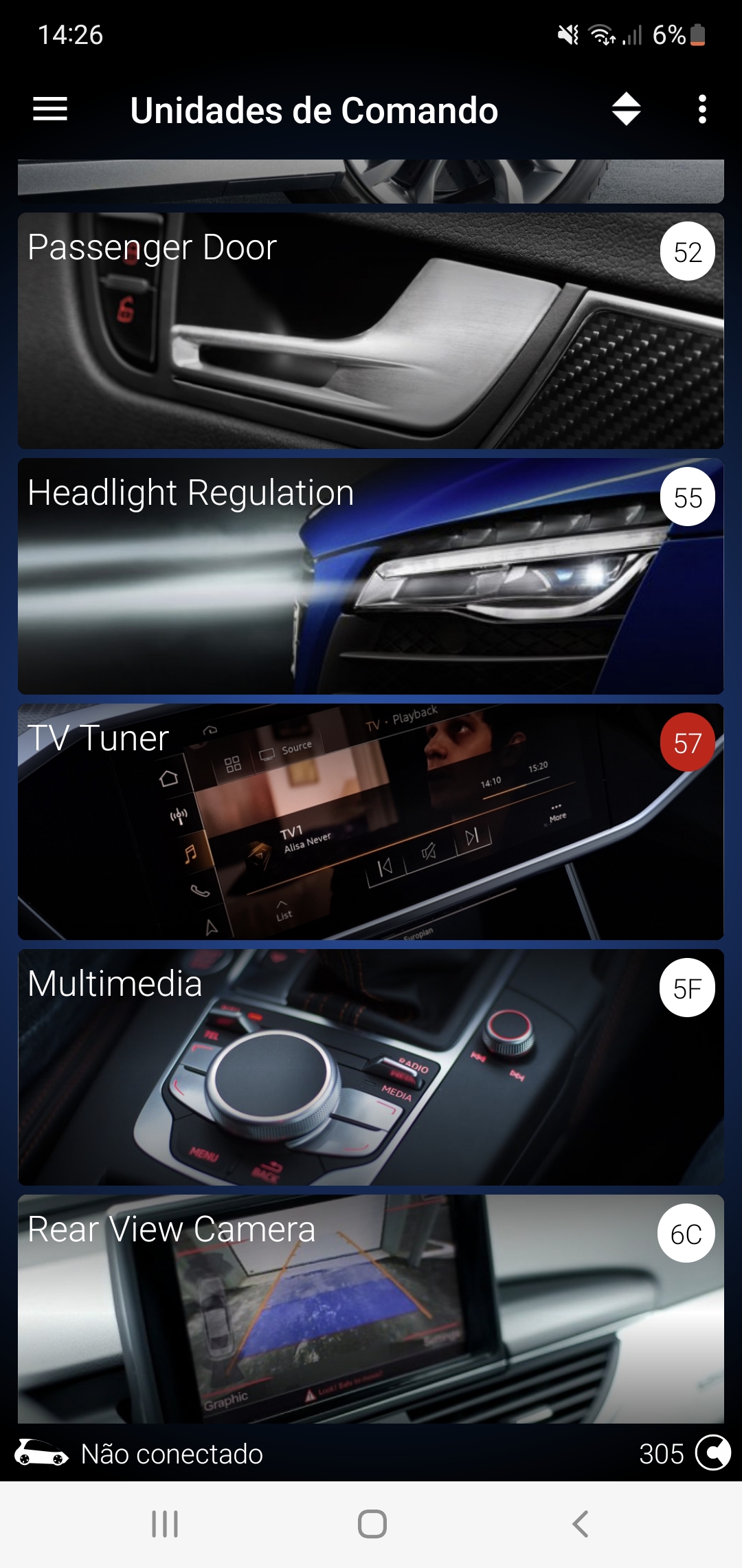

I have been contacting obd 11 because of  most bus modules not showig  , they have now updated the aplication and it is working.1885133327_Screenshot_20230121-142642_OBDelevenVAG.thumb.jpg.ae184abe1954a3c0eb3ee8ba245fbb2f.jpg
