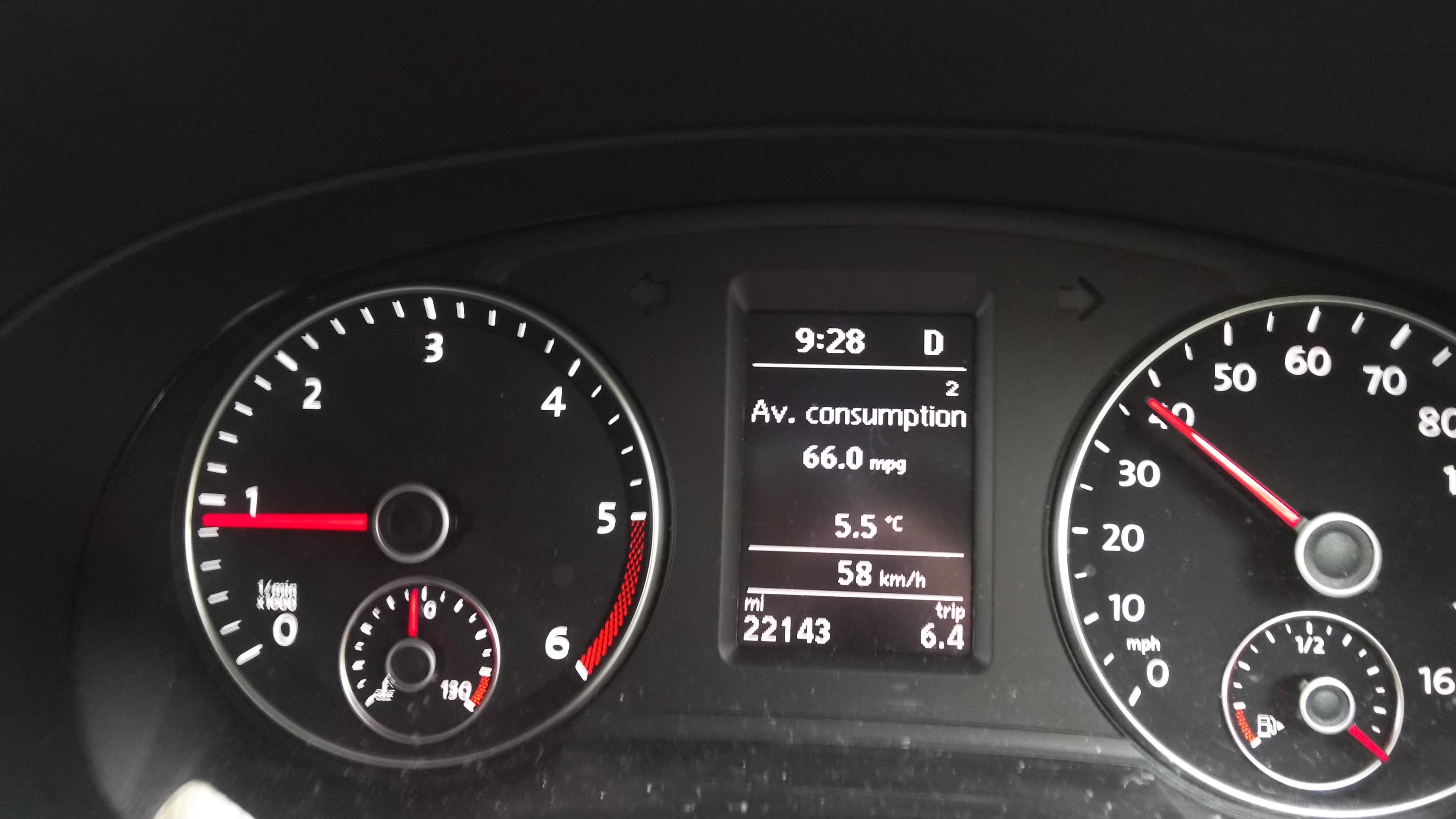

I have had a driver drive my car with me as a passenger & the car was as i had it set and they never even noticed that the car was 'Coasting' and the gear indicator was showing 'D' and not D6.
I let someone drive and said nothing and when we were stopped i changed the dash to show Average Fuel where the word 'Coasting' came up,
they still never noticed.
If coasting function is available on a car i set it, never known a car with it not to function as it should when the toe is off the accelerator and no load on the engine,
but if i borrow someone elses daily drive i do not mess with their settings.
Same thing with going down hills and the car 'Coasting' or freewheeling or decelerating / using engine braking.
The car knows the angle of the dangle...
I really like this feature on my new car and shortly after starting the engine change the DSG from normal to eco so that I can take advantage of the coasting and early gear changes. As I have 14 roundabouts to negotiate on my commute each way I lift off the throttle and watch the revs drop to just 800rpm until I pick up the throttle exiting the roundabout. The symbol on the dash typically changes from E7 to just E whilst coasting.
