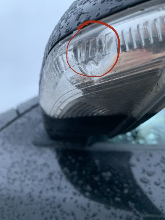

They all have LED indicators / repeaters / turn signals built-in, regardless of the market the car is sold in.
They are prone to water ingress though which eventually causes the LED to fail...

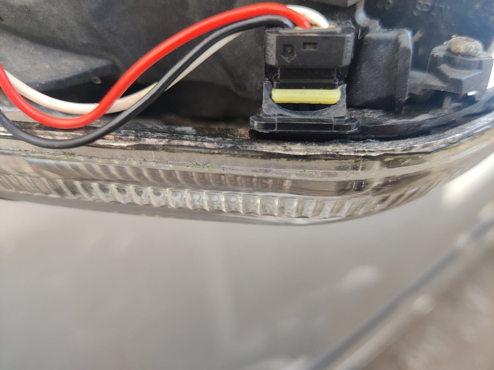

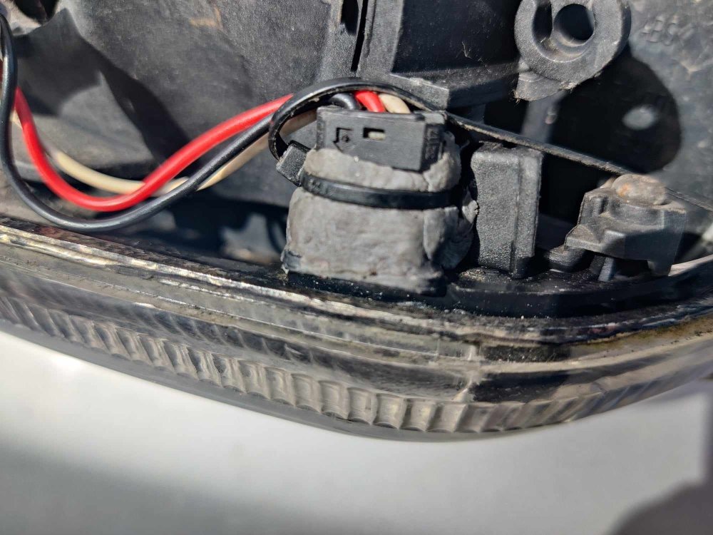

Resurrection for hopefuls - check that there isn't damage at either of the plugs or their connectors. I used some kwiksteel & a tiny cable tie to repair the socket on mine.
