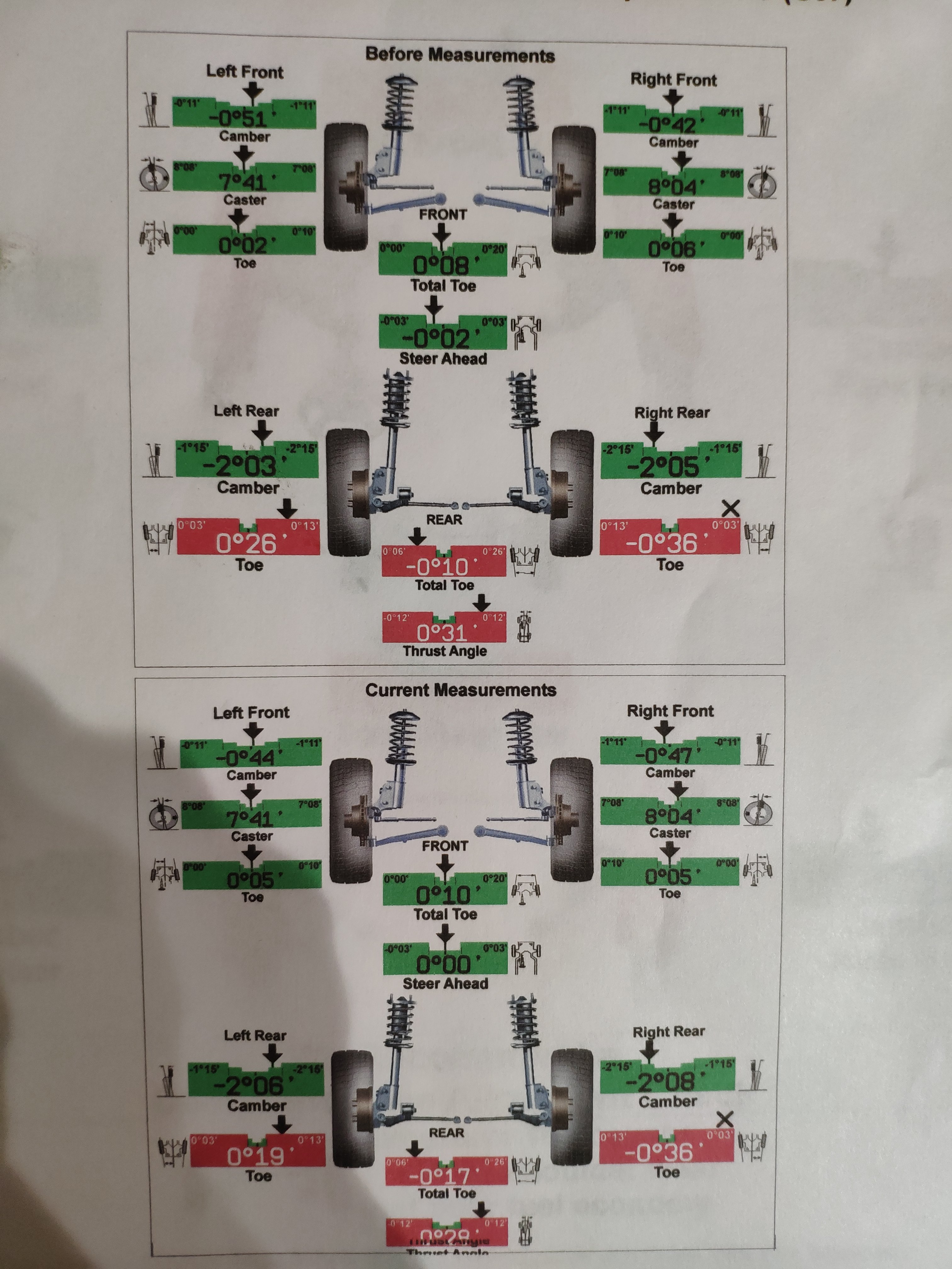

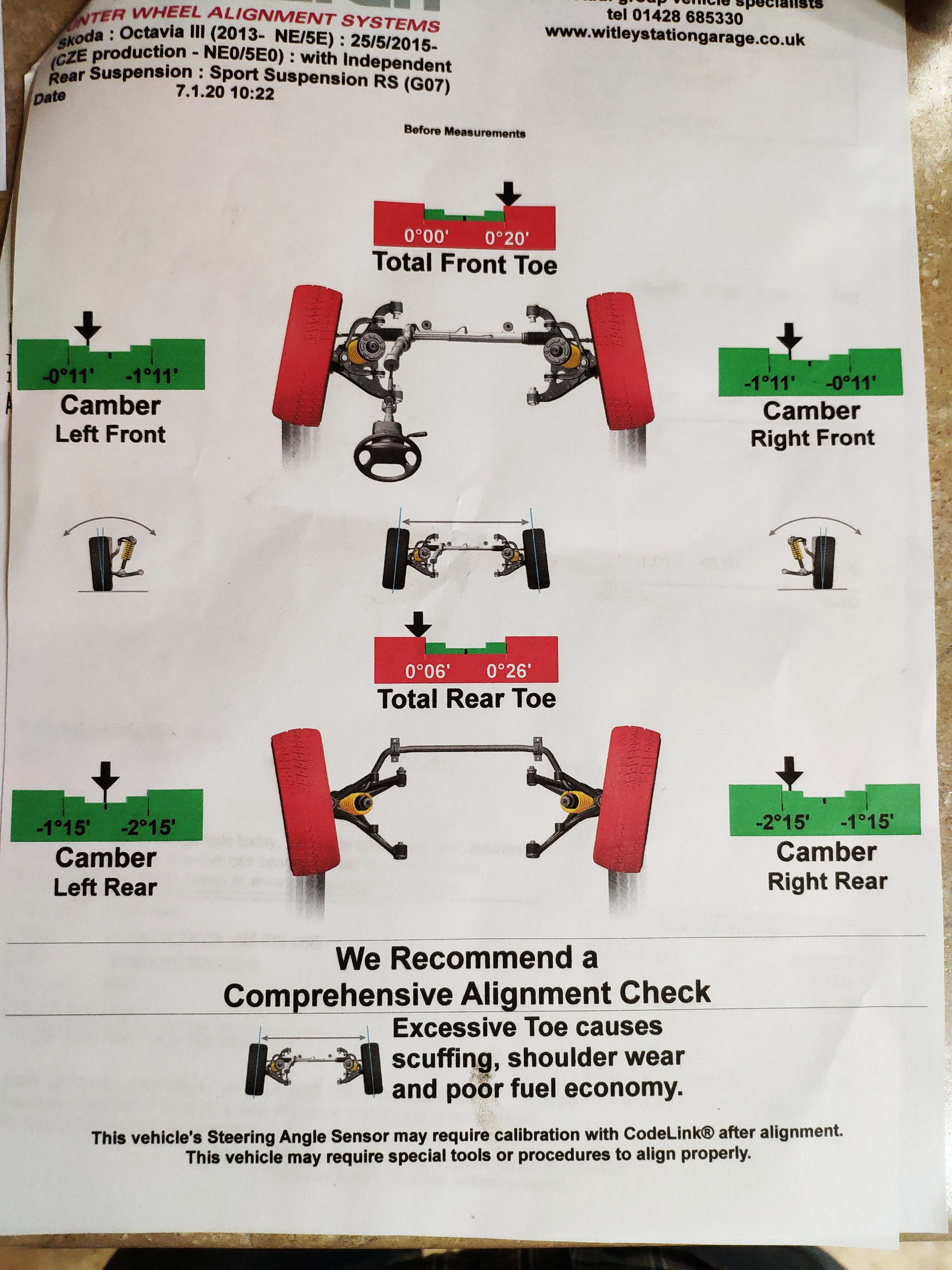

Took the car in for alignment today. Have attached the print outs. They said they adjusted the front track as steering was out but they couldn't adjust the rear toe they wanted to adjust because they said it wasn't adjustable on the car.  Have since checked and this would appear to be *******s. Before I go back to them could somebody please have a look at the printouts and give some idea of what state they think the alignment is in and the extent to which bits need altering? Depending on what people think, i may well just go back to them for partial refund and take it somewhere where they have a better idea of what they're doing but I'm not clued up enough about it to make my demands or requests just yet!

Right you vehicle being a VRS the rear camber can be adjusted, rear toe has very limited adjustment if any, however adjusting the rear camber will to some extent (i will not be perfectly adjusted) pull the toe back in to tolorence, your VRS will drive straight but will wear the tyres quicker. The gauges they have used are a HUNTER setup if you look on the top of the print outs so no need to go to southhampton if it's a 50 minute drive as they WILL be the same. thay done a pretty good job there to be honest. Hope this helps. I do few alignments a week where i work (although our alignment gauges are not a HUNTER set the are very very similar and do the same thing) but not done MK3 VRS as yet done a couple of MK2's and the rear suspension is very similar, and mine has torsion beam rear, so only front can be done.

Thanks. Seeing as you understand the figures better than I what makes you think it's a good job? They didn't adjust anything on the rear because they said there is no adjustment possible on the car because it has the wrong rear bushes or something like that. How badly 'out' is the right rear? It has a cross which makes me think 'bad' but I don't know really know.
The figures are showing the camber is fine, nothing to do with wrong bushes (bushes are just that bushes) not allowing adjustment, the adjustment is on an eccentric bolt, as you turn the bolt it moves the hub in and out therefore adjusting the camber, it's the toe that out, the right being the worst, toe is how the tyre points in or out, it will where one of the tyre faster, basiclly looking at the prints Green is good, red is bad.

That's what I thought. So they don't really know what they're talking about then, i guess?
