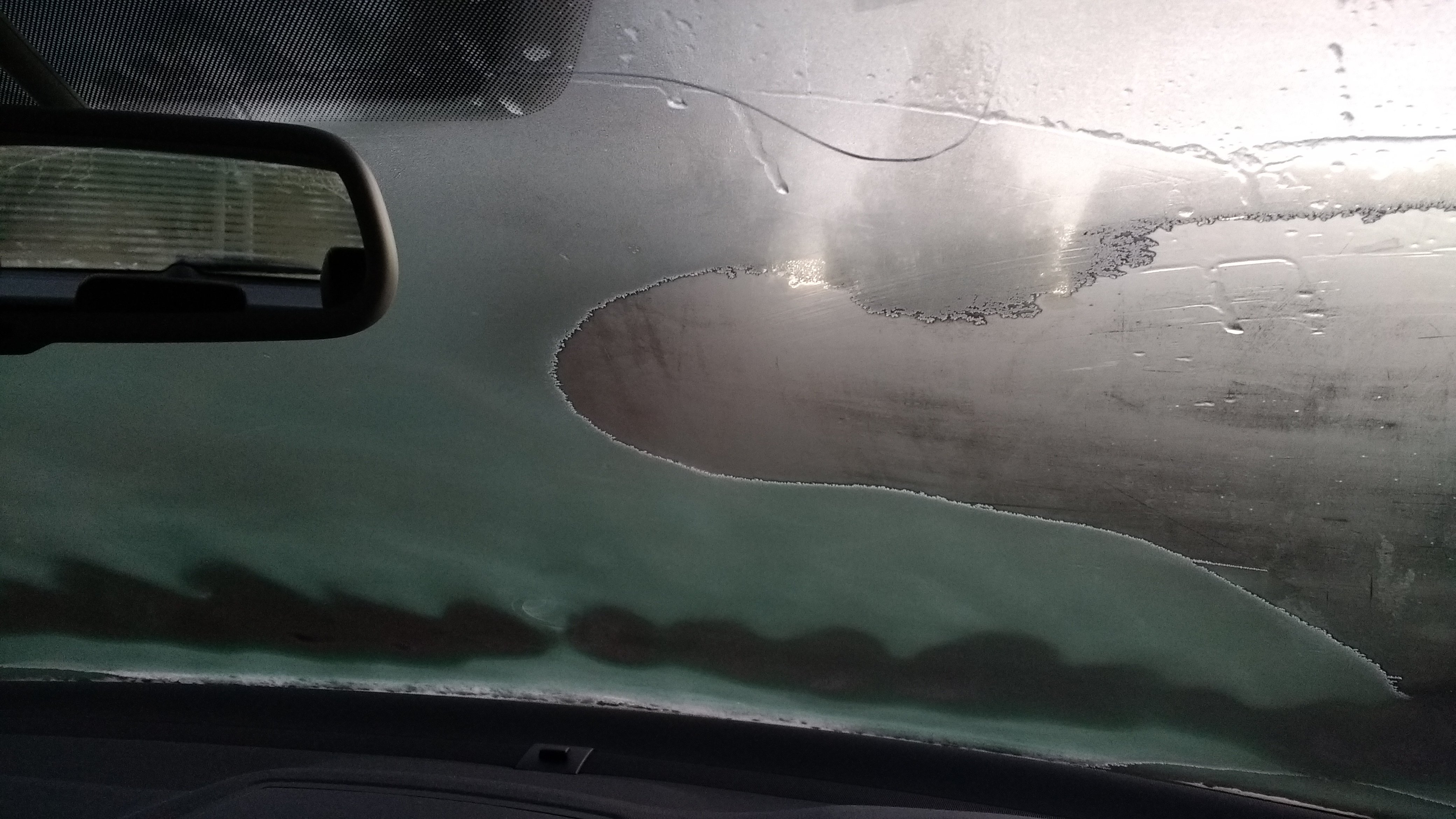

Here's what mine looked like after being started 15 minutes, temperature only -1.5C, demist on, external glass treated with deicer/scraped.
That's ice I had to scrape from the INSIDE!
30 minutes before I could drive.
Out of curiosity, if you respond please say if your windscreen was previously replaced, mine was and it may be a clue.

Yup. Mine's the same. Sometimes it's clear until I drive off then it mists up!!!

There's no apparent leak and like Golf-Fiend stated it's not uncommon for the screen to mist completely in seconds when otherwise clear so I'm thinking A/C evaporator problem.
