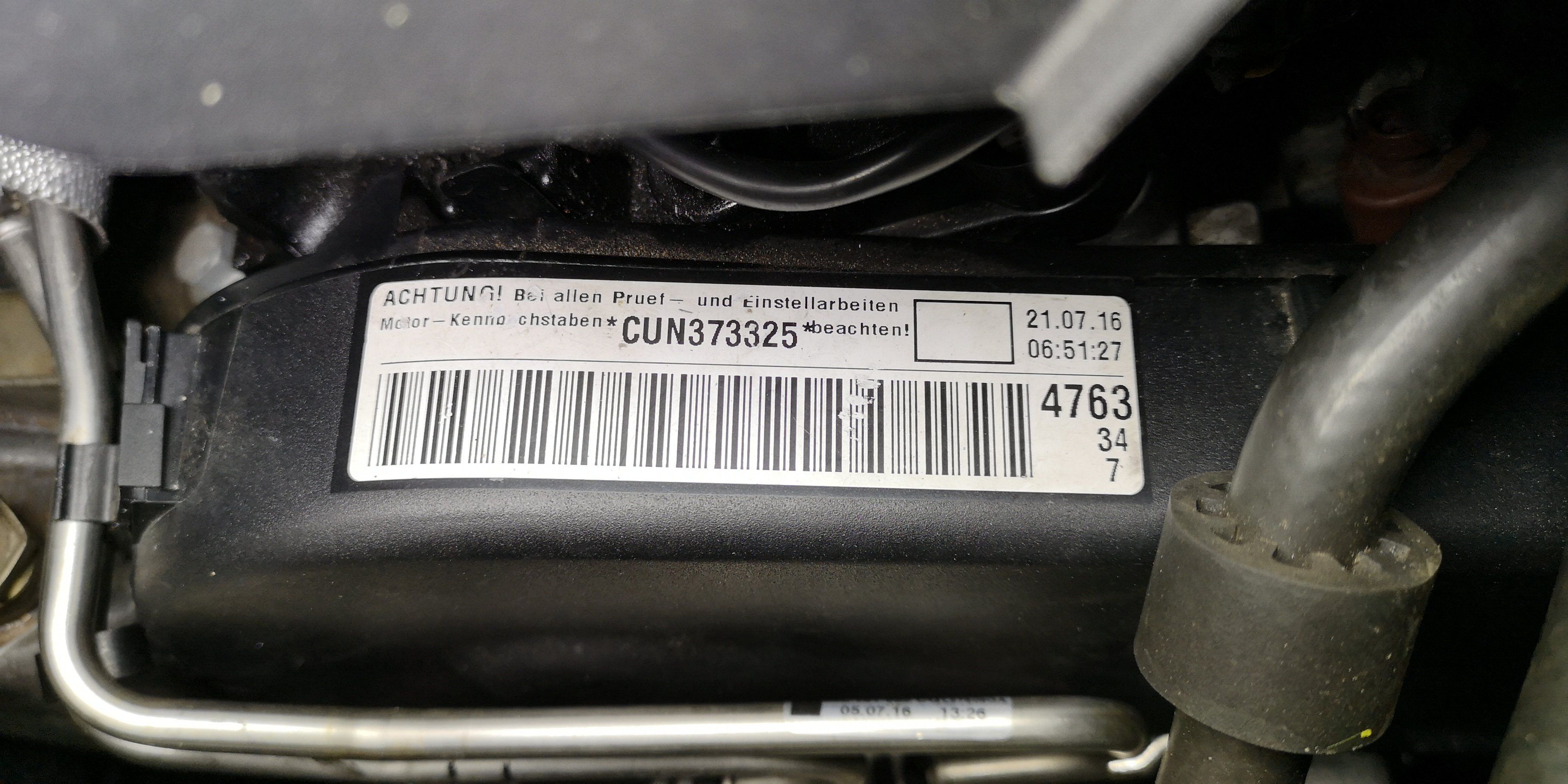

In the meantime I have been doing some research, and I highly doubt any of it is going to get me anywhere but I did find some interesting things along the way. So I went on this 'ErWin' website where I had to pay 7 euros for an hour's access to all sorts of technical documents etc. I've attached a screenshot of the website below that I thought was interesting. As you can see, in the 'Whats New' section, there is a document over on the right hand side of the screen called 'Noises from the timing belt area while idling (2044201/10)'. I've attached a PDF copy of this below (Electronic Service Information System (ERWIN - ERWIN).pdf) and on page 1 near the bottom there is a heading 'Production Change' and then it says 'Introducing an optimised tensioner pulley of the toothed belt since engine production date 03.10.2016'. So to me, this means there must have been a known problem with this tensioner for Skoda to introduce an optimised version?? So I checked the production date on my engine (see attached image below) and it is 21.07.16. So to me, this means I've got the older, problematic tensioner, before they started producing engines with the new improved one from 03.10.2016 onwards? The other thing I find interesting about this document is that it was released (or probably updated) on 31st Jan this year, so literally only a few days ago.
So some people on here were initially saying that this is a known issue so Skoda should cover it, but I find it weird that if you Google it, nothing seems to come up and there don't seem to be many people with the same issue. My dealer said it definitely wasn't a known issue and they'd never had a VRS in for this problem. Skoda UK also don't seem to be acknowledging it as a known issue, having spoken to them about it, although I didn't directly ask the question. BUT.....these documents that I've found seem to confirm that is IS a known issue? Or rather it WAS a known issue, which resulted in them having to update the design on the tensioner from 03.10.2016 onwards. I guess I don't really fully understand what I'm looking at, but it seems that way to me!
