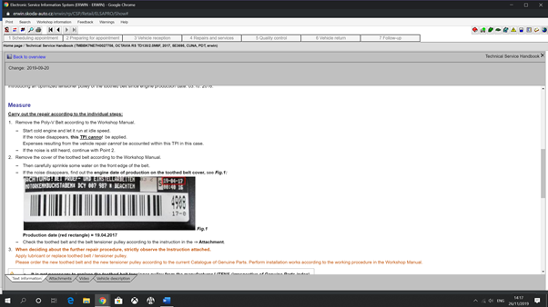

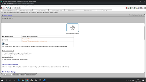

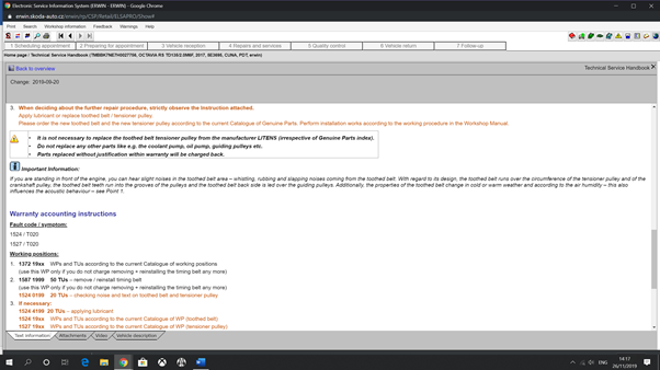

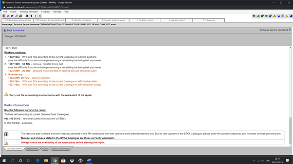

There is a a skoda letter concerning it. Had my belts changed under used car warranty I bought with the car. Hope the pictures are readable.

Settol - Thank you for taking the time to post those images, but unfortunately they are too pixelated so I cant quite read the text on them 😔 Is there any way you could upload them at a higher-res please? I would be really interested to read through them 😊👍 Thank you!

Mine was definitely louder when cold and very quiet when warm, I would question him on the letter I attached earlier in the post as it is in fact a known issue. Why else would skoda send its dealers a letter about it...?

Thanks Settol, I will definitely print out your word document and take it with me when I drop the car off 👍
