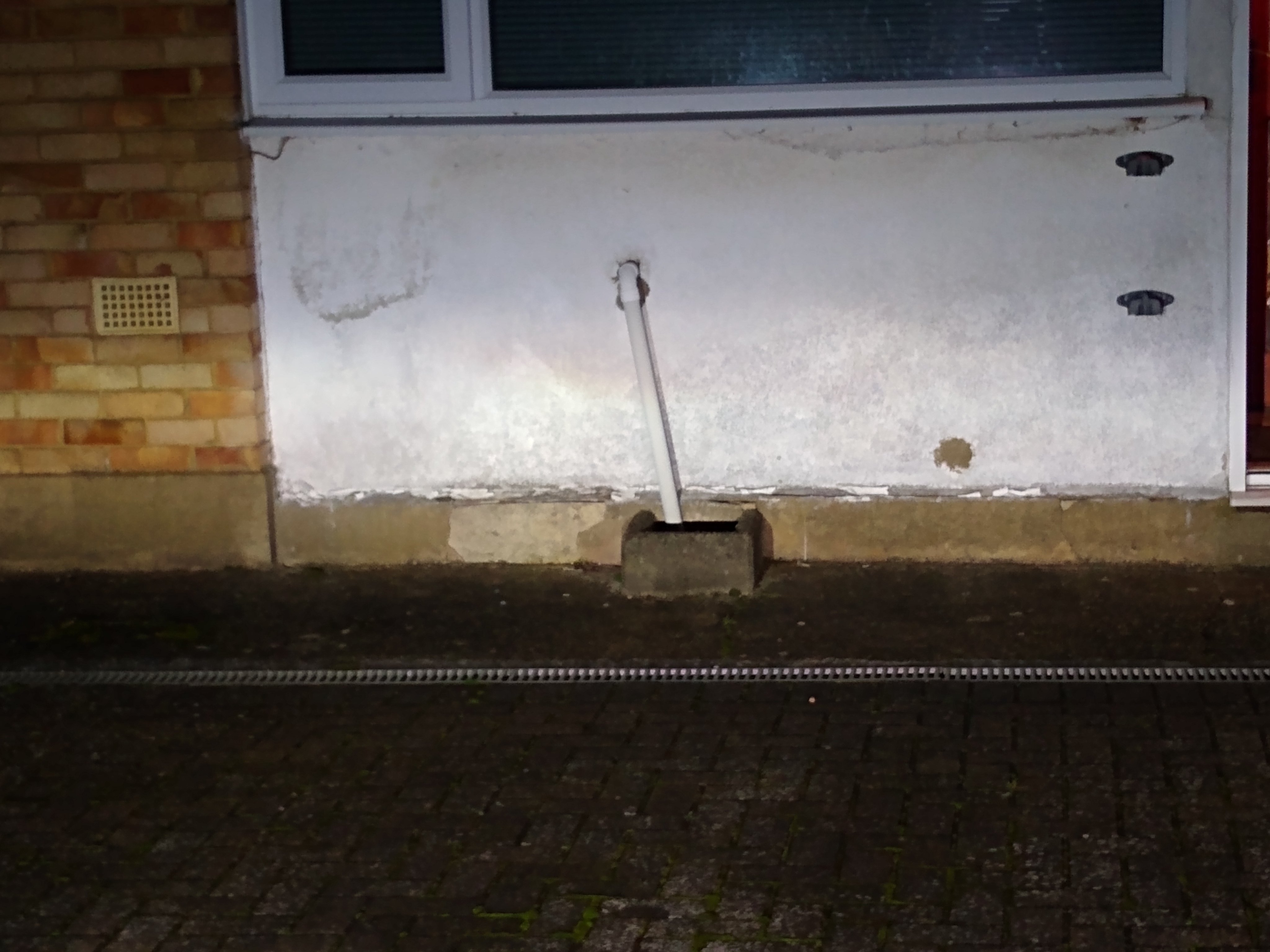

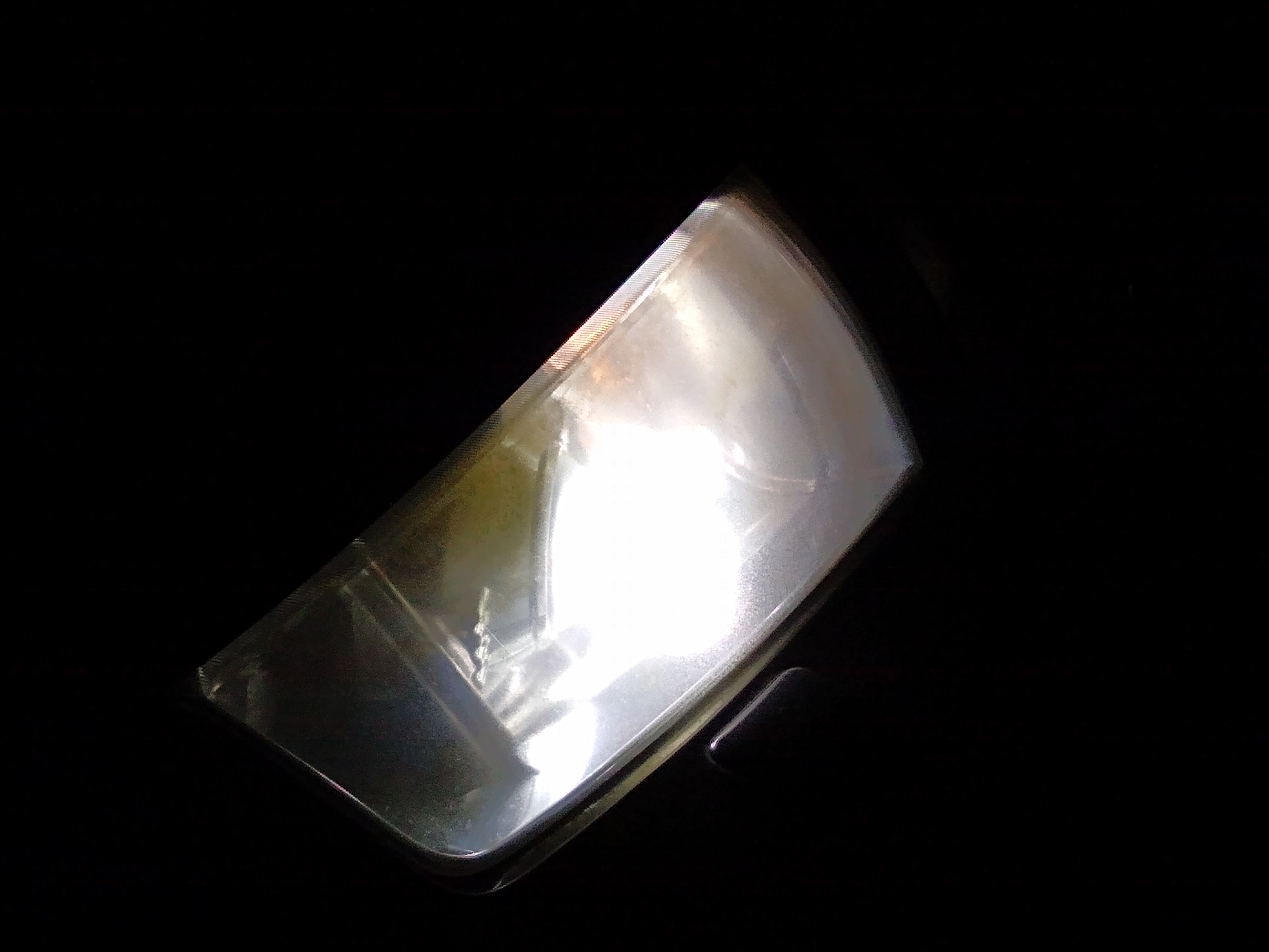

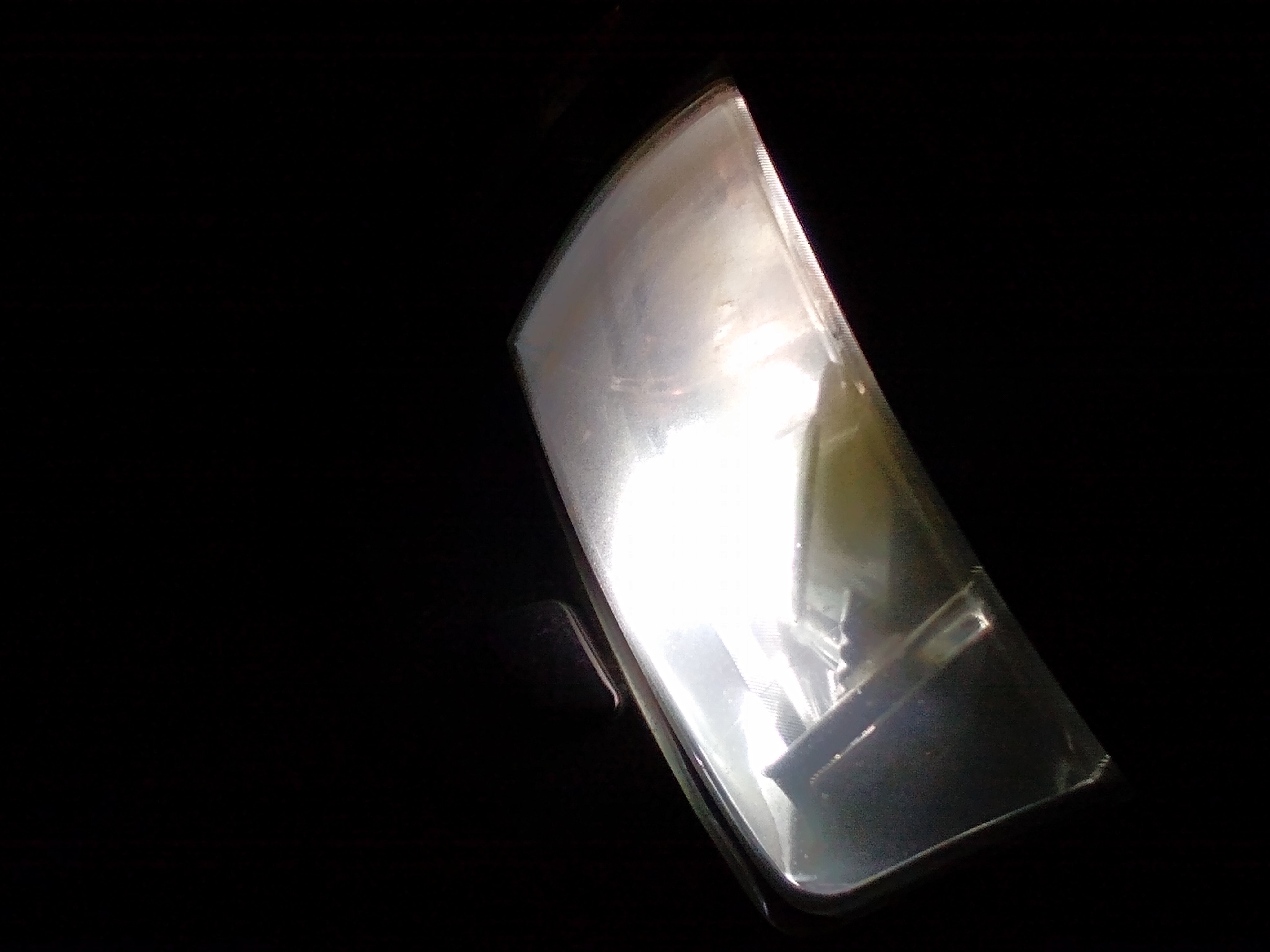

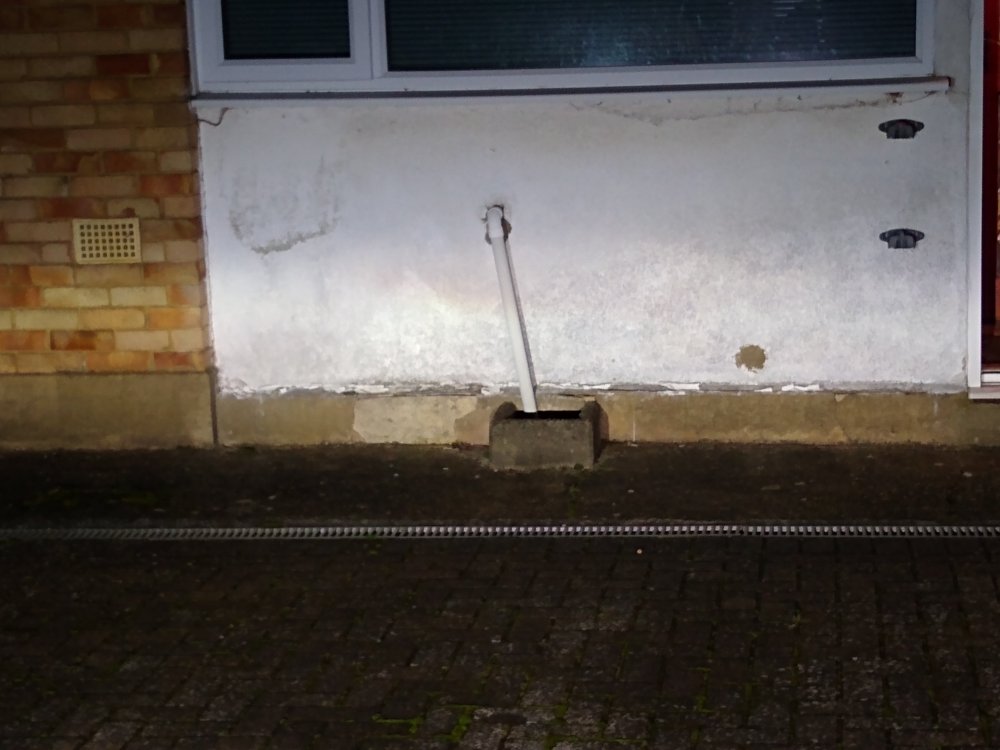

Piccies from just after dark.1344165316_2020-01-1117_15_19.thumb.jpg.f3f957bec582b19f92b5fab445aecf59.jpg733181698_2020-01-1117_15_30.thumb.jpg.e014111076ea839fb7726028fc1c4bd0.jpg
Maybe I should run i forward a bit. That's from say 20 feet away.

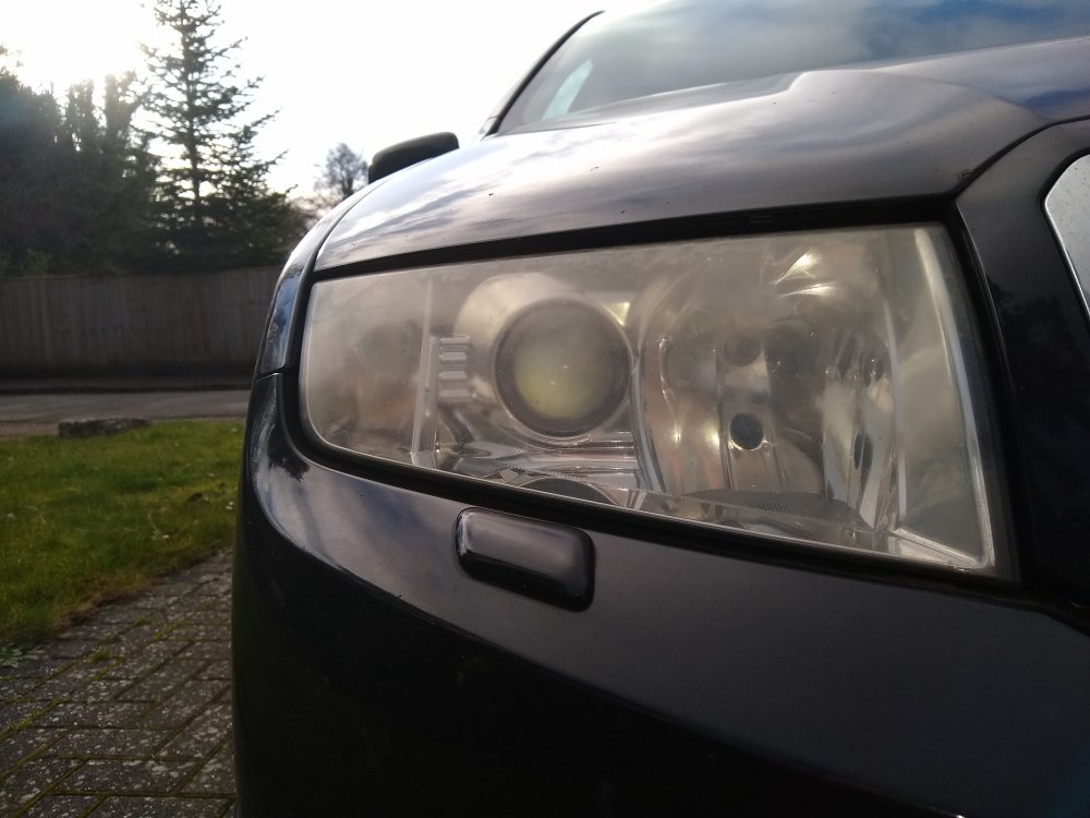

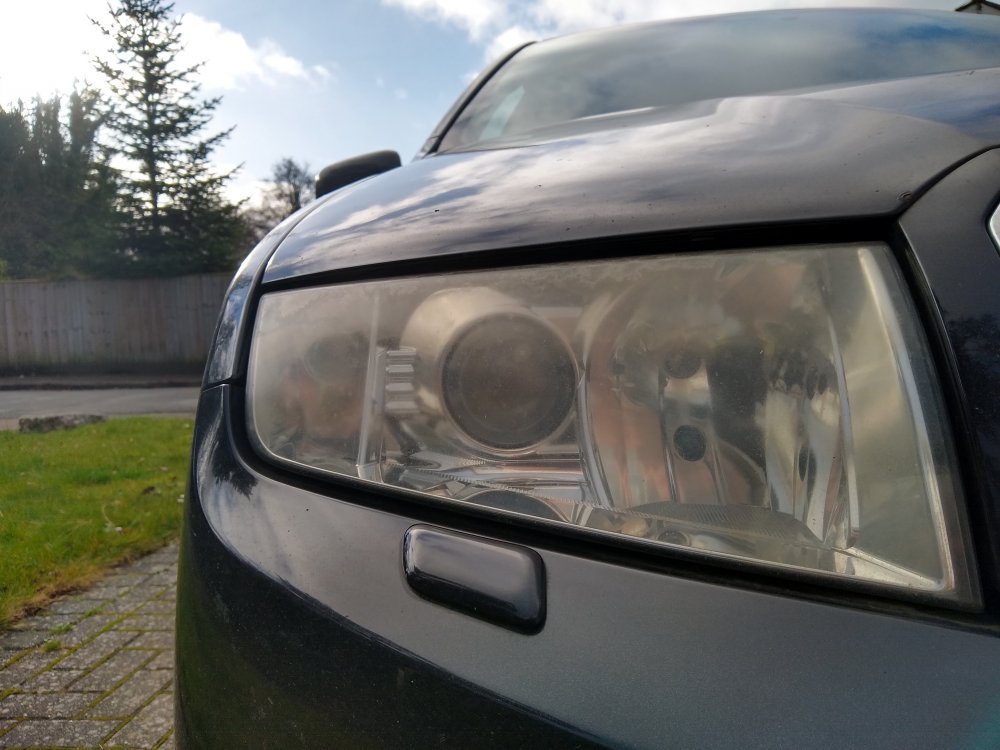

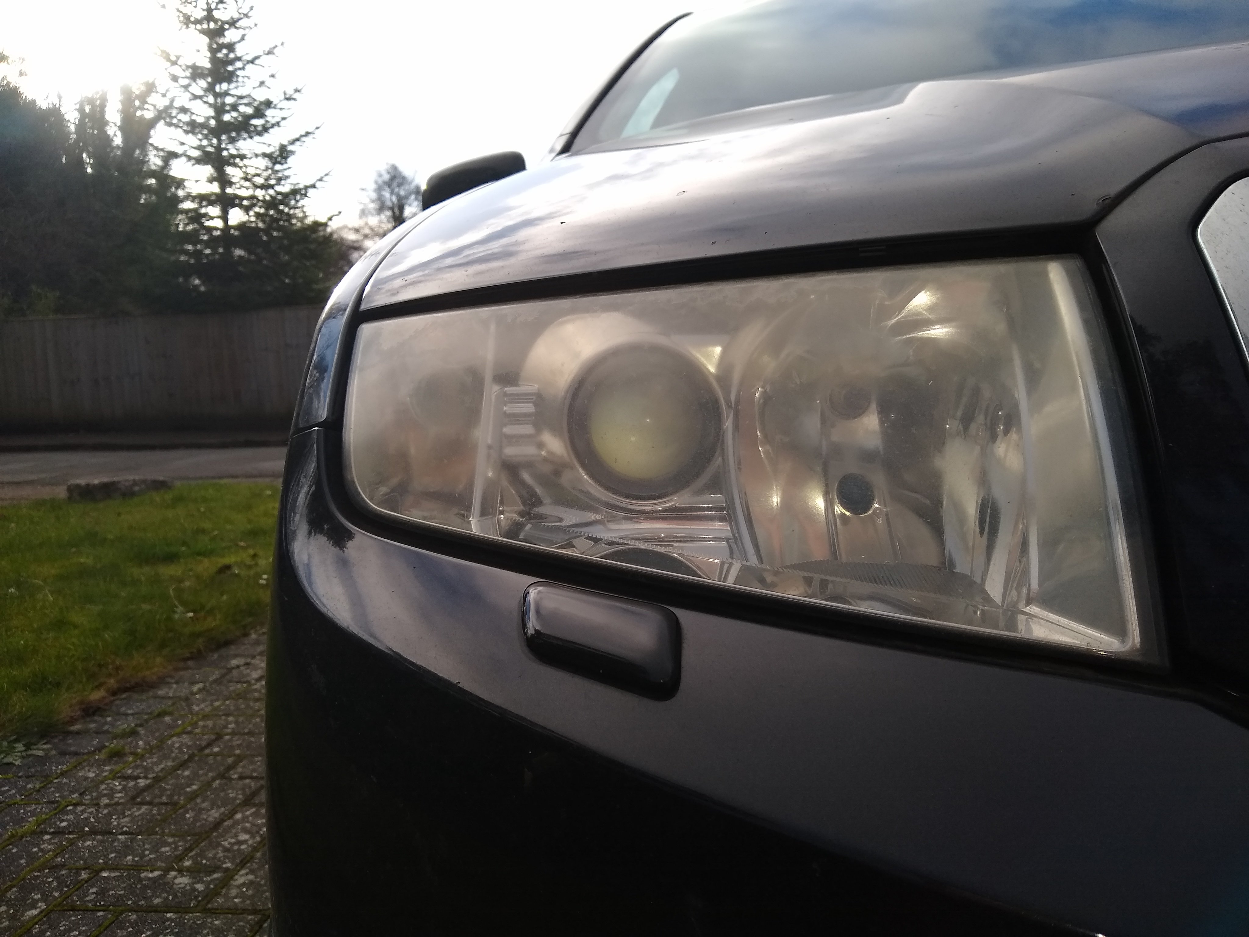

More pics from today.

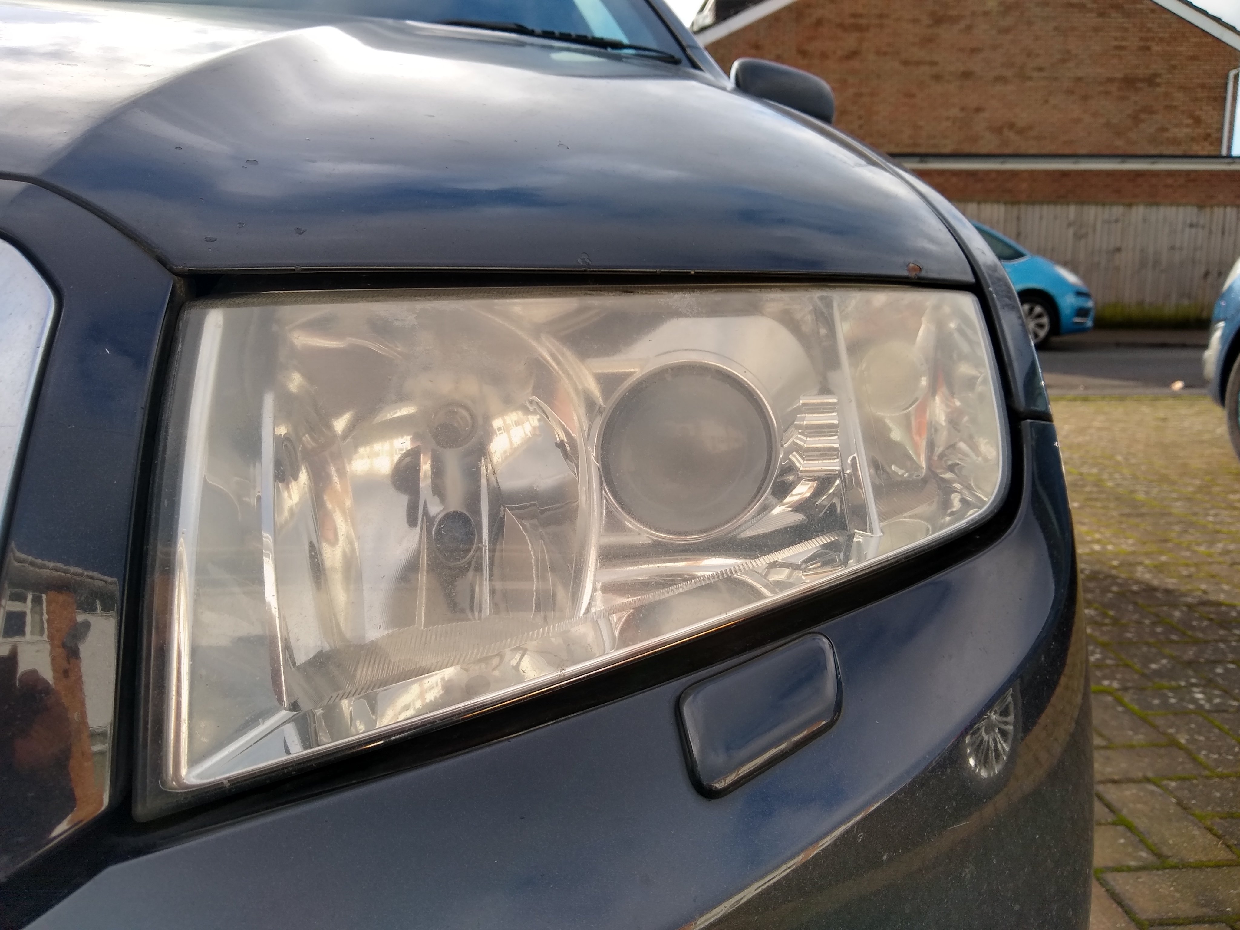

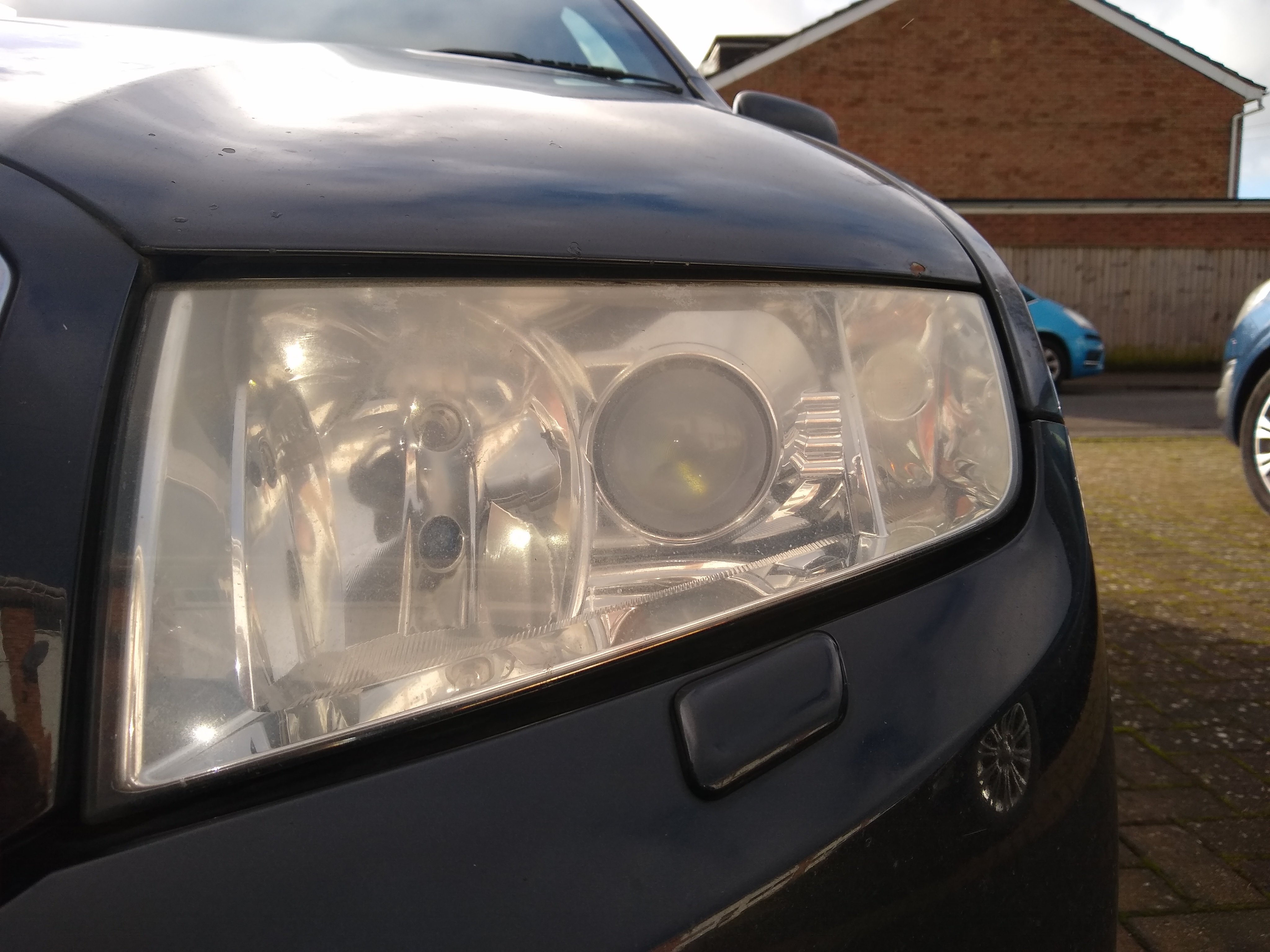

...And the passenger side.
I've switched out the driver's side D2S for a spare. See if that makes a difference.
With the age of it, its almost certain your bowls are faded. If you like DIY, you can strip the headlamps and get someone to plate the headlight bowl again, plenty of companies online do this,
Alternatively, you can change the projector itself for a replacement. In terms of choice? You have a huuuuge range to choose from. eBay springs to mind, a popular one is also https://www.theretrofitsource.com/ - they are amazing, and sell a wide range of quality replacements and not cheap ebay tat
It would be an oppurunity to change for a nicer projector, with something like squirrel finders and just better outptu and hotspot in general.
It doesn't have to be expensive - I changed my halogen Fabia vRS to projectors (£25) and HIDs (£75 from autobeam) - just be prepared to fiddle with a screwdriver and some tools hehe.
