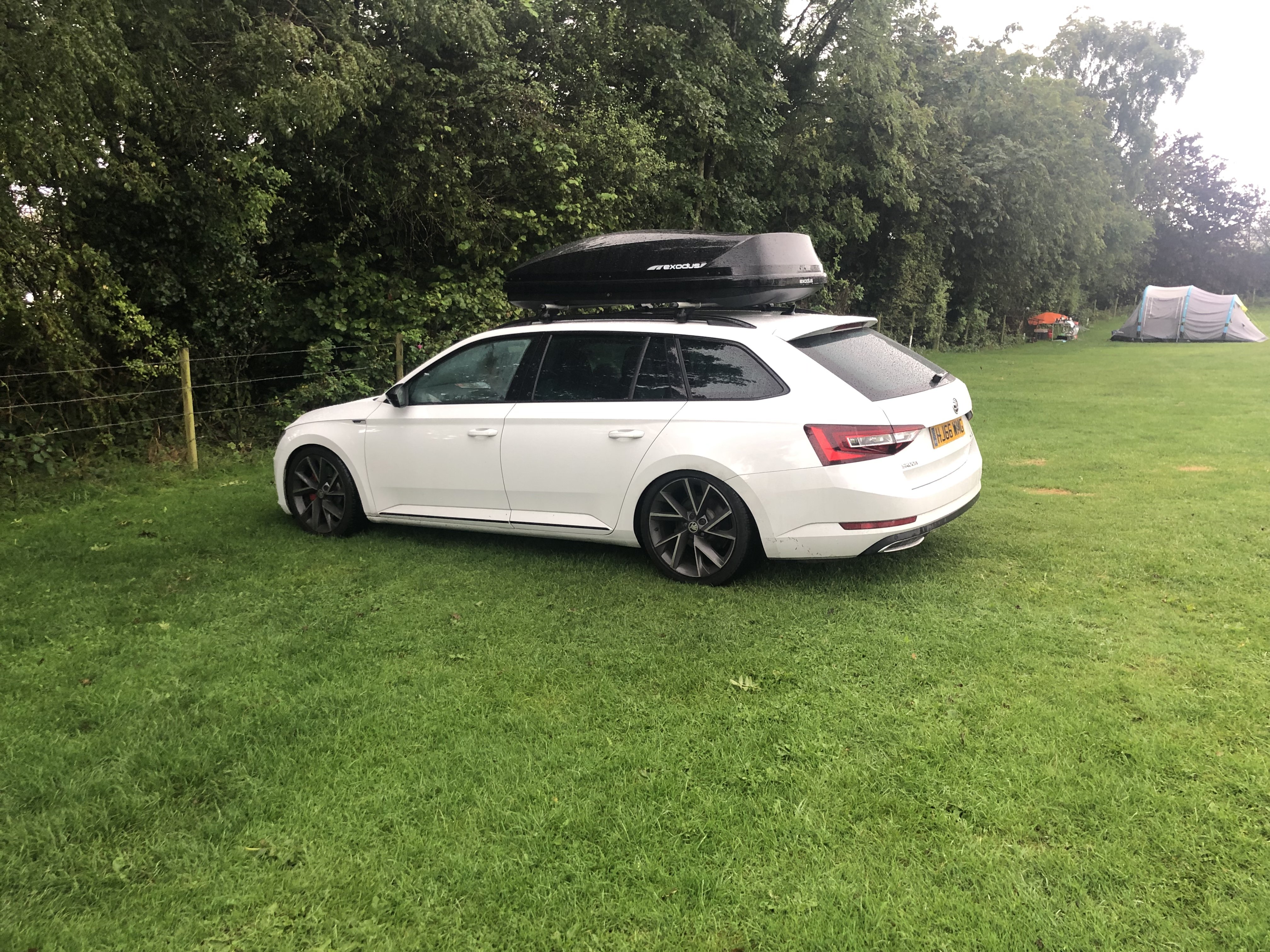

this is mine on the H&R.
3 minutes ago, Esseesse200 said:
I’m on H&R on a sportline estate and it’s made a massive difference. At some point I will go to koni special shocks which is what they used to call fsd (frequency selective damping) had them in a couple of cars and they are very good. Fiat fit them as standard to their 595 Abarth And punto esseesse (used to have one) and the Fiat 500x cross plus (wife has one)
That is just H&R springs or springs and also dampers? I don’t want to modify ride height, I think that just dampers would do the job... I must say it looks awesome!
This is on lowering springs with standard dampers at the moment.

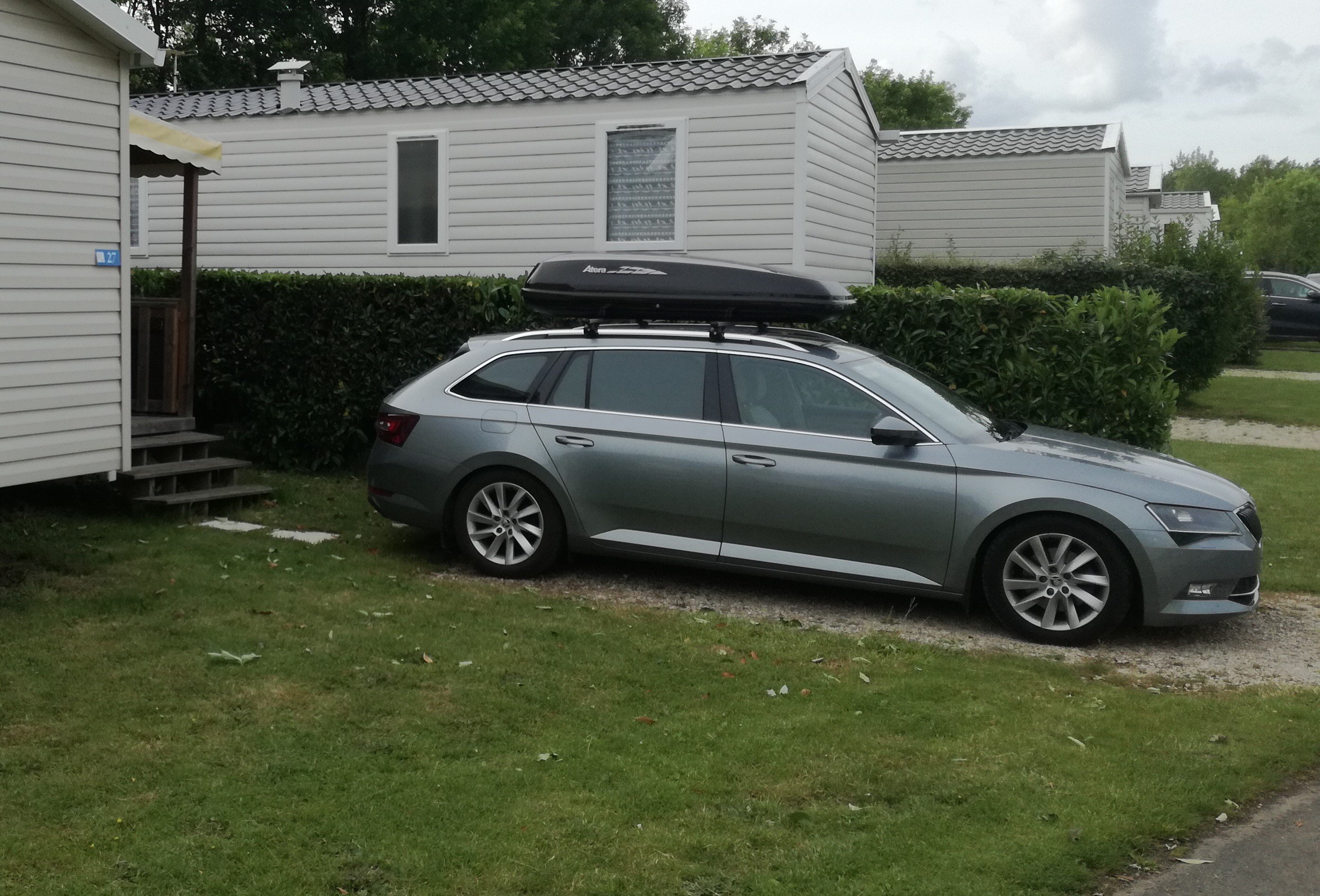

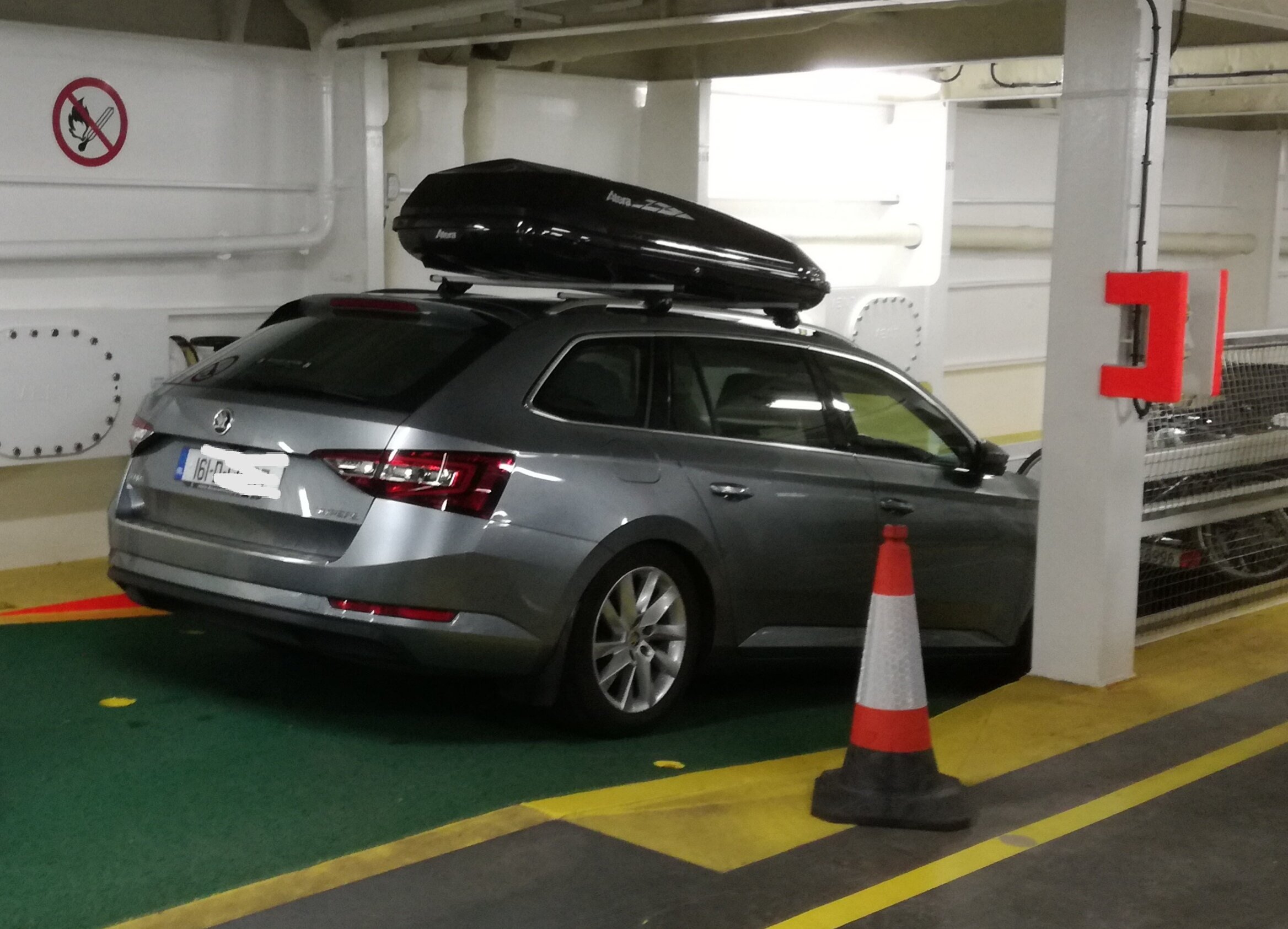

I fitted the springs a couple of days before heading to France last summer and though that would be the best test of how practical it was given that I would have to navigate ferry ramps etc. A family of 5 on board with roofbox and no issues whatsoever.  The overall drop was approx 30mm but I'm driving a Style model so not sportline.
My only issue is that the dampers still allow the car to bounce too much. You need to go slowly over ramps otherwise the car will rebound and bang due to the shorter spring travel whereas before it would have bounced 2 or 3 times!
I think a better/firmer damper could solve this which would leave me with a nicely sorted car.  The springs make a huge difference to handling so I wouldn't go back to the standard setup, and the car is also easier to wash😁

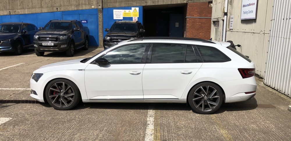

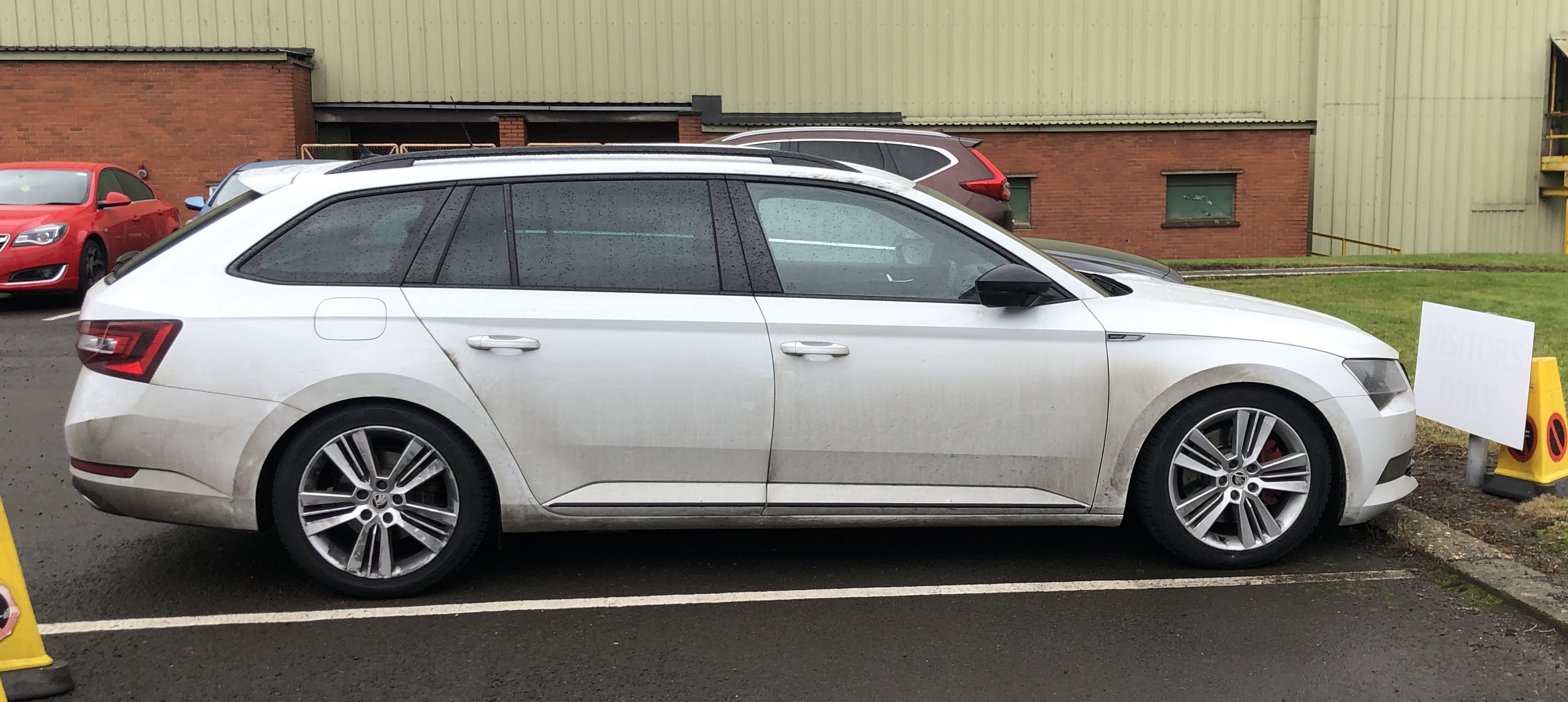

A few pics to give you an idea.  I'm on 17" wheels as you can see.

That’s settled quite nice mark. 😉

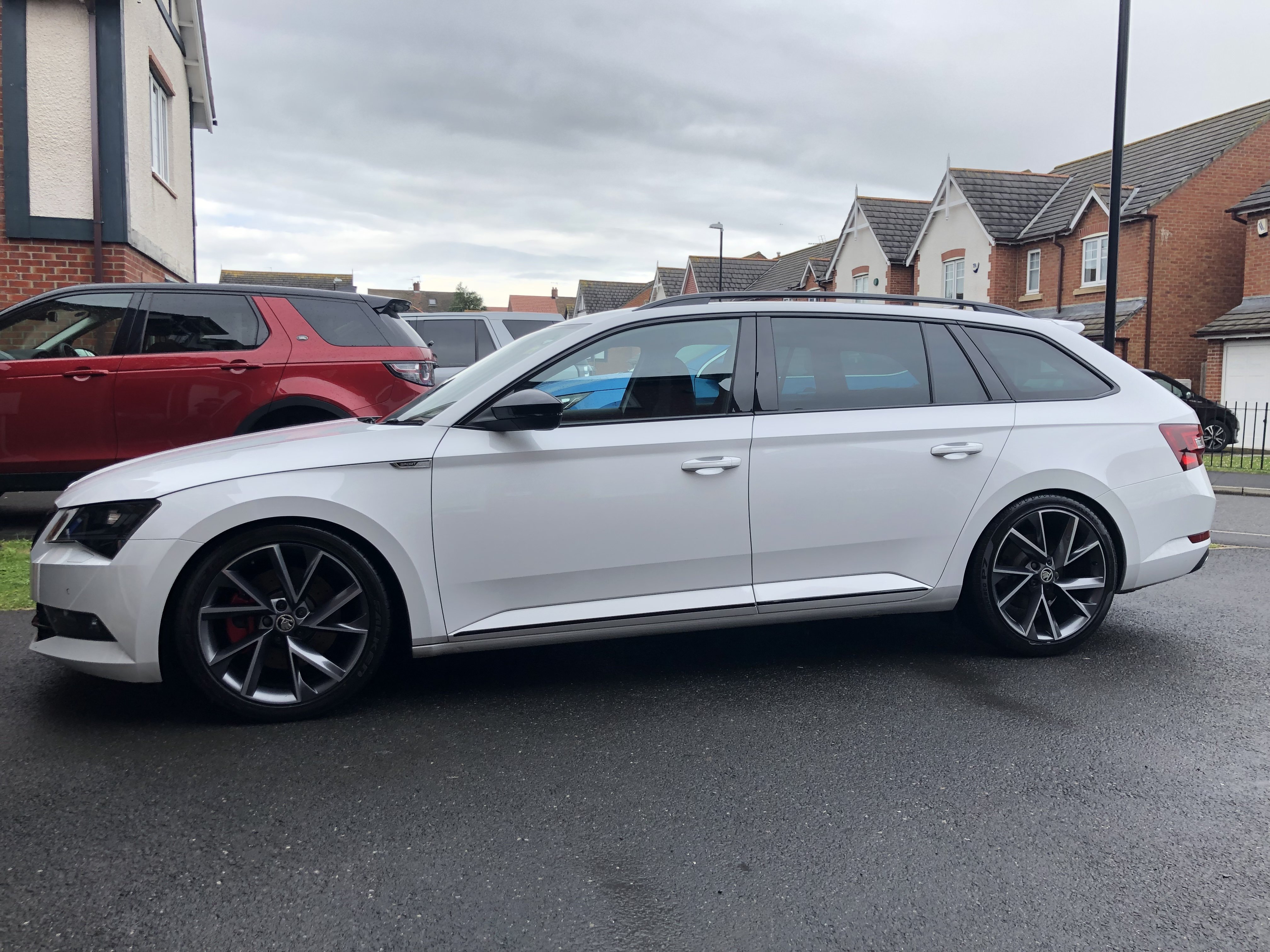

where are you bard mate. If you are anywhere near the north east You are welcome to try mine out
I love how it sits.
