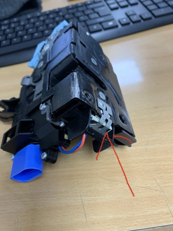

Either way the entire lock assembly has to come out of car, I had the same problem as you last year, I bought the whole assembly for around £25 off ebay.
The micro switch on my old lock had worn down to the point it wasn't making contact.
Micro switch from dealer probably cost more than the whole lock assembly from ebay.
Decision is yours.
I would do either soon though as next stage is the alarm will start going off at random times because the car thinks the door is open after being locked.
Arrow pointing to micro switch.
