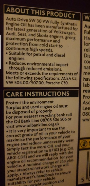

I have some vw 5/30 505.00 507,00 oil left from my fabia is this oil recommended? So much conflicting information
Thanks
VW 504 / 507 so 5w 30 FS III (Long life for Variable / flexible servicing)  TSI / TDI and it must be VW 507 for the TDI Fixed or Variable.
TSI's can be VW502 for Fixed Service Intervals. 5w 40 FS. (not long life.)
Note it doesn’t actually say it is VW504/ 507 approved.
So would you not use it ?
What oil would you recommend (make ) she dose about 10k a year and I will change it twice a year
For a vehicle of that age it will probably be fine. I was just pointing out that oil is not actually VW approved. Which would only really be a problem if used in a car that’s still under warranty and some engine defect occurred.
I would use what oil you have and i would change it at 10,000 miles or annually.
When you need more oil i would go to ASDA or anyplace and buy what they sell, as if Meets & Exceeds or is Approved you know it was produced by an Oil Producer
and as it is Castrol Approved was not the saviour of engines, and out of Warranty VW group could not care about the lemons they built.
It's the back of that tub that my picture is from ! Iv used it last 3 services on my 1.9 fabia

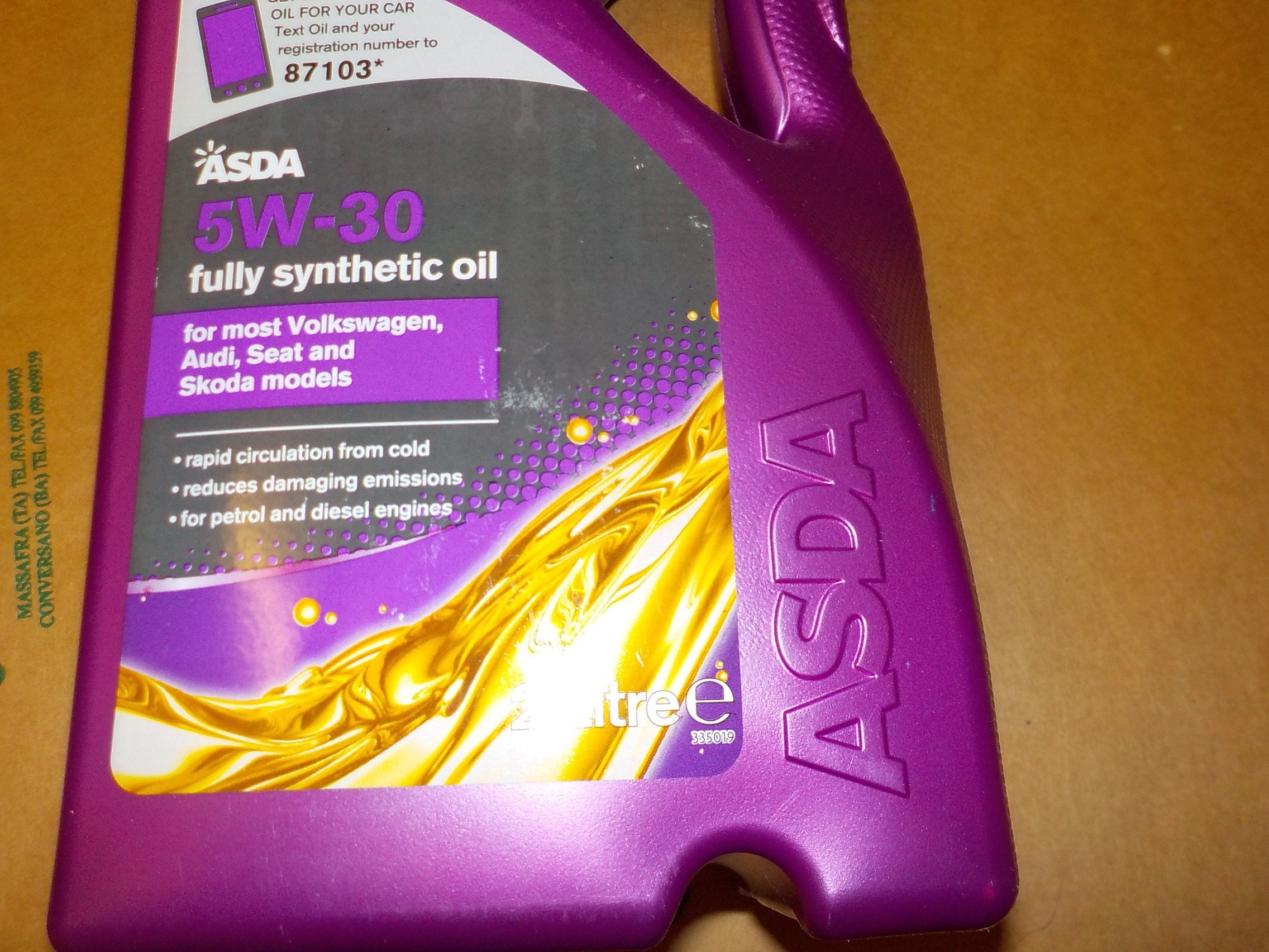

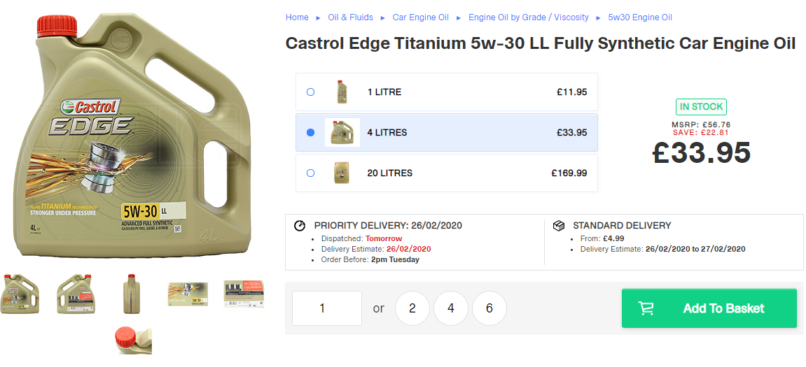

£19 for ASDA oil that meets the VW 507.00 specification, but isn't approved...
I'd be happy using it, but for £6 more you can get fully approved oil, the same oil the Skoda main dealers use.
Delivered to your door from JCT600 Volkswagen in Newark...
Not approved but exceeds the spec.

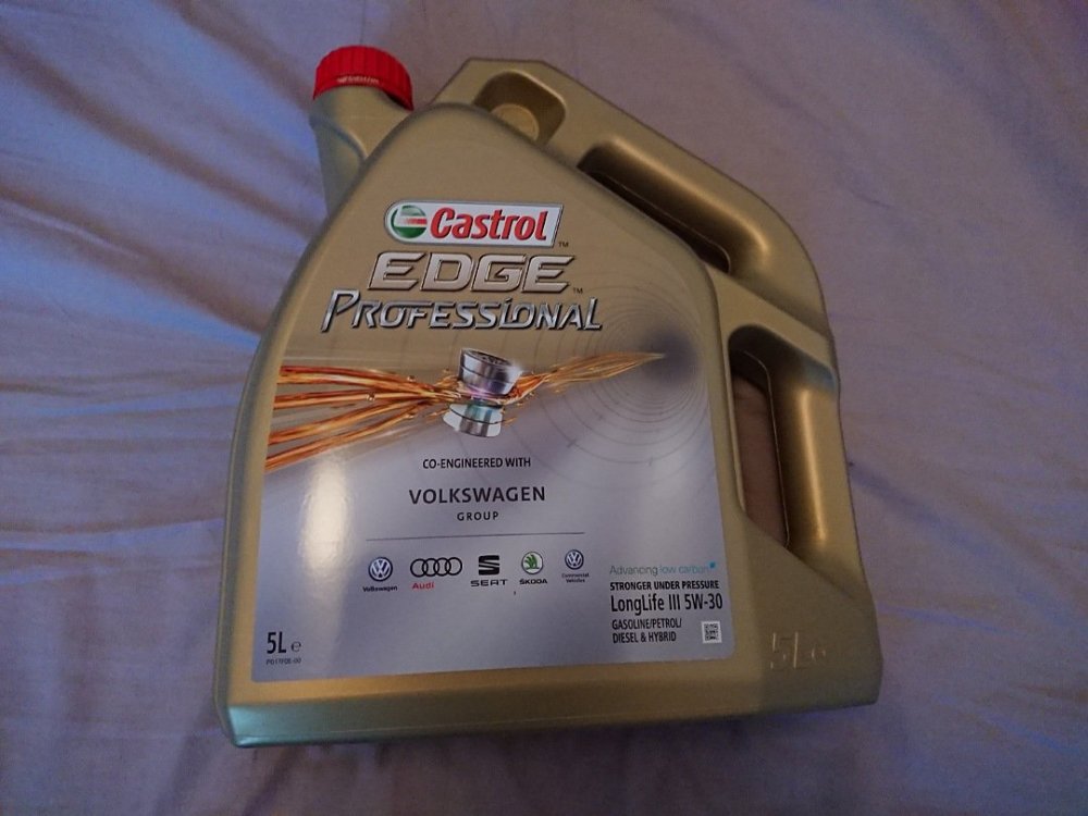

I would bet £100 that if Asda oil was to gub a VW engine you would have more chance of compensation from Asda than you ever get with a FMDSH and the car only ever having had Castrol or Quantum used.
It wouldn't be ASDA telling you where to take your broken car, they'd pass you on to their supplier of the oil.
It would then be the supplier who would insist on a cost prohibitive independent assessment of the engine.
The likelihood of the oil manufacturer / supplier contributing to the cost of a failed engine shouldn't influence your choice of oil, it'll have zero benefit in the unlikely event it could be proven the oil was at fault.
You are right in the real world you would get nowhere.
Like most get with VW Group.    The Castrol really is nothing special and neither is the Quantum.  If you really care about your engine using that is doing no special favours.
The honest truth is like many things VW recommend that are consumables it is just for their gain as they have financial interests.
The manufacturers with more reliable engines recommend whoever they choose and are in business with.
£19 to £25 is pretty good going for 5 litres of oil.
It's those that spend £39 delivered for only 4 litres for the branded stuff that I can't quite fathom...

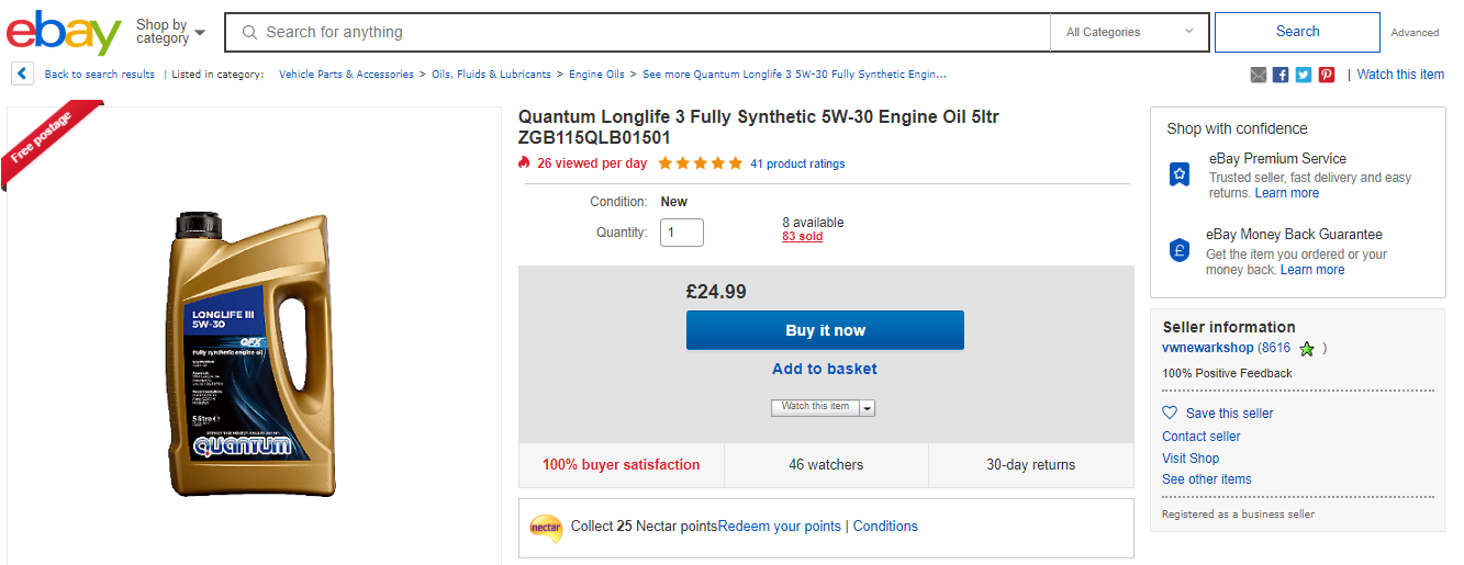

This stuff comes out at £28 delivered.
IMG_03032020_113150_(1080_x_810_pixel).thumb.jpg.c44e73f2b51d8594a55d080aebf7f437.jpg
From where ?
Google / Ebay / Amazon are where you might find good prices.
Buyer beware of Oil and consumables and parts online.  Use trusted traders because there is hooky stuff about and hooky 'Branded Oils' have been a favourite
of con merchants.
Not even been produced only abroad / overseas from the UK.  It happens in the UK as well.
You might not know that oil is snide as the containers look right, it might be a Low Oil Pressure warning that gives the first clue you get.
