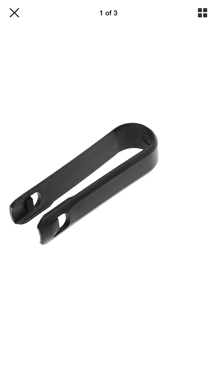

My nearside front tyre is looking close to the legal limit, so I wanted to change it with what appears to be a brand new spare. However, I can't get the wheel off! There may be different types of wheel trim, etc, so I'll describe mine in detail. The wheel trim appears to be held on by the five wheel nuts which have plastic covers. I've got two of these off with the little metal hook in the tool kit, but I can't remove the others. I don't want to employ 'strong-arm' tactics on them in case I'm doing things wrong and I might cause some damage. In the Haynes Manual there seems to be an oval plastic sort of tool which it says is for removing the wheel trim - problem is there isn't one of these in my kit. Any advice anyone?
Ah, so I do need one of those - there doesn't appear to be one in my toolkit. I'll order one - there isn't a great urgency for what I want to do so Ebay will be fine.

Tool I had was wrong one for plastic caps I had, few were missing so got a complete new set with correct puller for £15

Thanks, I've ordered a couple of those - might take a while to get here though!

To get the wheel nut trims off, you can use simple pliers. Your order from "outside the UK" - China - will probably take 6 weeks.

Yes a few days ago but I could not remember what thread to update 😞
They are longer and look more substantial than the OE VAG one.
