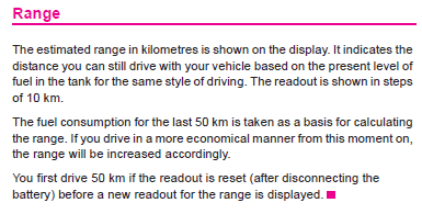

Hi all😀. My battery went flat today so had to call road assistance for jump starting my skoda octavia 2008 model.
after starting up my mileage meter was reset and im now unable to see remaining mileage on it. Apart of it everything else working fine. Any idea how can i have it back 😊

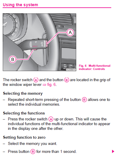

Use the buttons on the end of the windscreen wiper stalk to scroll through the different display options, until you get back to the 'range' display...
Wow this sees a realistic approach. I was wondering before why these buttons are used for. I really appreciate your support 😊 will try this out
Thanks mate. Your told procedure worked exactly as you said. I Got my remaining mileage readings back. So glad i found this community☺️
