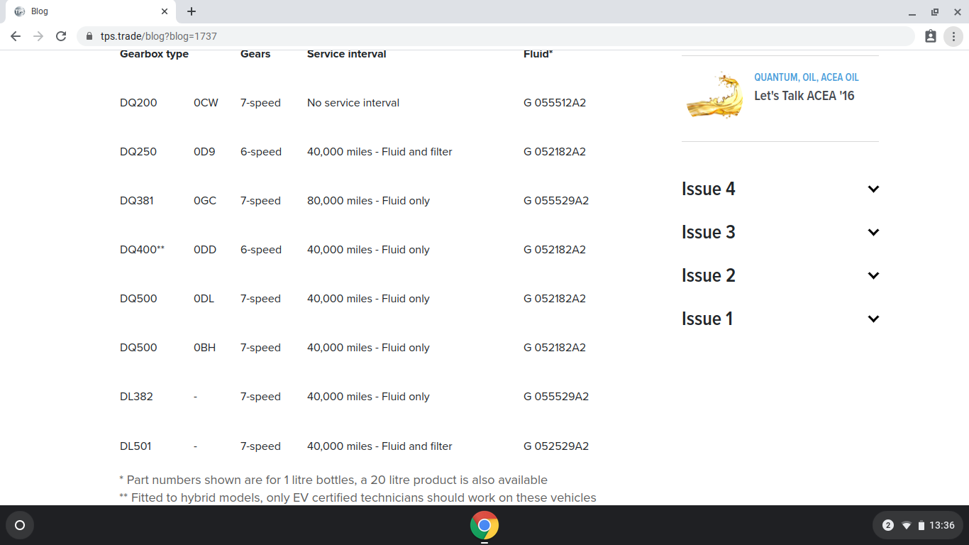

how do I know which version of the 7 speed box I have ?
Im not getting many answers from the octavia section
You do not.
Someone here will be able to tell you which 6 speed DSG it has.
