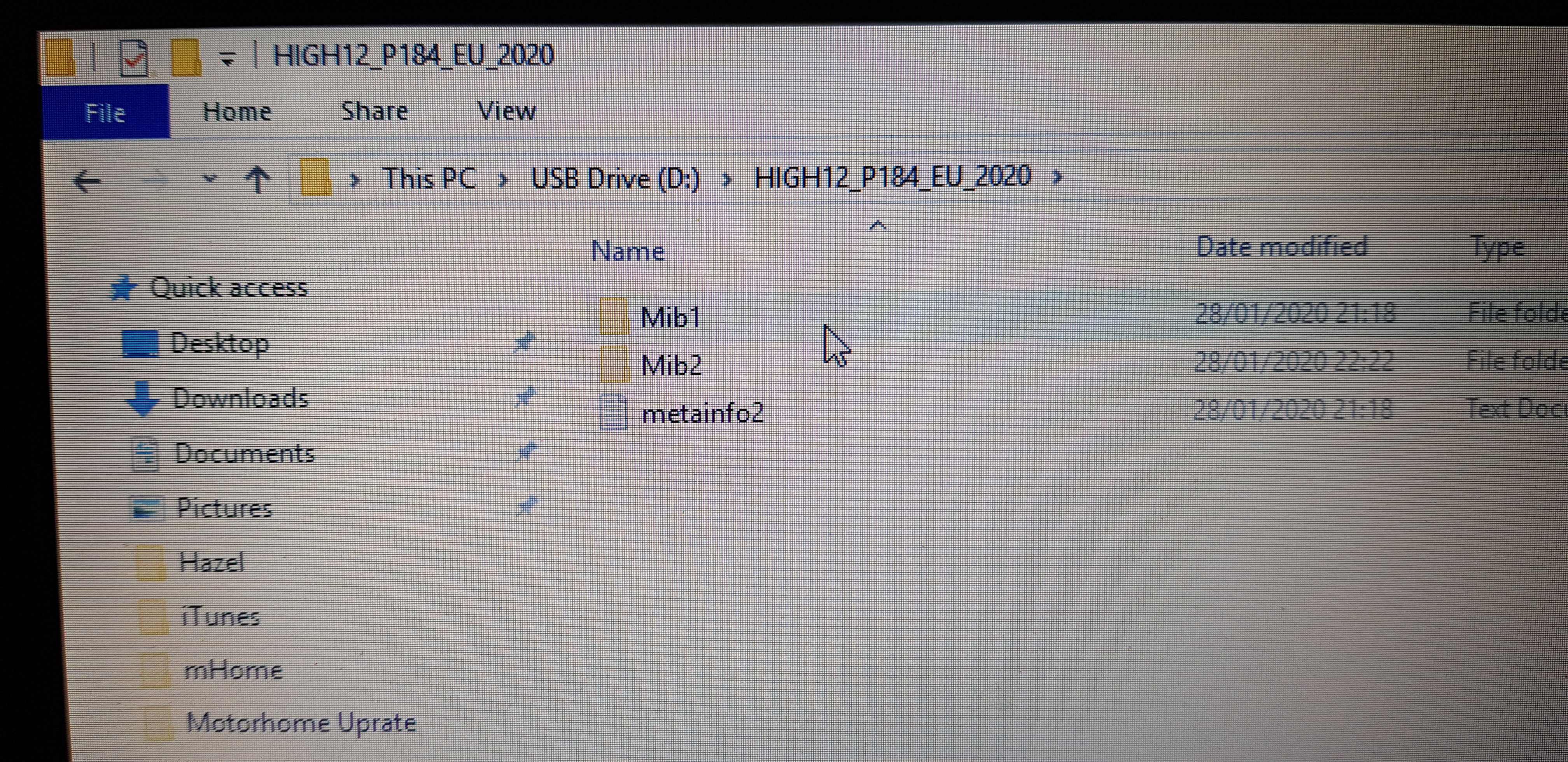

Not sure what the problem is then but does you card look like this?
I'll check.
Thanks
Looks like this..
Any advice appreciated

Hi,
took me a bit of looking until I noticed that you have the files in a sub-directory. The files need to be in the root of the USB, yours are in a sub-directory called HIGH12_P184_EU_2020 if you do a cut and copy on the files i the sub-directory to the root then delete the sub-directory then try in the car all should be good. If this does not make sense send me a PM and I will give you my number and I will talk you through it 🙂
John
Awesome it's now updating.
Thanks a lot 😀
