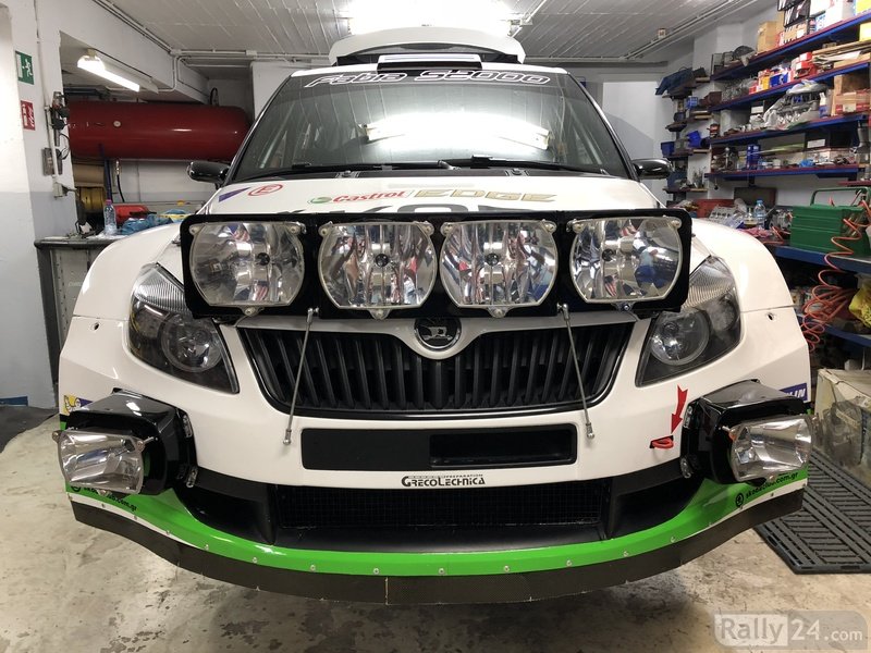

15 hours ago, AMD87 said:
Upgrade you need
So much weight on the front shocks, you'l be looking at the floor 2 metres in front of you! 😁
Not helpful Ken... Really? The earlier post was meant to be a tongue in cheek response to the post, which was clearly appreciated by a few others for its humourous dig at Skoda's poor light application. My reply, clearly a fun post, (Hence the emoji), was laughing at the extreme lighting added to a rally car, which would overwhelm the front end of a normal version...
The lights aren’t that heavy plus the rally bonnet is lighter anyway....
Well, aside from confusing the functions of springs and dampers, what did your post gain by quoting the picture?
What did the picture add to start with? if it was a comic reply, great but if serious, then you should be having a dig at that! Clearly, to anyone reading, BOTH the post and my quote were light hearted. Perhaps you have had a humour bypass. This forum caters for help need AND a little bit of humour so lets now all shake hands and be nice!

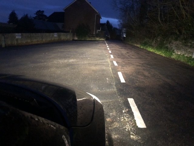

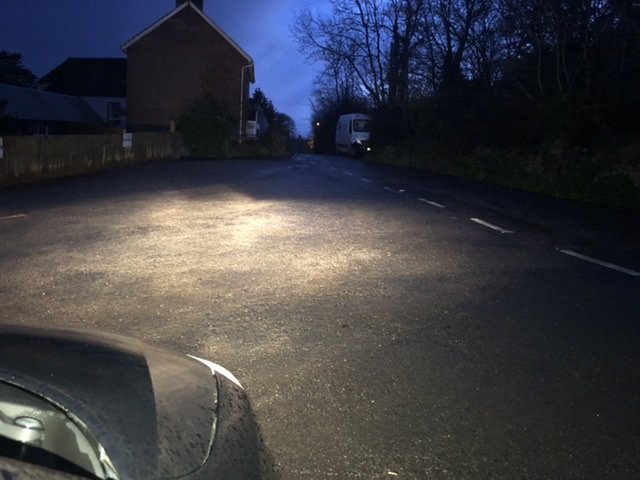

The guys at ECP had sold my Philips bulbs to another customer despite me reserving them, they gave me osram night breakers lasers instead.
i have  attached a before and after of the bulbs. Taken at almost the same place at almost the same time, if I get a minute I’ll take a comparison of the roomster oem bulbs against the fabia osram night breakers
